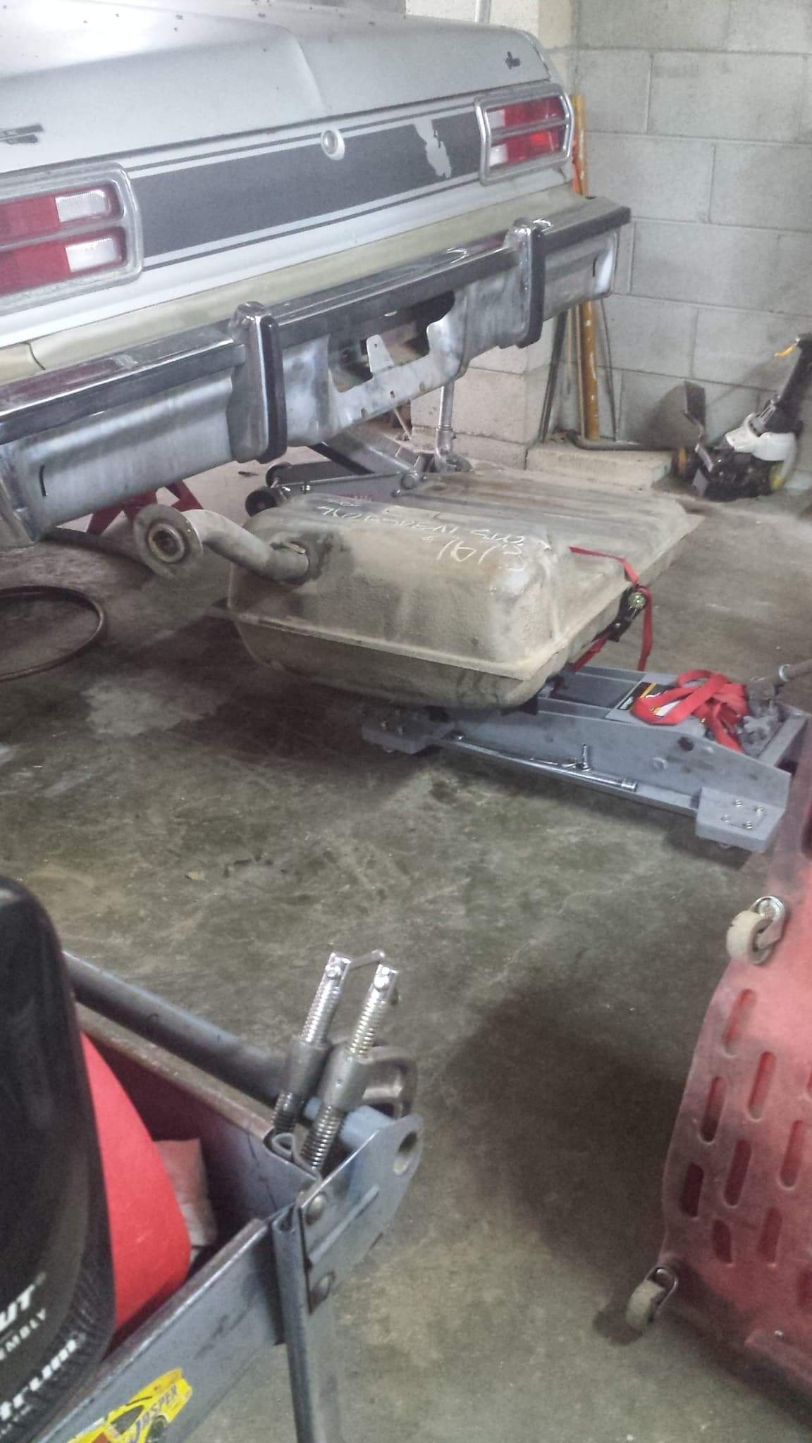

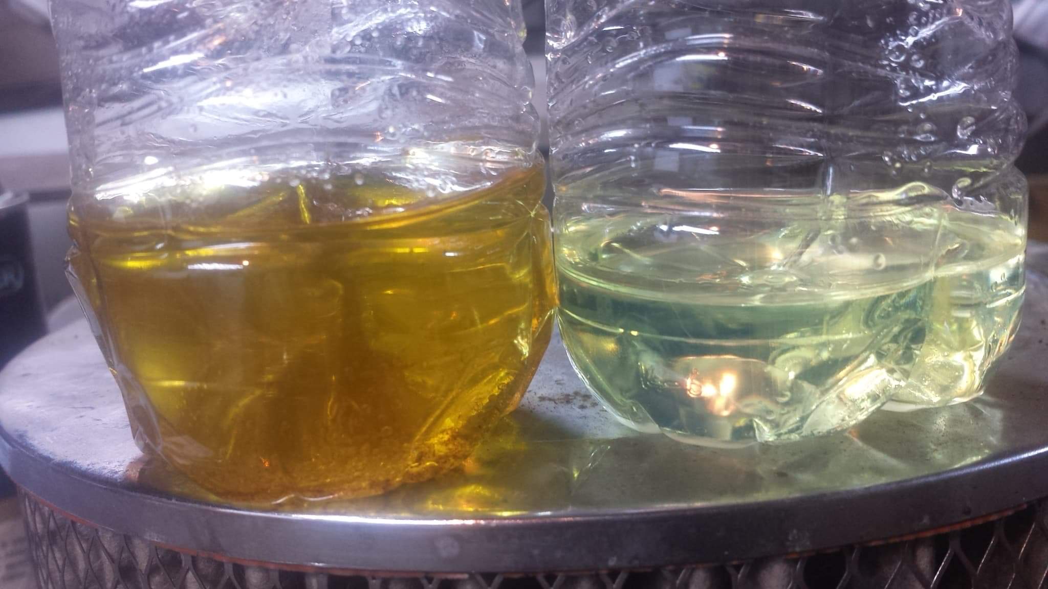

Well, the fresh gas work for a little while, unfortunately it cleaned all the varnish out of the gas tank. After but in the car run a few times put it outside to get another car in my garage to work on next day I went to pull the road runner back in the garage and noticed it was started running really bad, then really really bad, then really really really bad. So I checked the headers and the Left Bank number one pipe was really warm and the other three will cold, went to the right Bank and all four pipes for normal temperature oh, really hot....

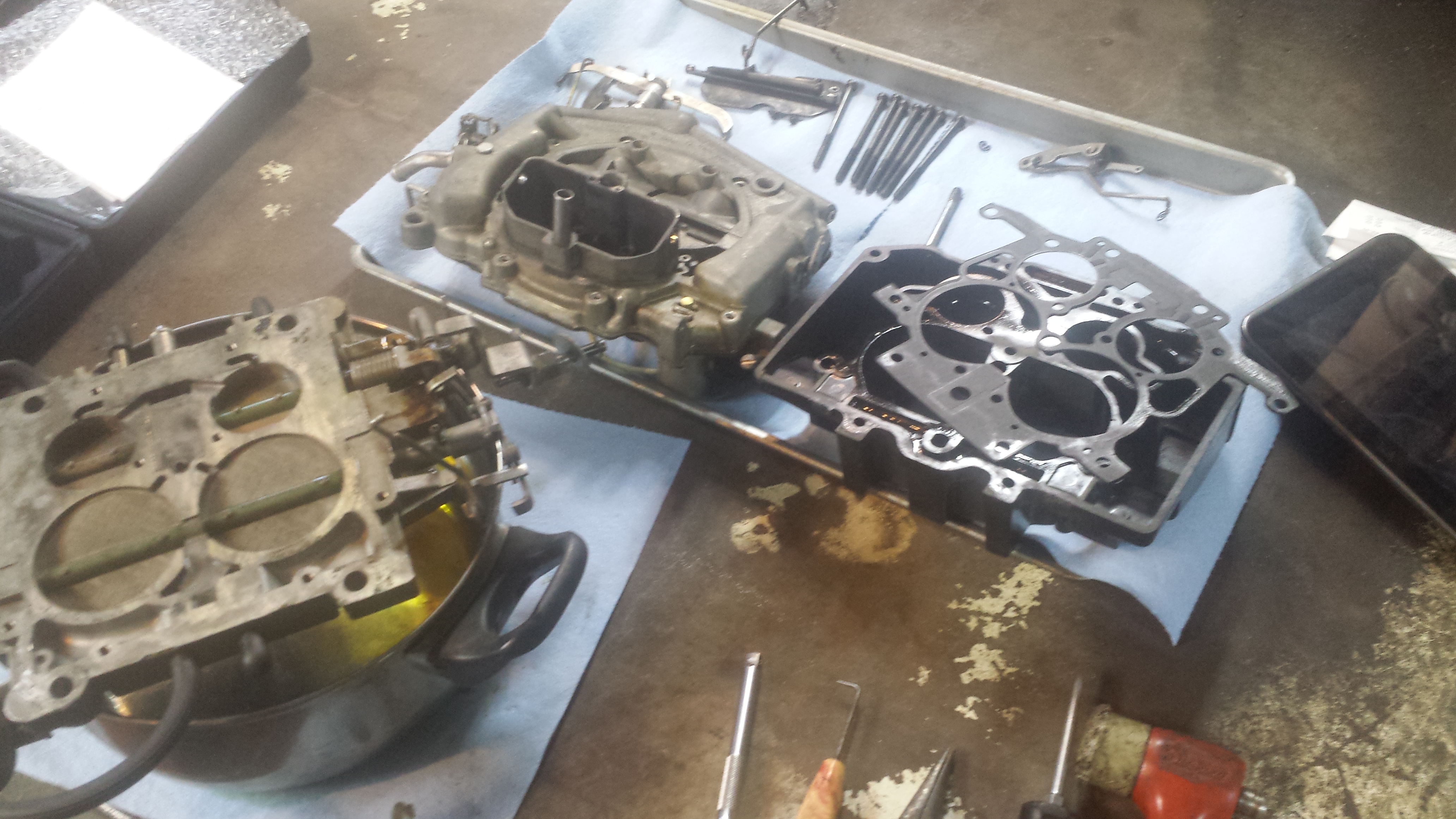

So I look down the throat of the carburetor and only have fuel coming out of one side, so I got to pull the carburetor and the gas tank and clean them both as well as flush out all the fuel line.....
The first picture is the same gas out of the same can oh, the one that ran through the gas tank and that's the amount of varnish it picked up, yes brand new gas
I'm still having a little trouble with the carburetor, not sure I'm getting the right kit LOL

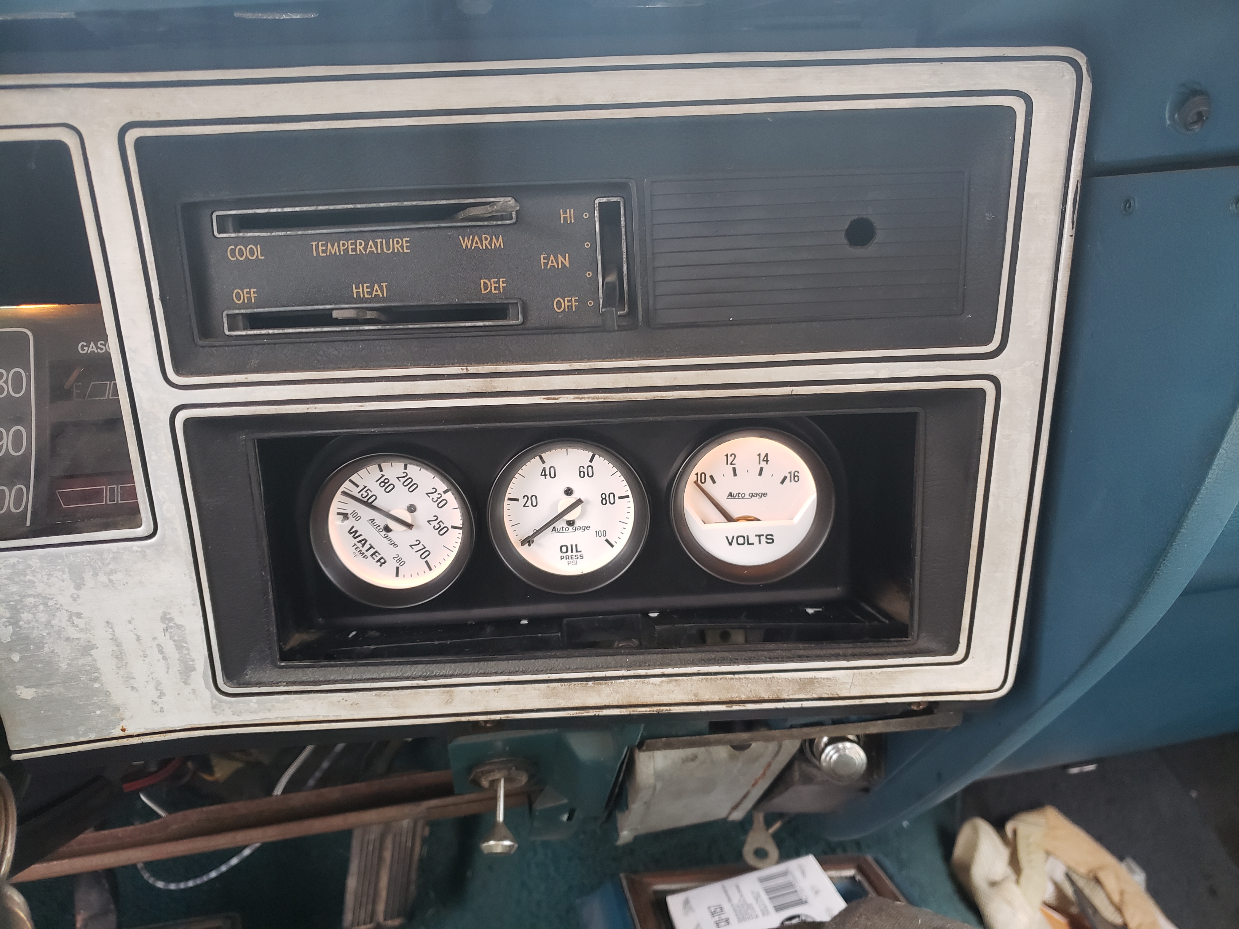

But now I'm fighting and overcharging issue it is kicking my butt......
Unfortunately that’s our ethanol. Can you find ethanol free gasoline? That’s all I run in my Duster wife’s Volare.
The first picture is the same gas out of the same can oh, the one that ran through the gas tank and that's the amount of varnish it picked up, yes brand new gasView attachment 36845 View attachment 36846 View attachment 36847
Those are great carbs but can be finicky.

By the way I'm still fighting with the carburetor I've got it off again

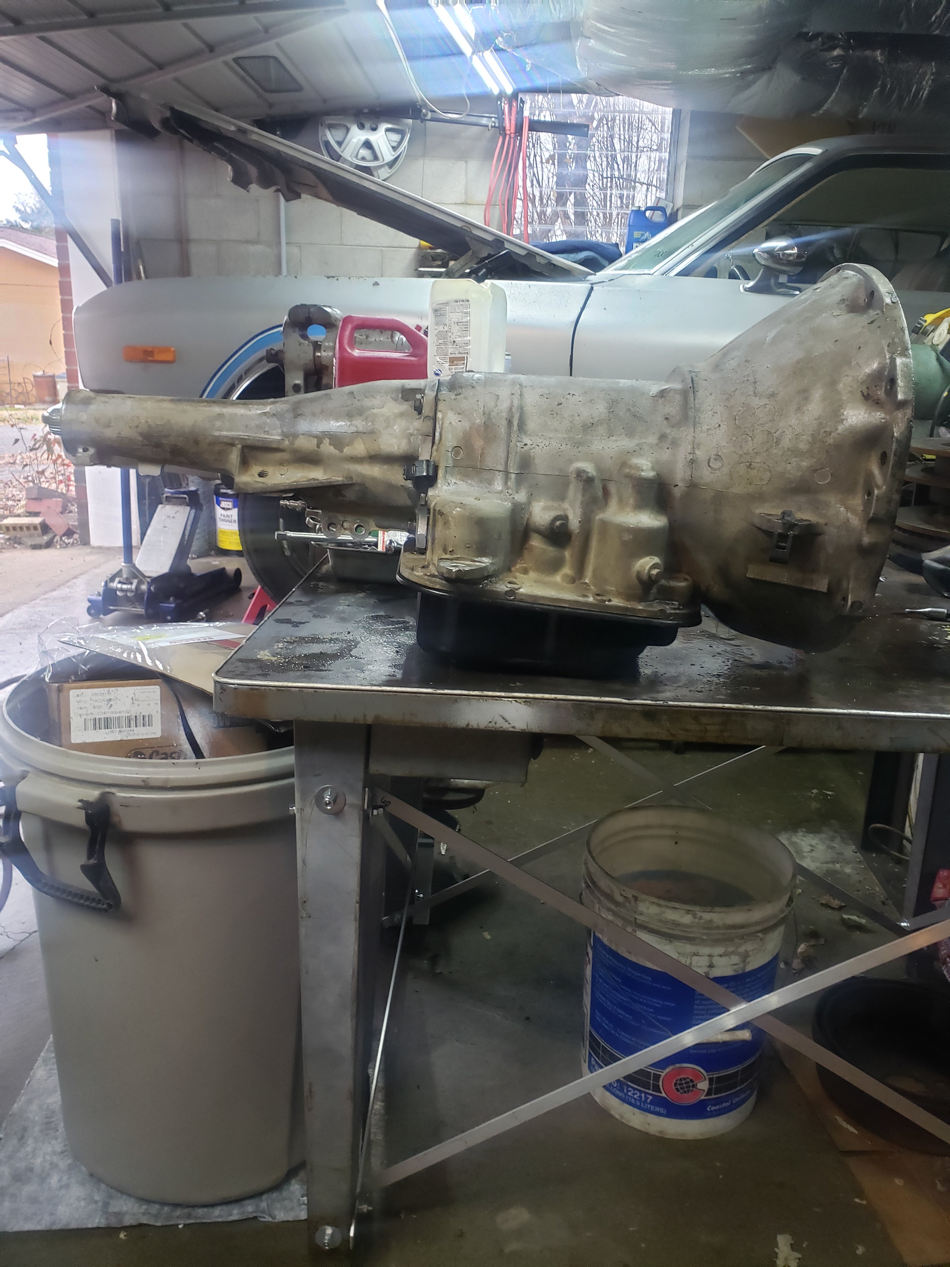

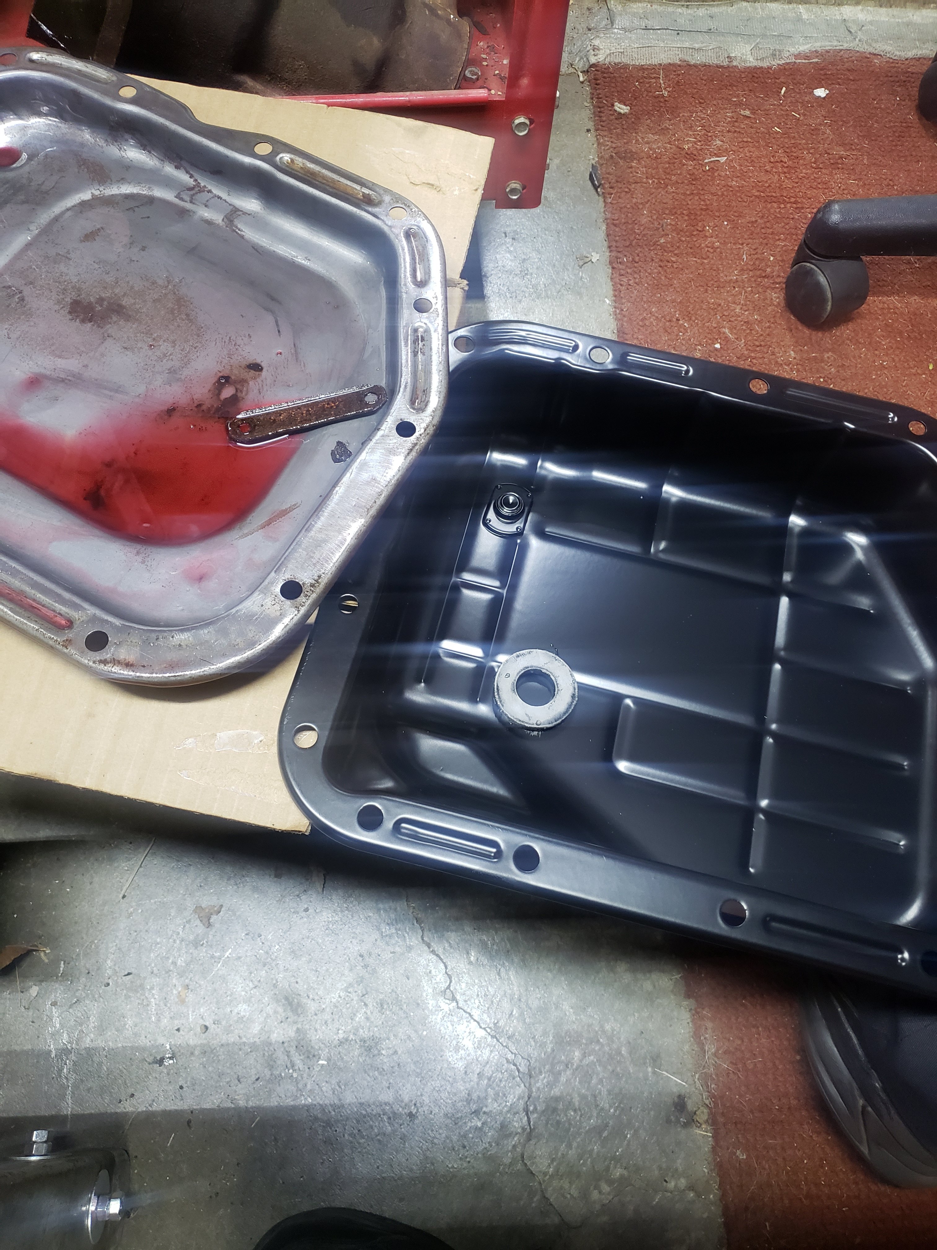

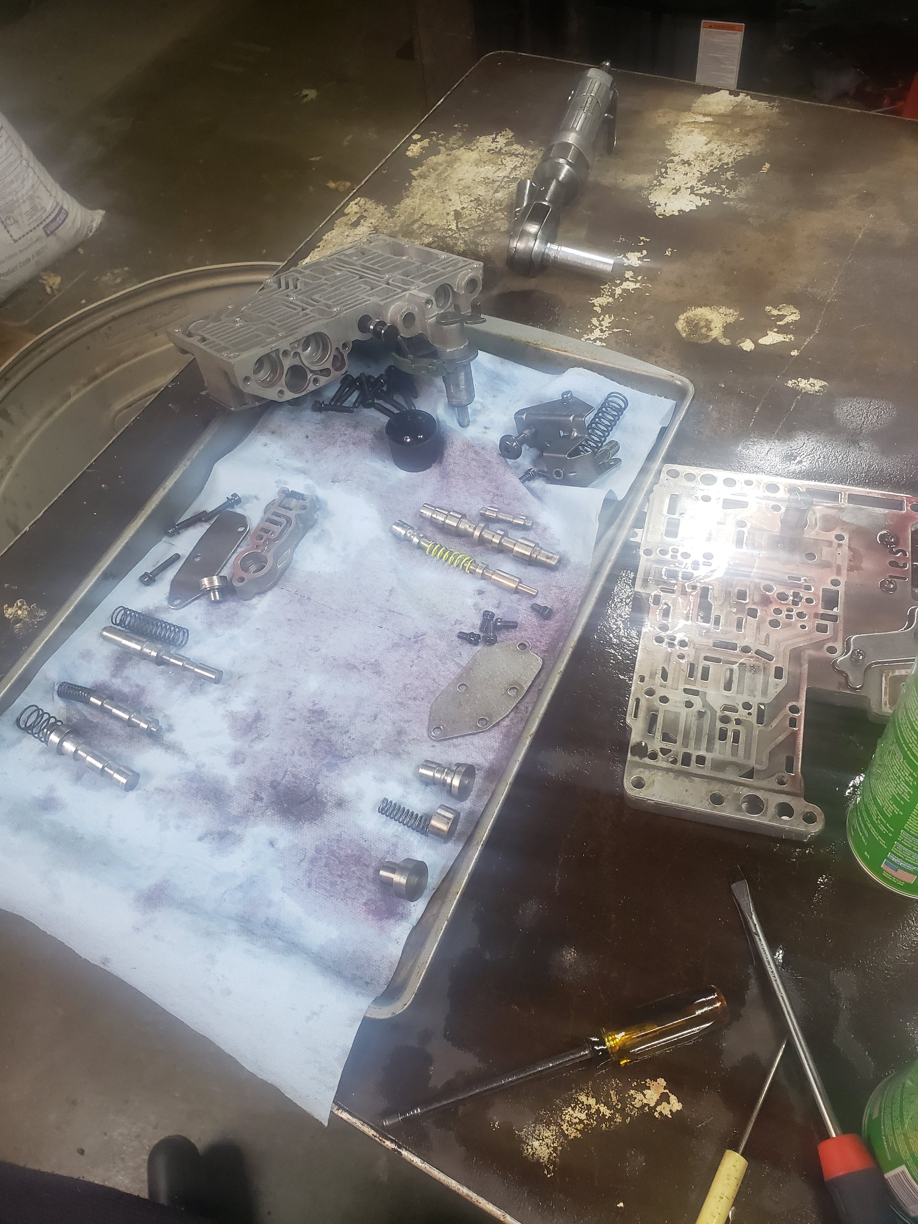

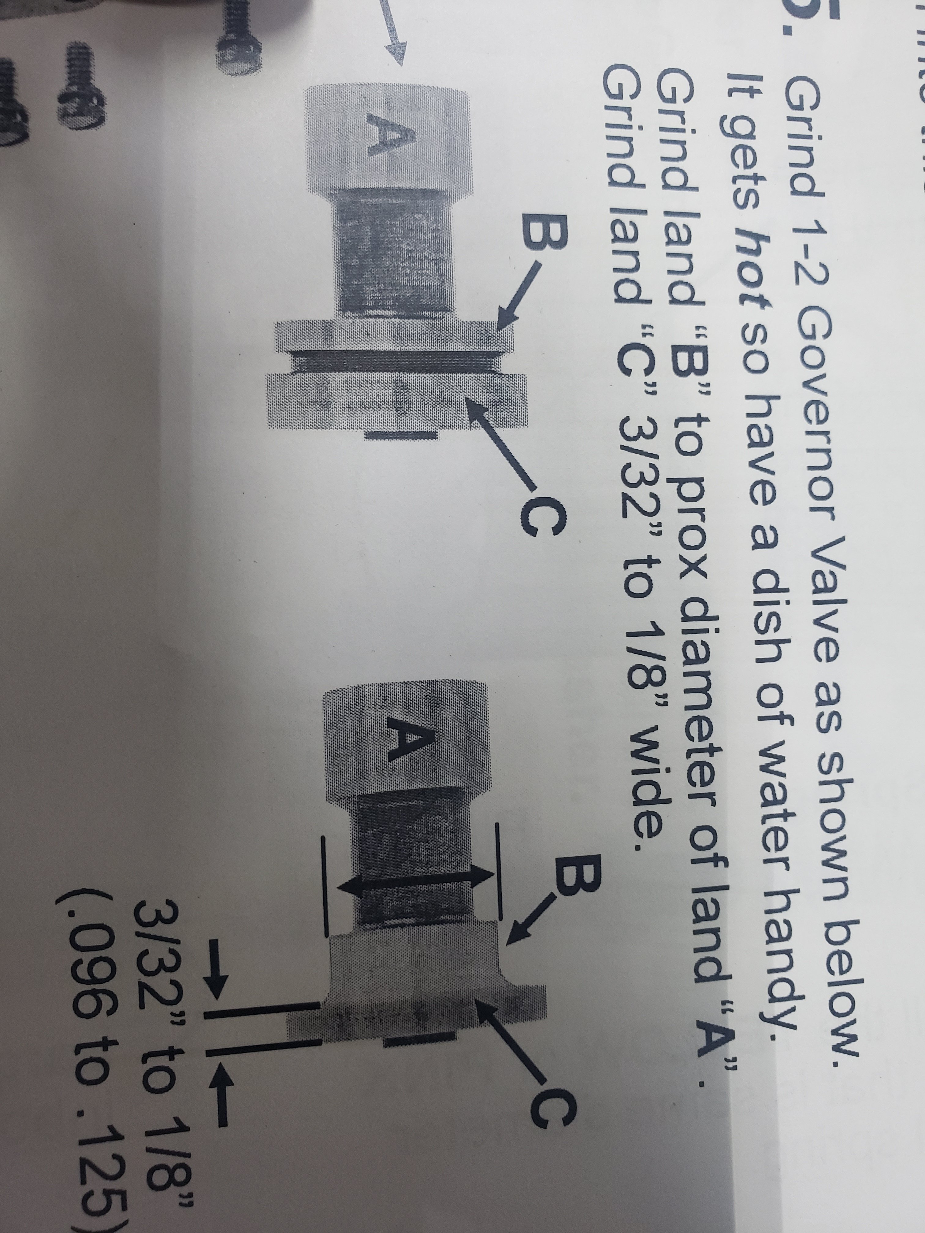

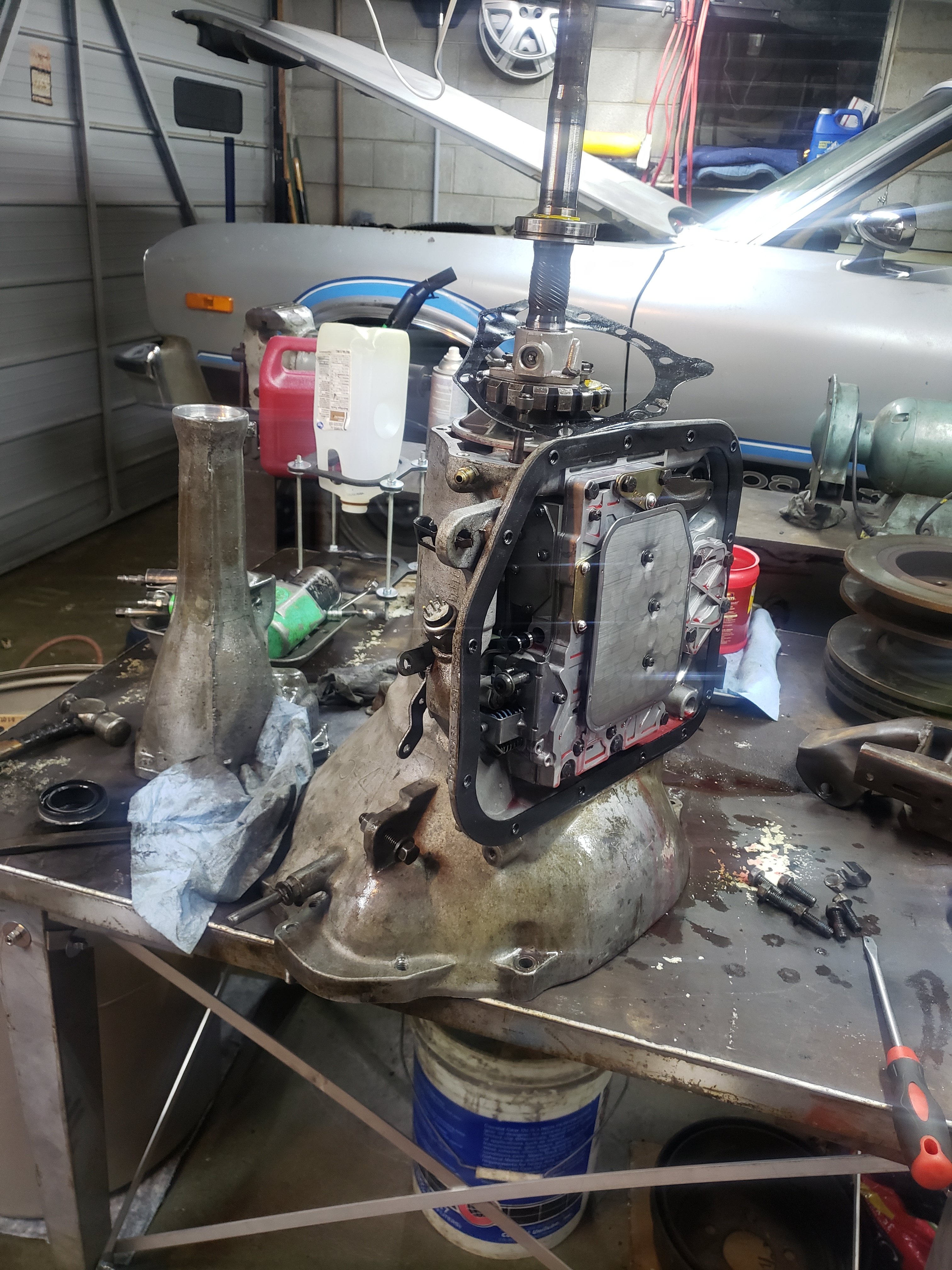

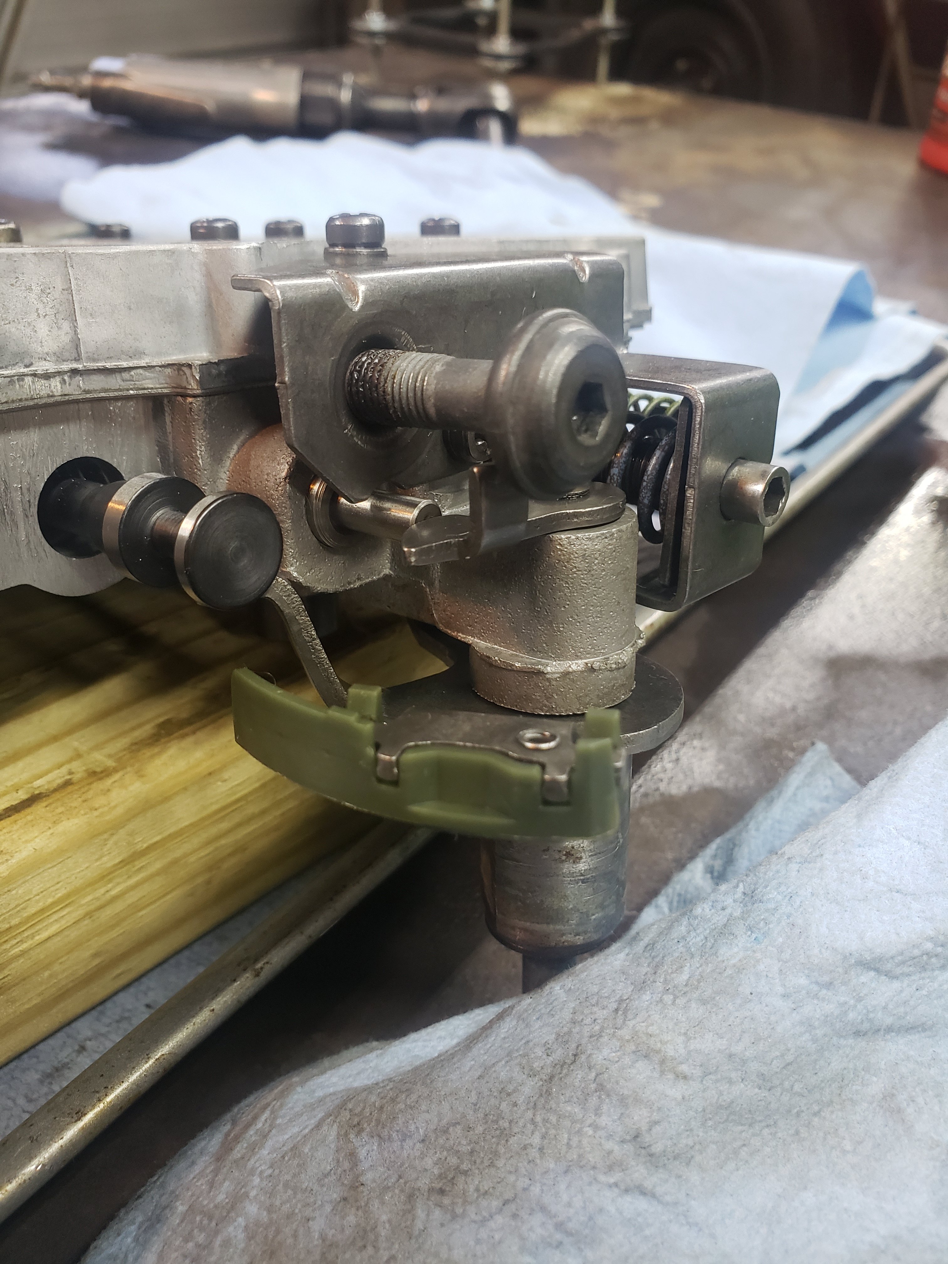

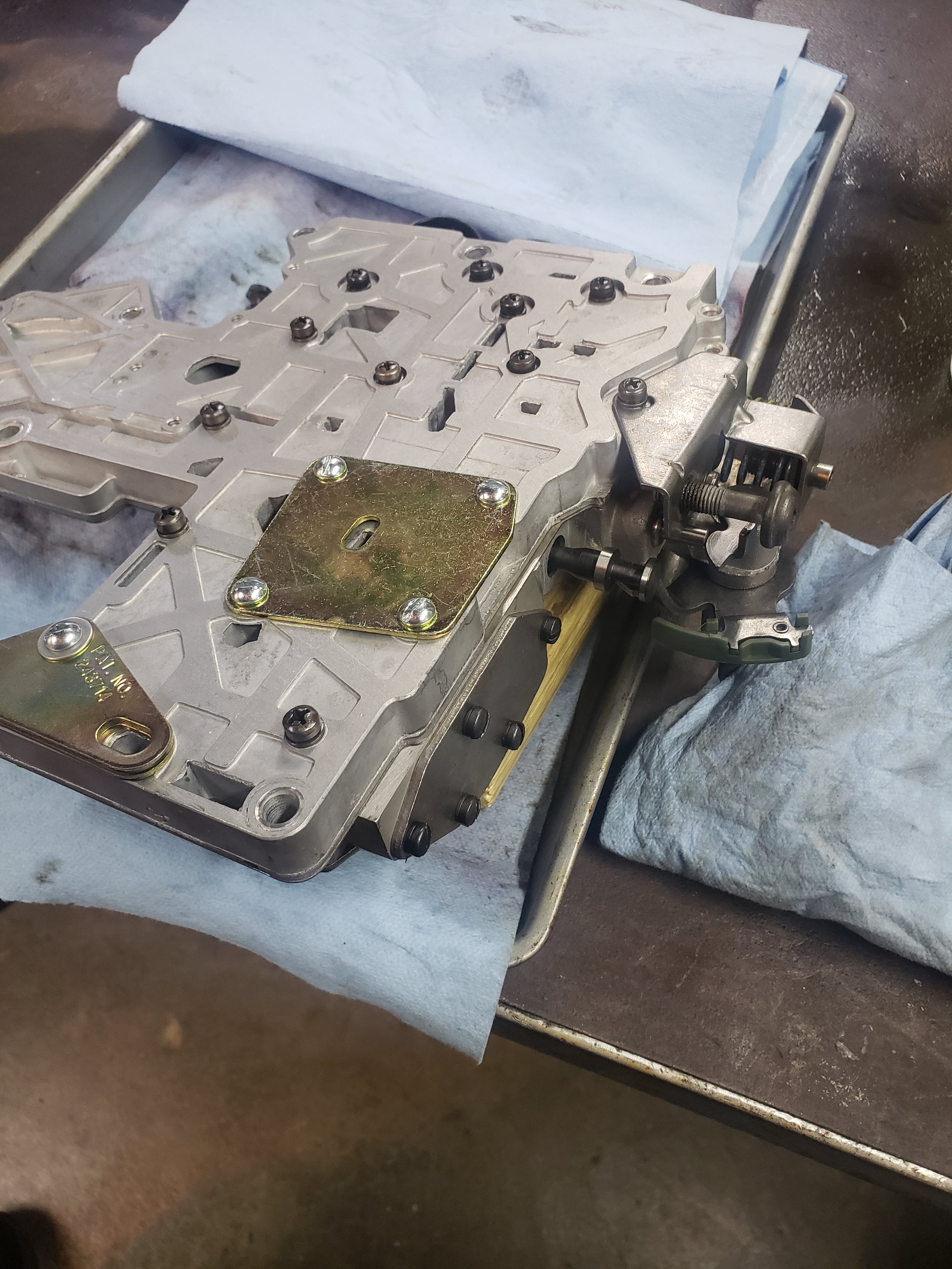

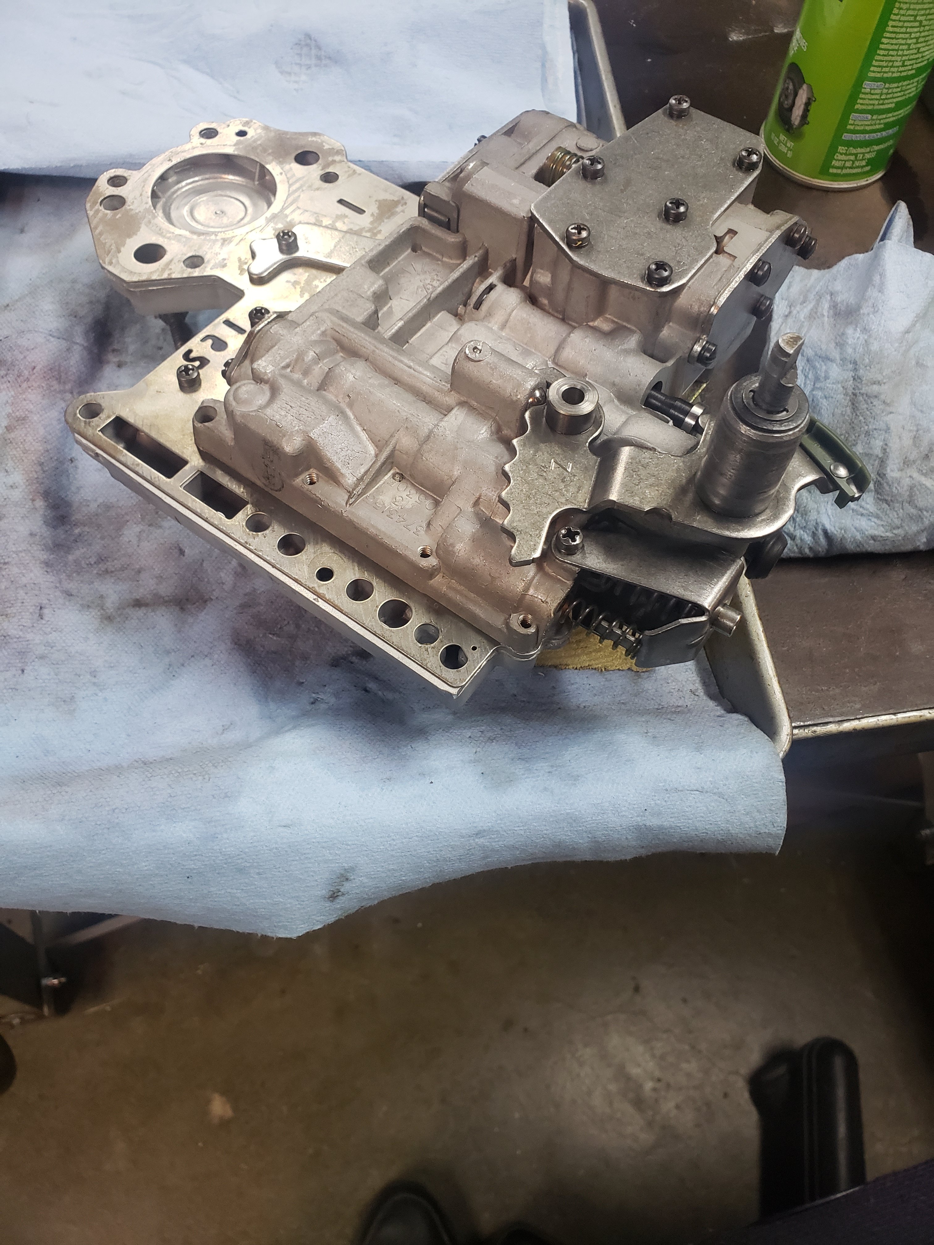

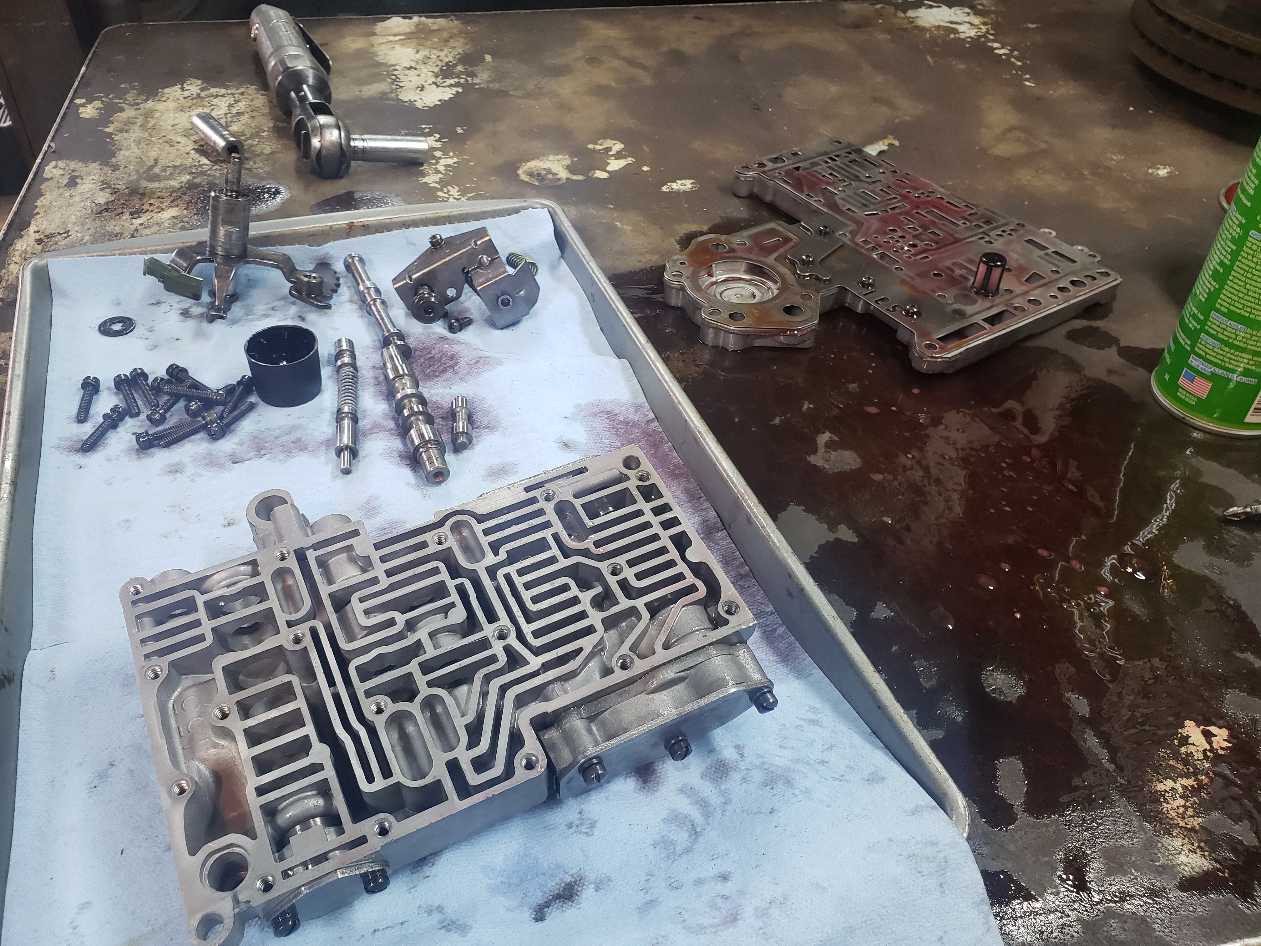

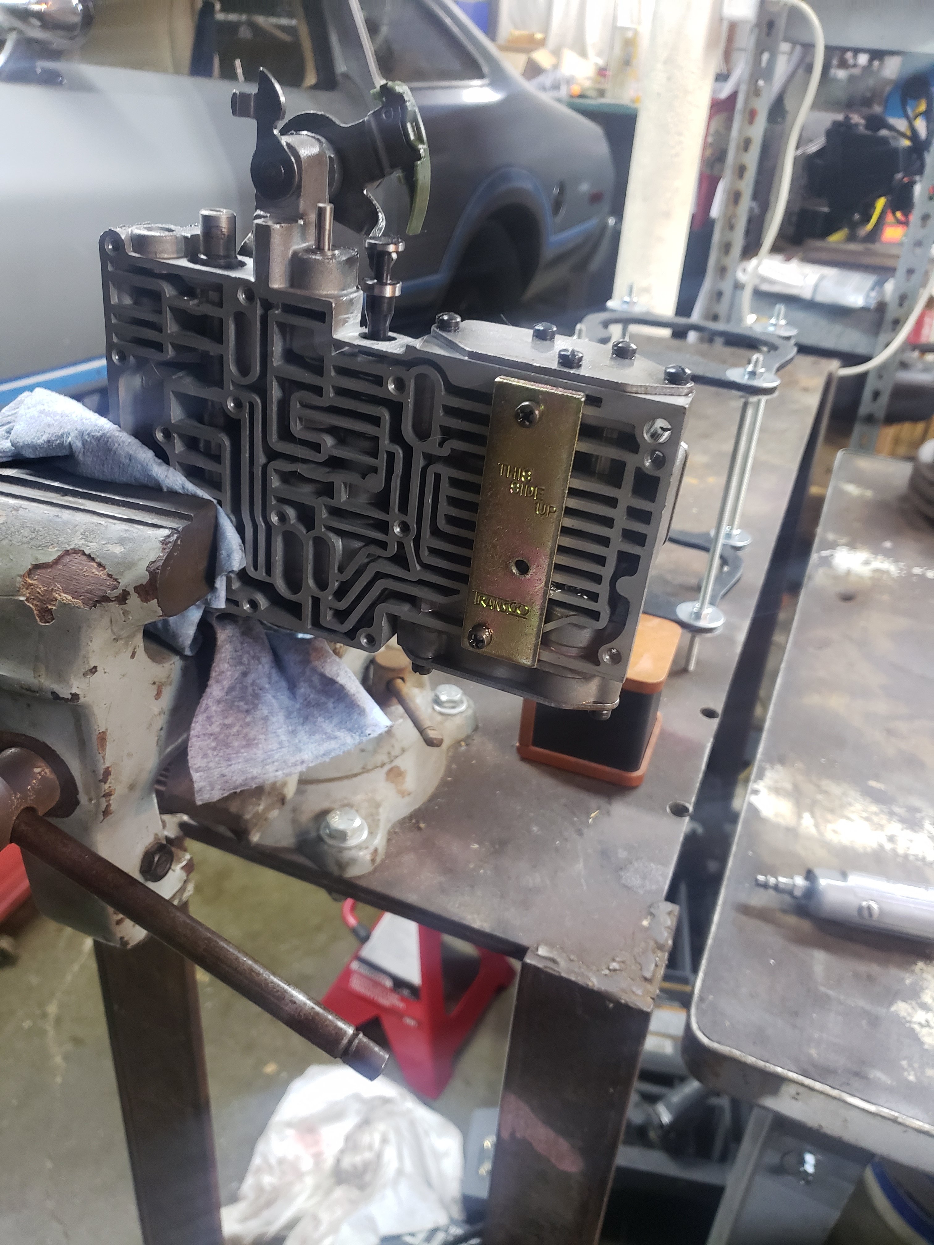

Well I am finally installing the TF 3 transmission manual valve body kit. Then I got to figure out what I'm doing with the shifter
Valve body is complete and ready to install... still have to change L/R piston spring, adjust the bands and install 1 solid cup plug....

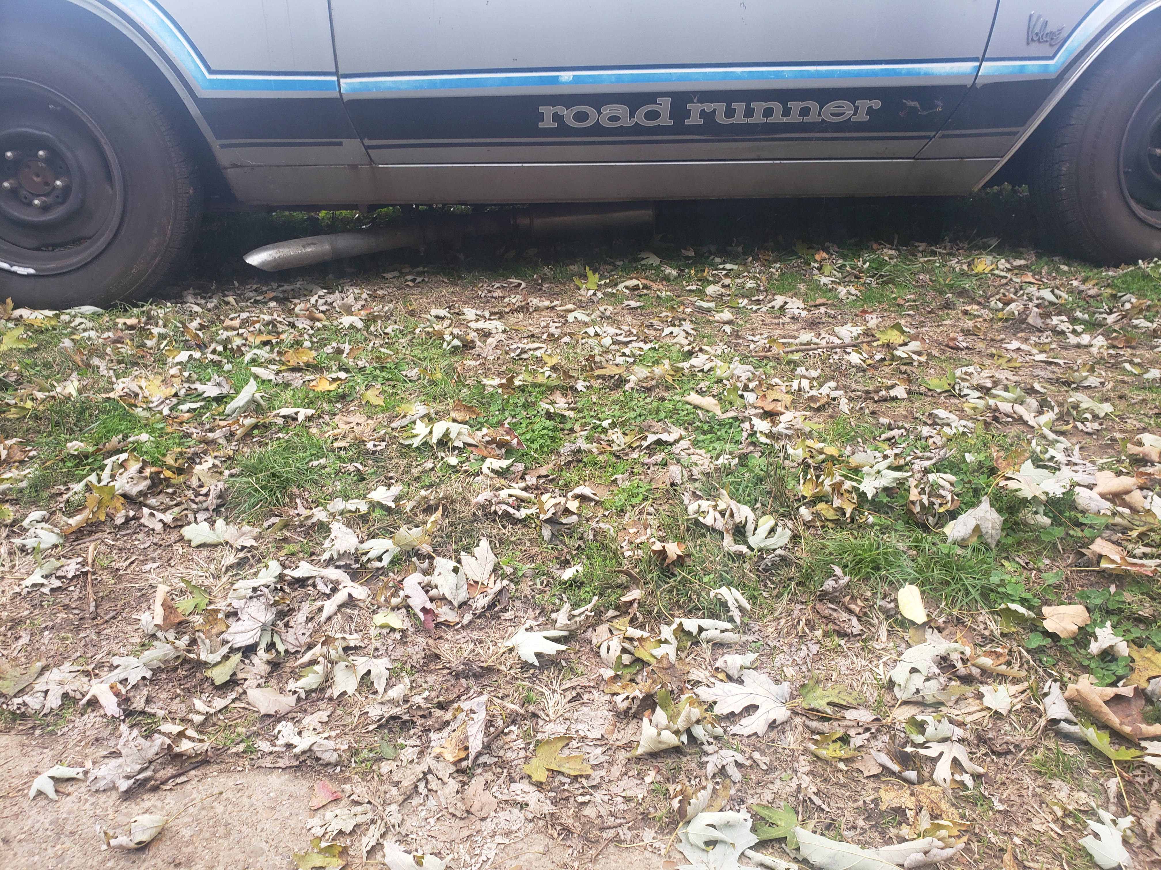

Got the exhaust installed today and took around the block a couple times , now I got to tune it with the exhaust on LOL

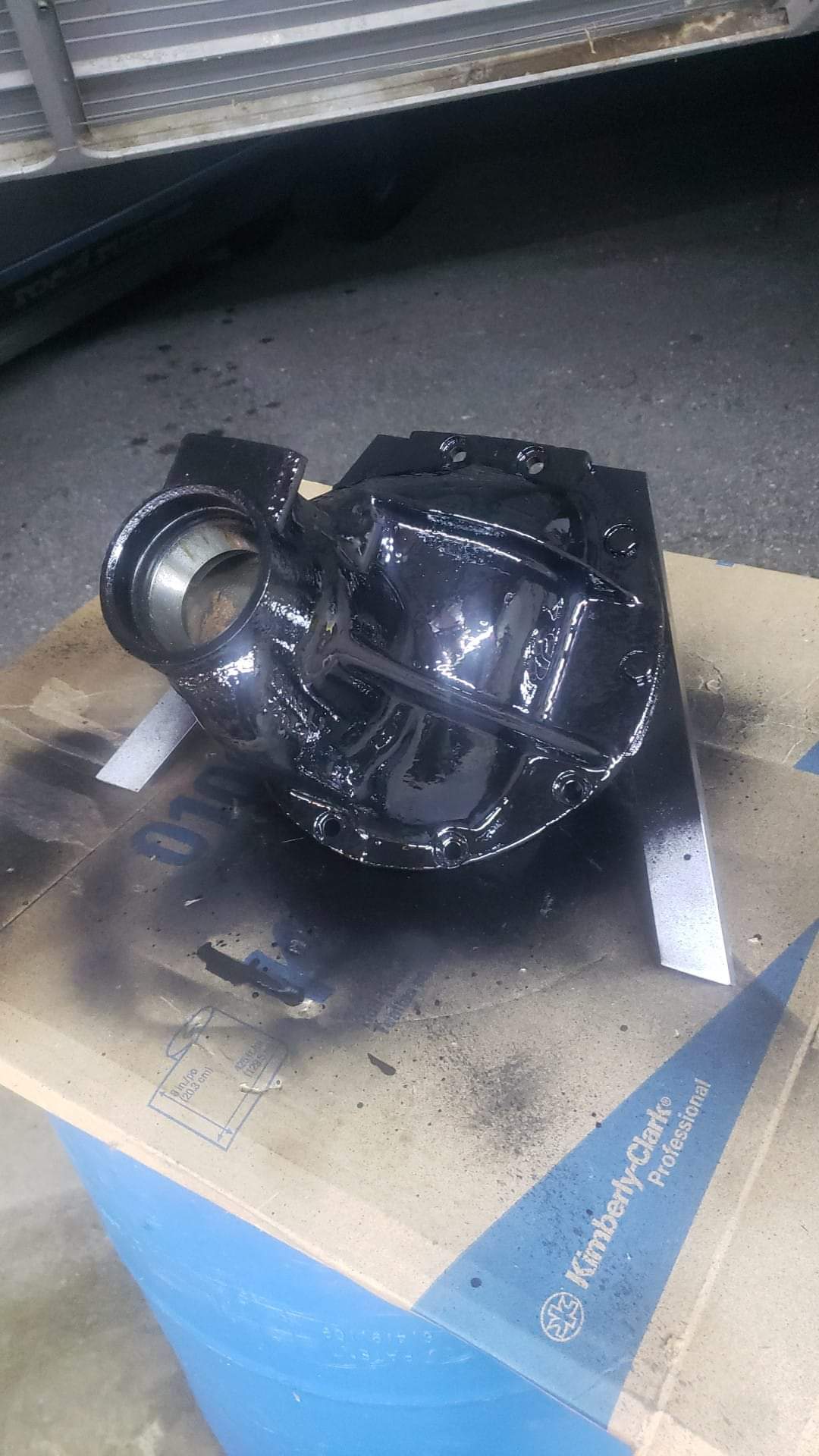

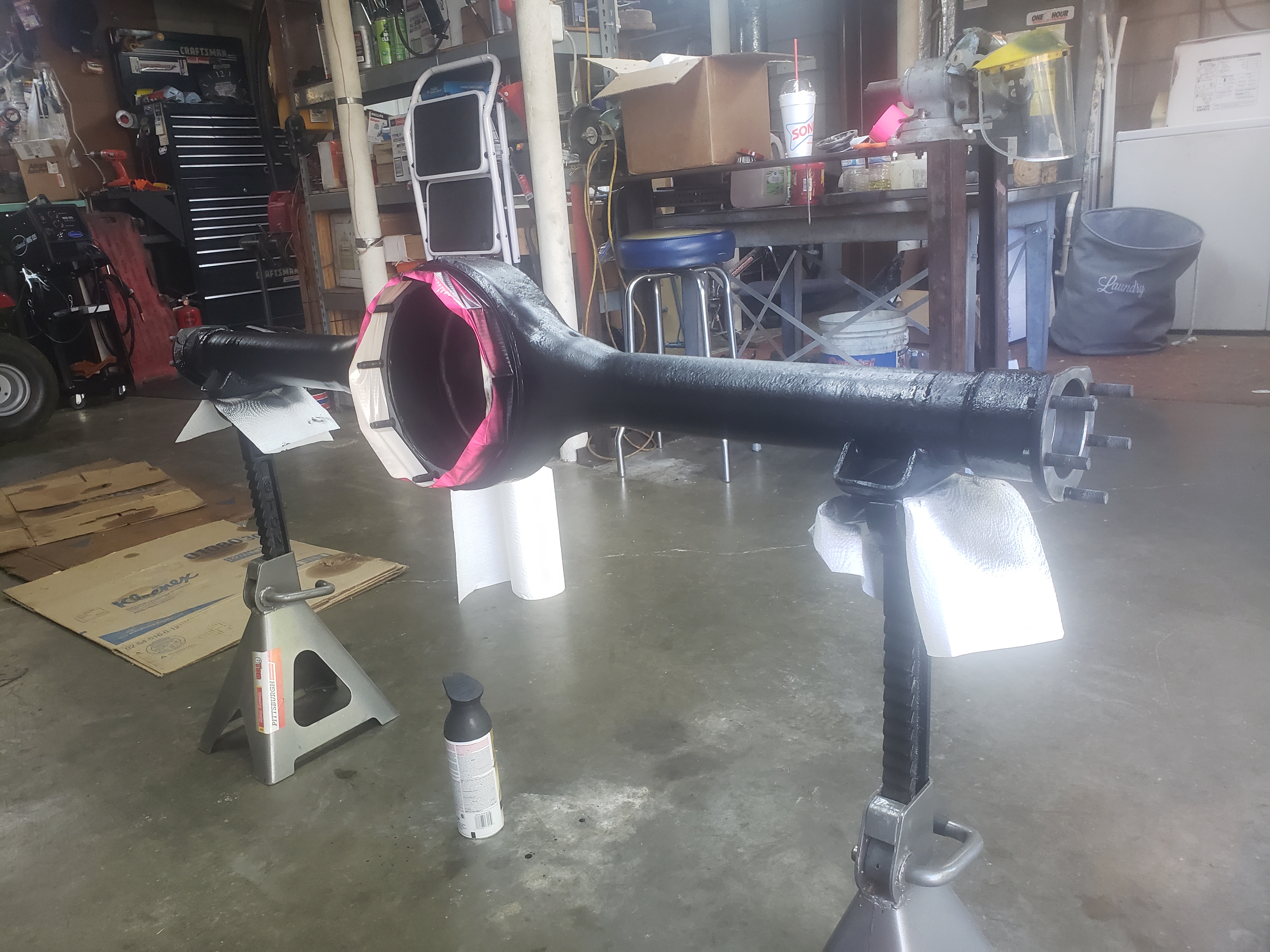

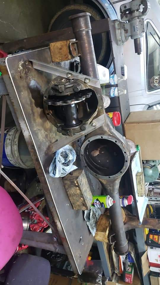

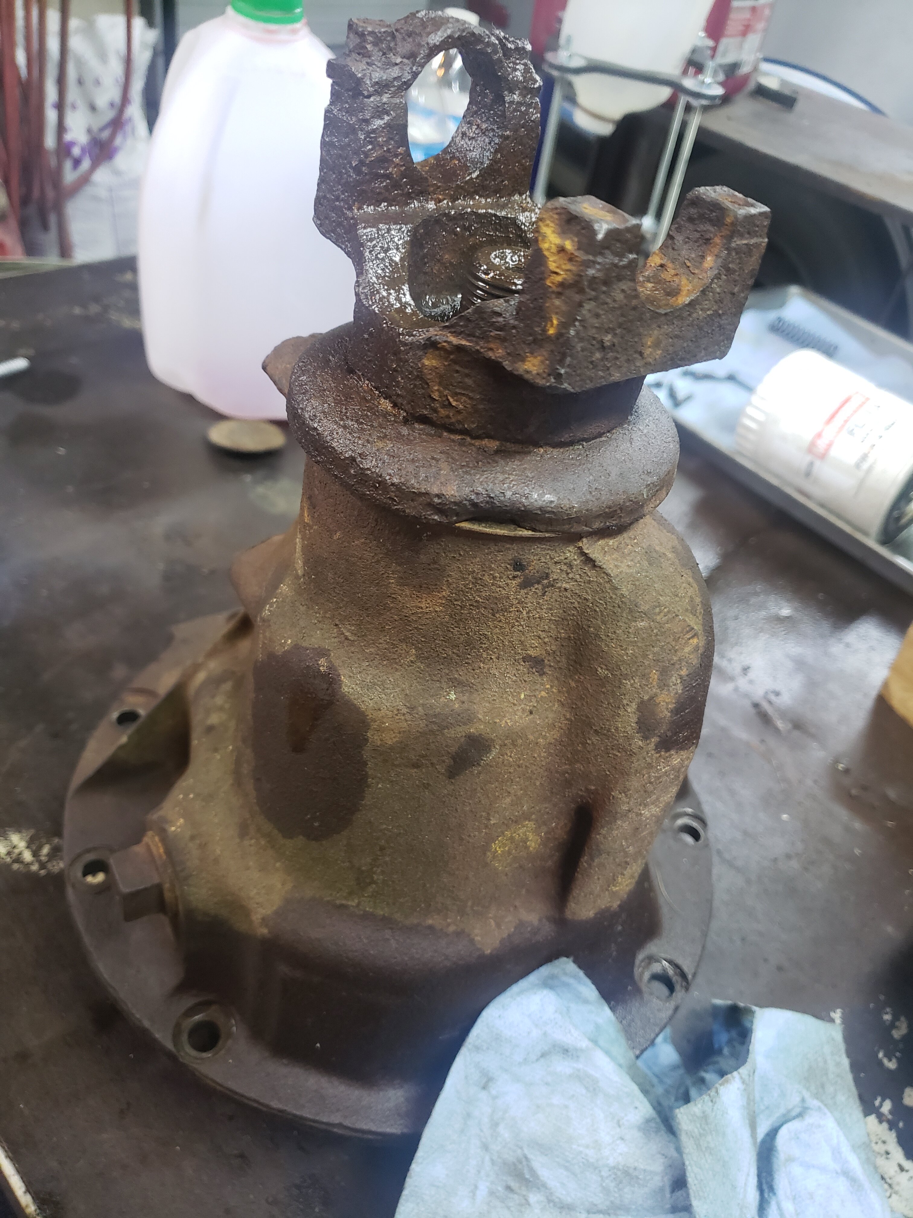

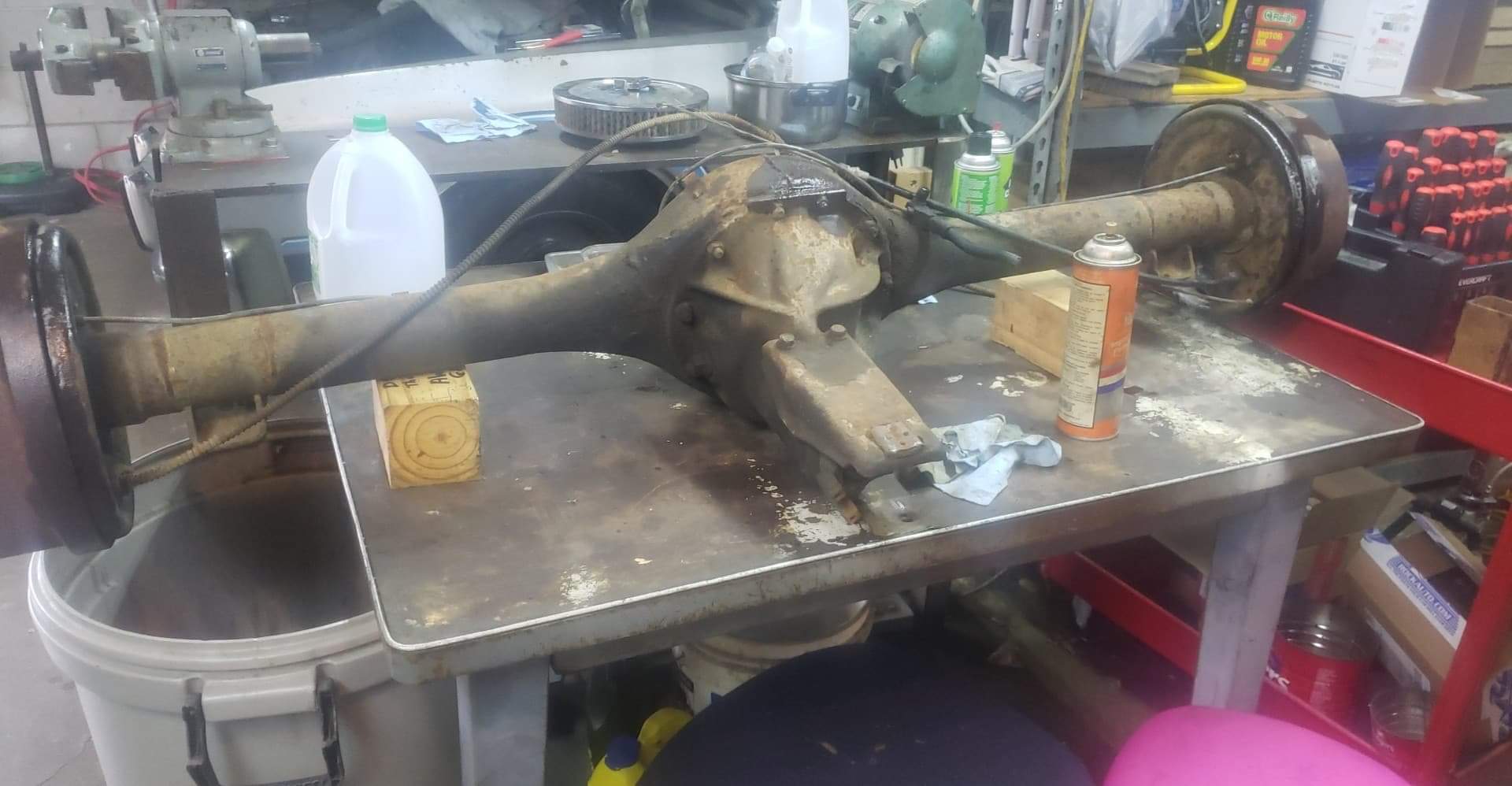

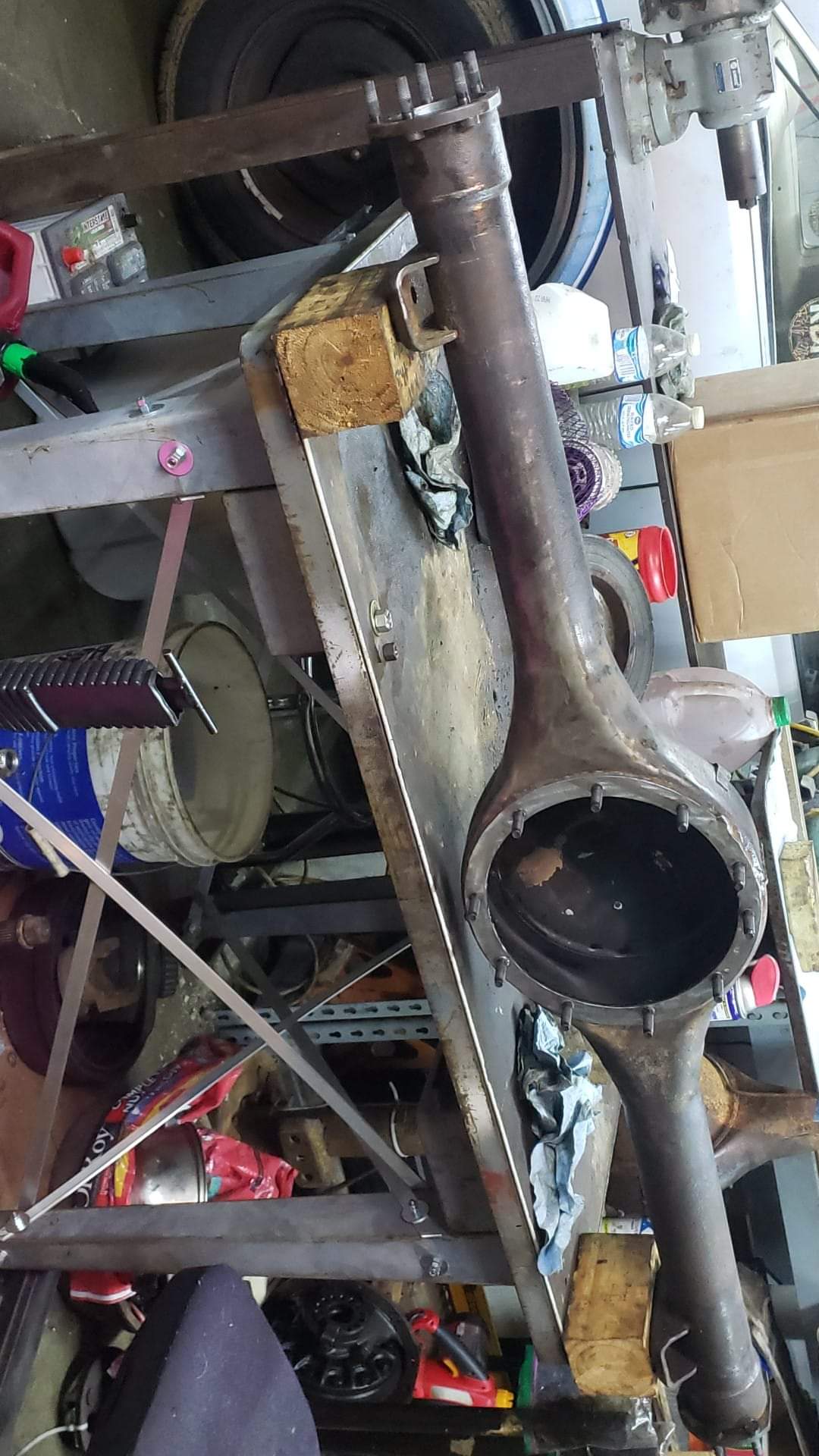

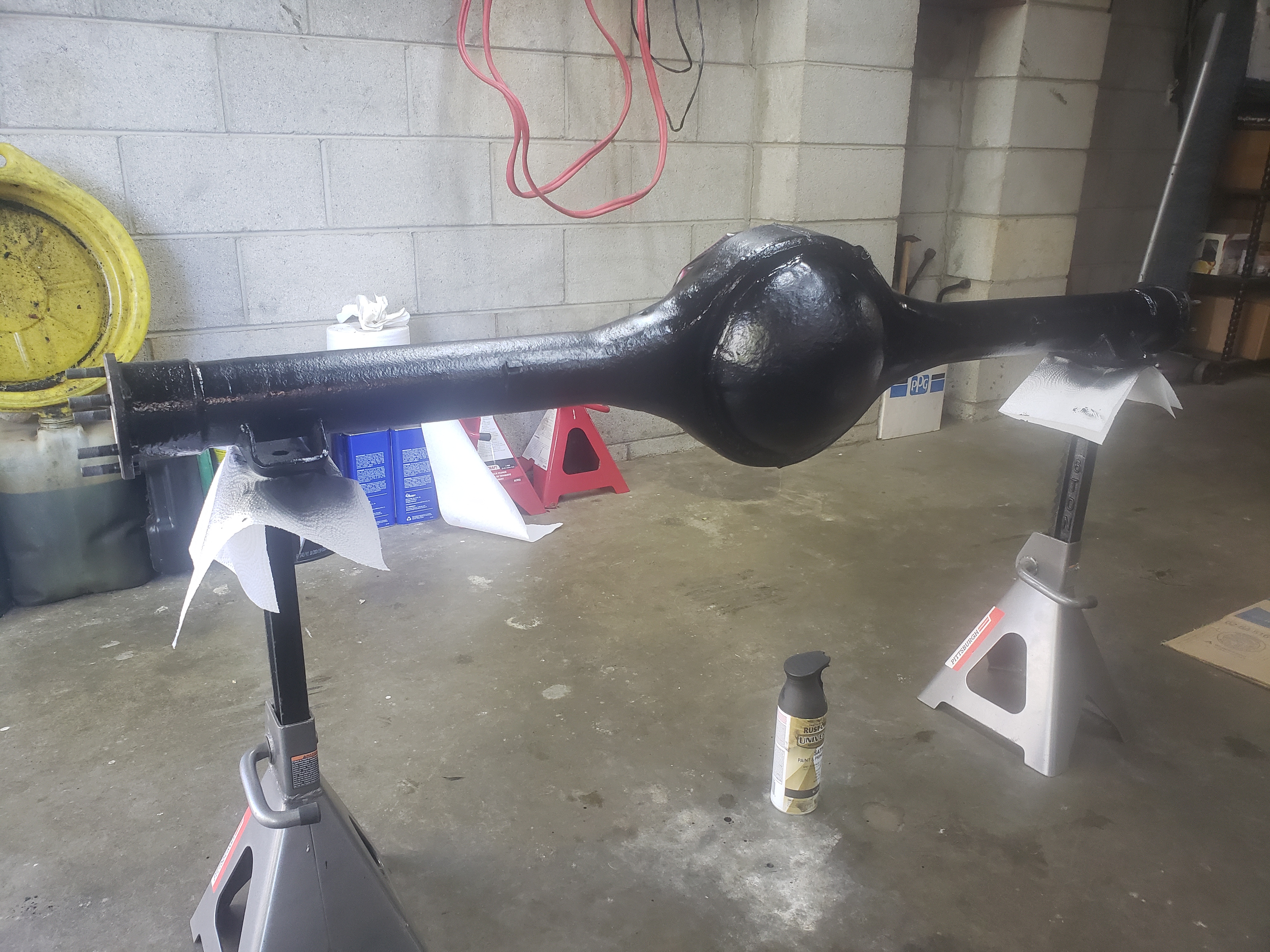

Here is the update on the 8.75 rear end rebuild/modified.....
67 Charger, 3.23 open diff, 741 case....
Basically I am using the housing and axles...

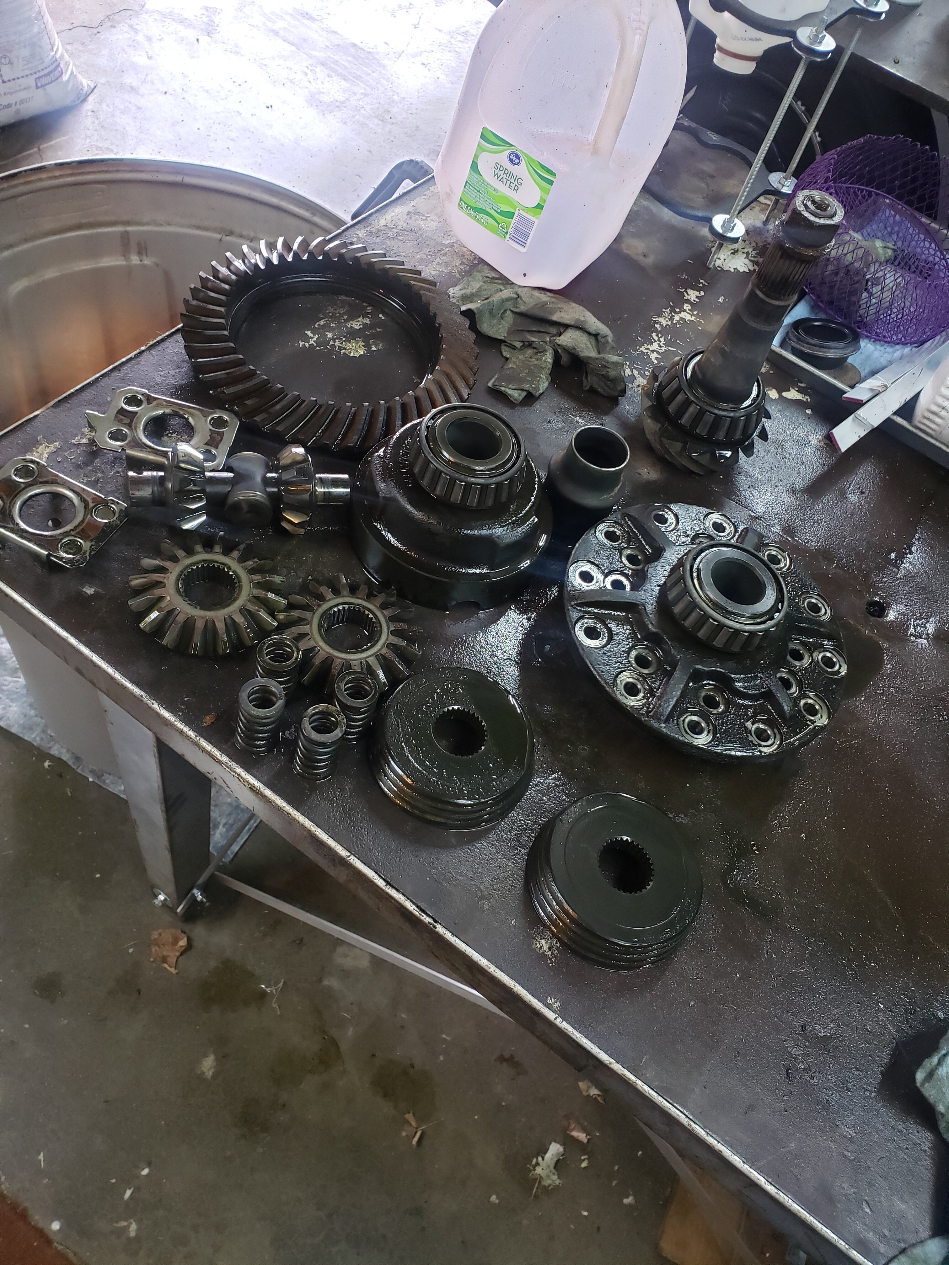

Went to my mopar buddies house (200 miles away) and dug this 489 case with 3.23 cone style sure grip and brought it back home with me..

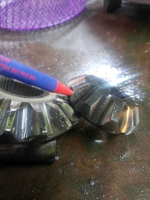

Found the diff and spider gears had pitting and now a paper weight....
All cleaned up, old studs removed....
New studs threw out....
Painted and ready for assembly....
This is a very slow process, very little time to work on it....
