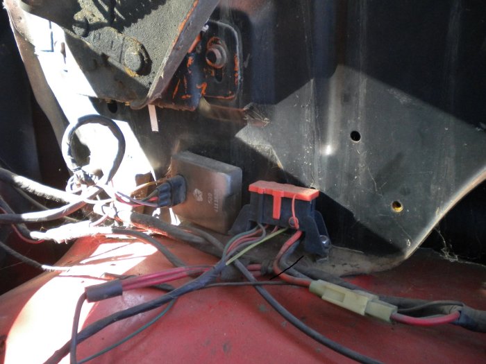

Chrysler did have a diagnostic port under the hood for a few years around this time. Of course, this was many years before OBD. I had such a port on my 1980 Gran Fury. In seven years, I never used it for anything.
