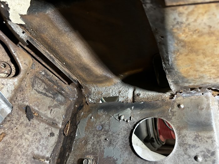

Here is the hole. Picture was taken from cowl panel.
Photobucket

Need to weld under here. There was hole also from cowl to inner fender, right under Hood brackets.
Photobucket
