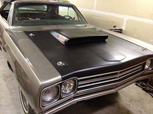

Are you looking to drive and enjoy, then an 80 Runner is going to be a blast. Buying just to resell on a quick flip? Good luck! I got 79 Volare' road worthy much faster and cheaper than my budy's cuda
Or the 69 RR

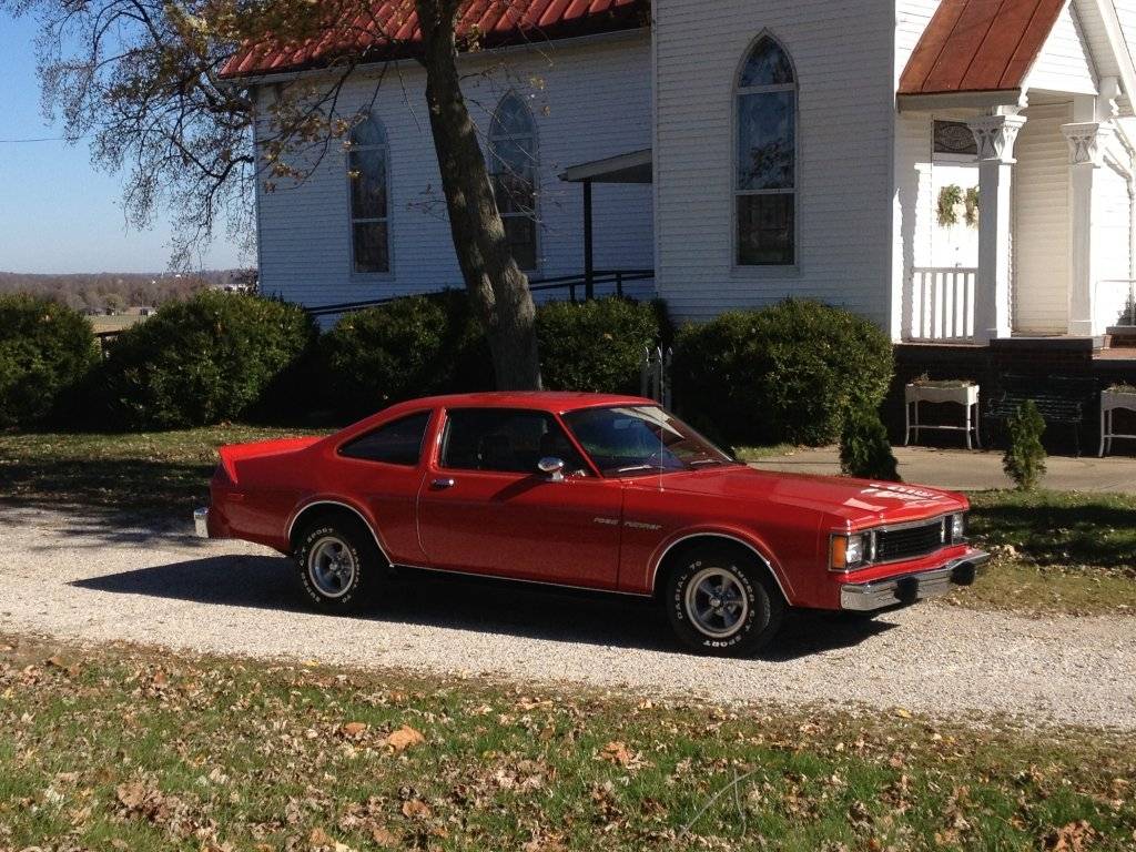

Still waiting for the re-assembly. All the while I'm blasting in my 79

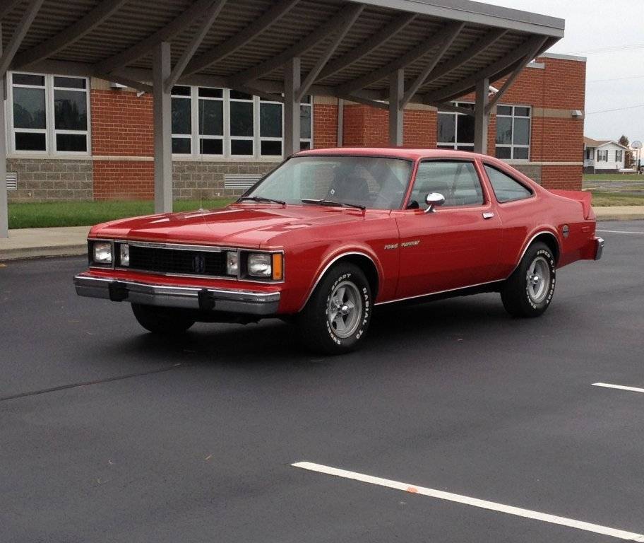

I have been told that the deal with Warner Brothers for the Road Runner cartoon and the "sound" of the Road Runner was from 69 thru 75 only.
Mine came from a family who owned three RRs - 72, 73, 74. We always use to snicker at Volare RRs, because we felt they were not "real" Road Runners. But as the price on the others keep sky-rocketing, I've been looking at them more and more. My real wish would be to have a '72, but how cool would it be to own the last car with the Road Runner package?
I enjoy mine. It is one of my favorite cars to drive.

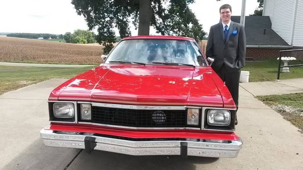

I found the car in Paducah KY. It sold new there and was owned by the original owner for 10 years. He traded it back in at the same dealership where he bought it. The salesman that sold the car new liked it so much he bought it and took it home and put in his garage where it stayed until he passed away. His family sold it to a guy that was going to make a race car out of it until he saw how nice it was, and decided to let someone preserve this one.
With a 14 year old son, I decided to get it and make a nice driver for him. The original 318 was still in very good shape with about 90,000 miles on the clock. The car was and still is rust free, but the paint was faded and thin. I had a coat of fresh base/clear put on, re-chromed the bumpers, and had new decals put on. I went through the mechanical's to make sure it was safe to drive. (tires, brakes, shocks, exhaust etc) I gave the keys to him on his 16th birthday. To my surprise, he would not take them. He said that he saw how much time and money I had put into the car, and if he tore it up, he was afraid that I might kill him. Needless to say, I was devastated. So I gave him my daily driver at the time, a 01 Stratus R/T that he nicknamed it the CM Stratus. (chick magnet)
My wife and I would get the car out of the pole barn on occasion for a drive or go to a cruise night. We even drove it to The Carlisle Chrysler Nationals one year (1400 mile trip) A few years went by and the 80 got pushed back further into the corner of the barn.
Then last year, Matt got married and he told me that he wanted to drive "his car" from the church to the reception. I was totally shocked. The car had not seen daylight for about 3 years. I charged up the battery, put some fresh gas into it, and it came back to life like it hadn't been sitting at all.
We are talking about taking a couple of our Road Runners back to the Carlisle Chrysler Nationals in 2018 for the celebration of 50 years of the Road Runner.

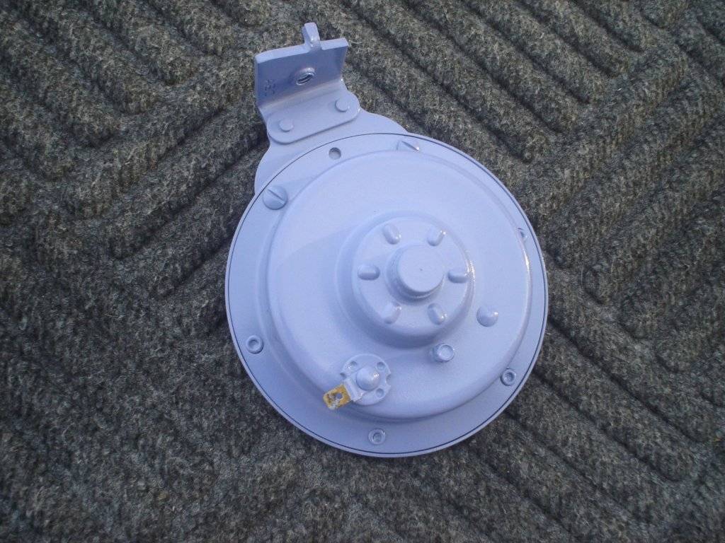

..........BTW, droptop, did it come with the "beep beep" horn? And, did you say "Road Runners" as in you own more than one?

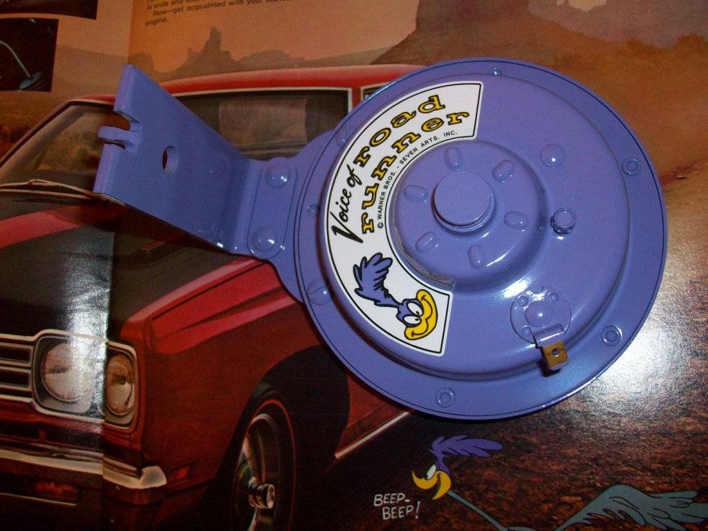

No, it did not come with the beep beep horn, I put that on there. And yes, I have multiple Road Runners. My wife calls it my obsession. LOL.
Horns from late ‘60’s to early ‘90’s are pretty much the same – except for the beep beep horn (black in ’68 and purple for later years).
The ’68-70 horns have a long pedestal on them so they can be easily seen with hood open.
The early ’71 and up horn have a normal pedestal on them and can easily fit FMJ cars.
What I don’t know is what the final year of the beep beep horn is.
Personally, I wouldn’t want a Road Runner without one.
I kinda want to get a couple, putting one on my Volare wagon and other one away – but pocketbook says otherwise.

I have seen them for years, in the cars, but never actually heard one. Do they really sound that different than a regular horn? Are they available as a repop in the after-market?
I don't recall seeing one on an F body before, from the factory. Also, I don't recall seeing one on 'the '75's as well - but that, by no means, doesn’t mean they didn't come that way.
For those who don’t know, the horn, when switch/button is pressed fast twice, sounds like “beep beep” (just like the cartoon), and not “Wonk” (or whatever one might want to describe it).

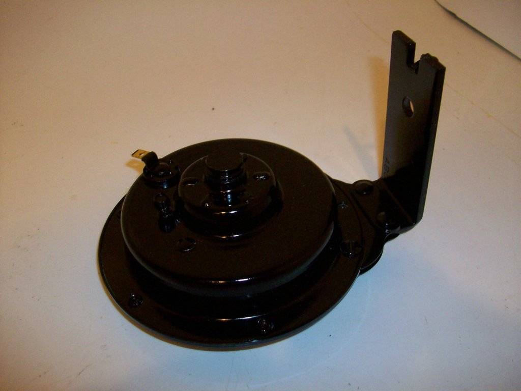

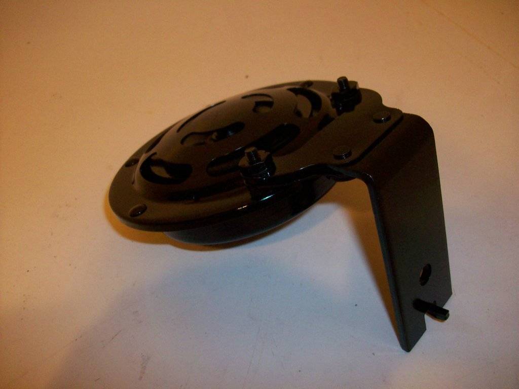

The ’68-70 horns look like this
‘68’s were black and long stand
’69 up purple (or whatever color one might call that) and have a sticker on them saying “voice of the Road Runner” on them). Actually, I don’t recall seeing any stickers on ’71 up horns (not easily seen – like the ’68-70 horns are) – but that doesn’t mean they were not there.
’69-70 shown, with long stand.

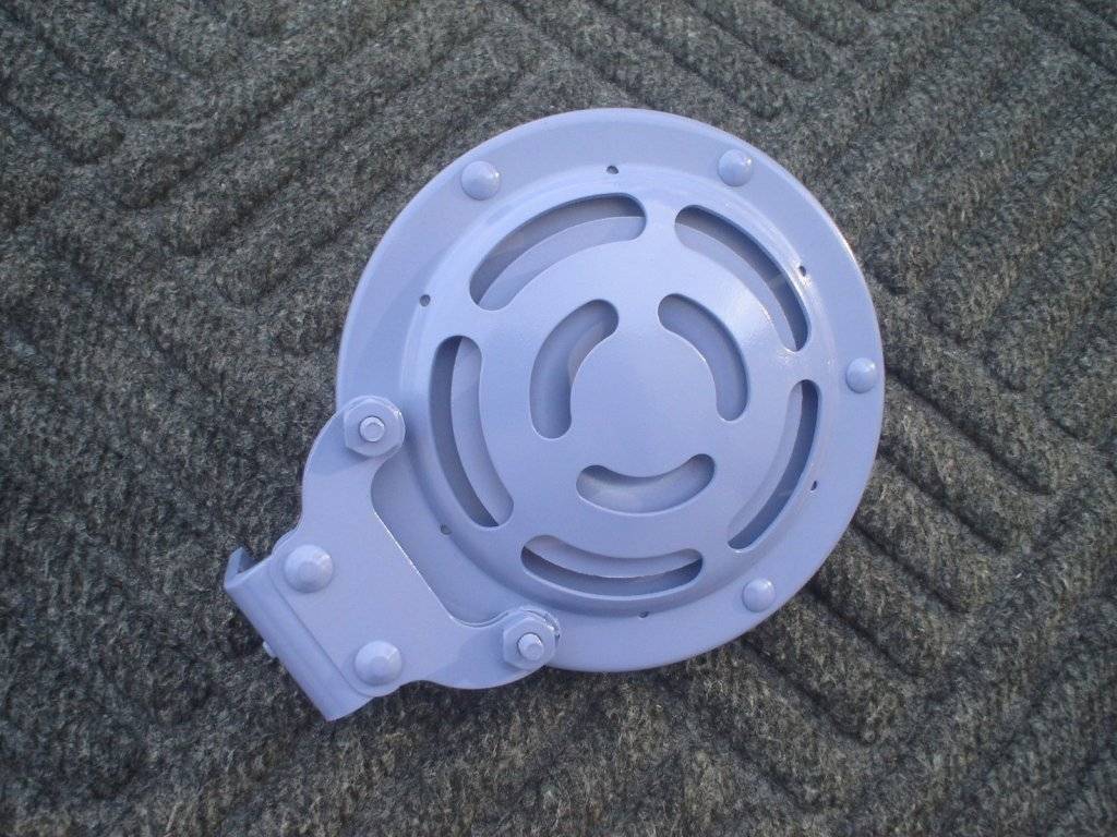

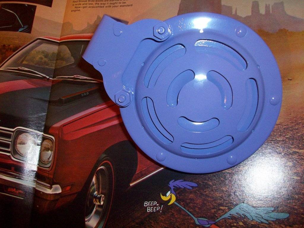

’71-74? With short stand (meant to be placed behind grill).
Note: above pictures swiped from eBay.
Note: I don't have any data to dispute the last year they were installed from factory.
I do know that I like the horn and I do have plans on placing one on my station wagon when extra $ comes along.
There is at least one company repop-ing them, maybe more.
1,427
344
The horns have aluminum windings inside to give the different sound.Made by Sparton,same horn in Army Jeeps
