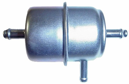

- If car has a 3-nipple fuel filter (hidden under the alternator), then I would disconnect the small hose at metal line side (leaving the small hose attached to fuel filter) and insert a ¼” bolt into the hose. It might be helpful to loosen the alternator (remove the (½” head) bolt completely), pop fan belt off of pulley, and tilt alternator upwards to gain better access to the fuel filter.
- If car has a 2-nipple fuel filter (possible but unlikely), then the step above is not needed.

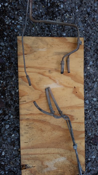

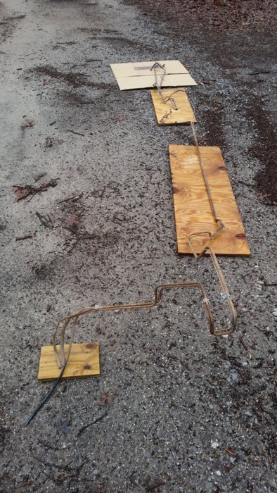

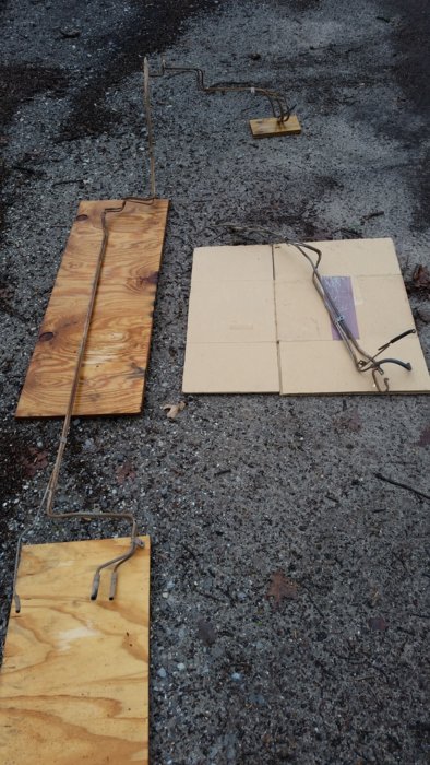

There are three metal fuel lines going to fuel tank. 5/16” main fuel line. 1/4” return fuel line (the one you plugged temporality to test – be sure to hook back up afterwards). 3/16” fuel vapor hose (not an issue/concern for getting car started).
These above-mentioned metal lines are 2-piece and has a somewhat hidden section of rubber fuel hose close to the firewall behind R/F tire, that sometimes causes either a fuel (or vapor) leak. Note: it is much easier to suck vapor (air) than it is to suck fuel.
Here are what the metal fuel lines (tank to pump) look like:
Rear looking forward
Firewall hose splice (sorta hidden)
Front looking towards rear.
Kinda hard to find the rusty steel lines in the wet gravel (sorry).
I removed these to make duplicates of – for they are too rusty to reuse.
My plan is to make a set in stainless and to use 3/8" fuel line (one of these days . . .).
