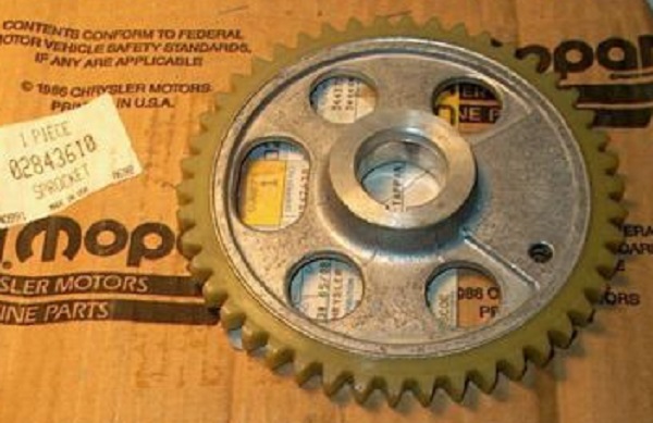

Hardly anyone sells the plastic timing chain gears anymore – because of they wear out too fast. Get a good quality double roller timing chain and you will be set for a long time. If you are going the trouble to change the timing chain, I would also spring for a timing chain tensioner.
Plastic single roller camshaft sprocket (plastic teeth on an aluminum gear)

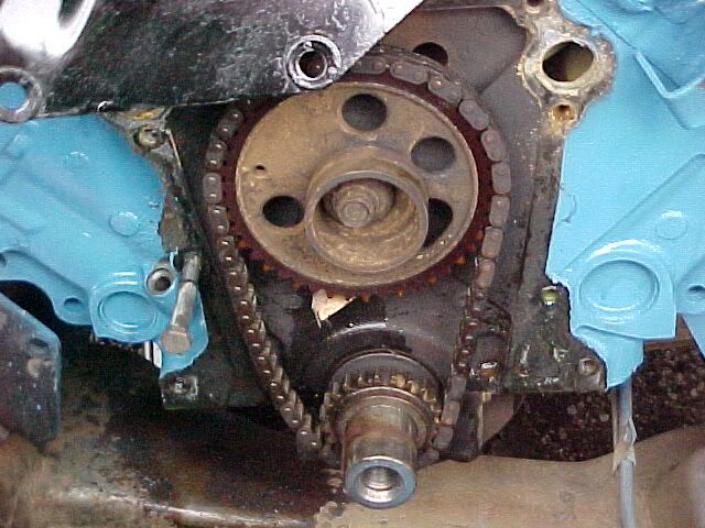

This is one on a small block. I have seen teeth worn to dimples OR where teeth break completely off.

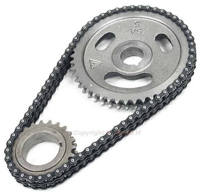

A all-metal double roller timing chain. You get what you pay for (ie: levels of quality)– so budget accordingly.

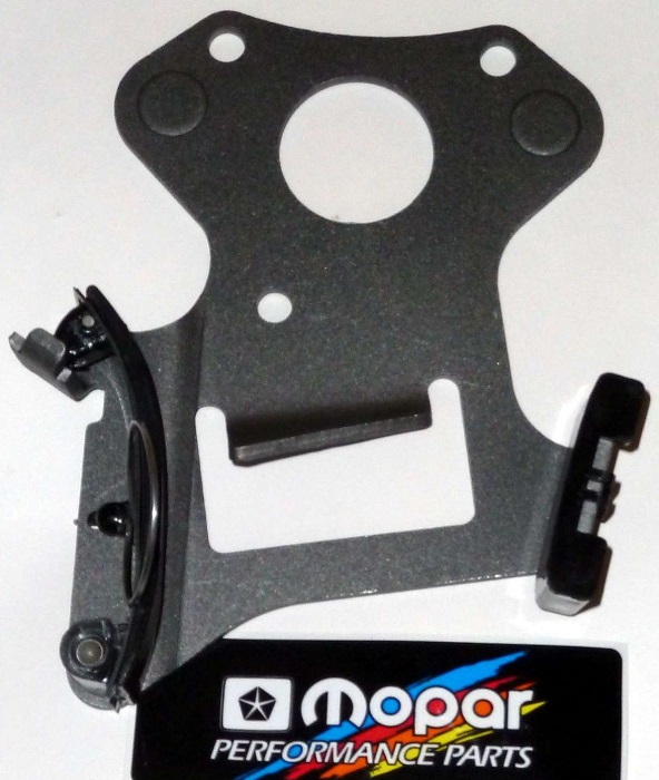

A simple bolt on timing chain tensioner – available through Mopar Performance or aftermarket. This is well worth the investment - if you plan on driving the car much. This will work with any double or single roller timing chain or even (gasp) plastic.
Plastic single roller camshaft sprocket (the part of which is plastic, on an aluminum gear)
