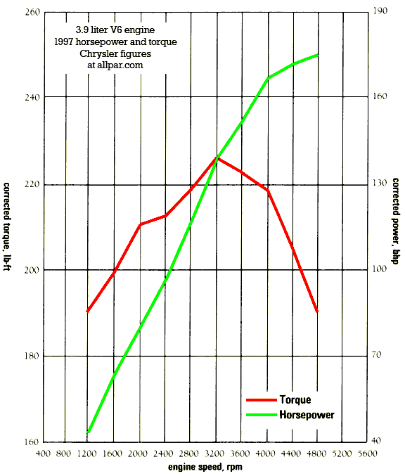

Imo, 3.55s are kindof a teaser for this combo. With a typical 1750 TC, the graph shows a tic over 200 ftlbs available at WOT. Multiplied by the 2.74(hopefully) trans ratio and 3.55s, this comes to 1945ftlbs(corrects to 1730@24" tire) , which should be just enough to spin 27s. But 3.55s will only take you to 45.7mph@5800 (5%slip),at the top of first. On the shift, the Rs will drop to 3260, and there the power is down to 140ish hp, so it's all over.If you're ok with this, then enjoy 'em.
A 2800TC will allow some bigger tires, and make you quicker off the line, but the 3.55s will still kill acceleration at 45.7 mph
The right combo to hit 60,with that trans, is a 2.76rear,and 28s which will hit 60mph at 6100(5%slip). And the right TC is about a 3200, to launch at 226 ftlbs, and that should get you a corrected torque to the pavement of about 1465,just barely enough power to spin those 28s.
Just for arguments sake, there is no reasonable street gear to be used to optimize for 60 at the top of second gear(1.54). It comes to 4.88s with 27" tall tires) to hit 60@5680.....4.88s with .69od (A500)will be 3.37s at cruising,and; 65=2720@zero slip.
But man would it be quick!
I ran a teener with 4.88s; and .57od to hit 65=2128. Yeah that teener did zero to 60 reeeeeeeal good.
