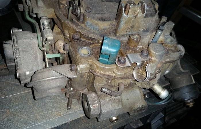

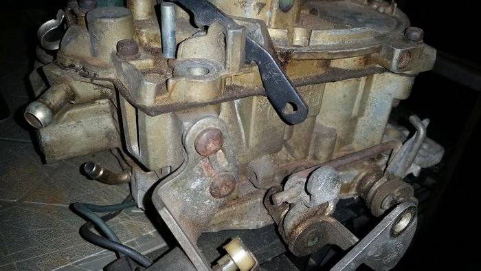

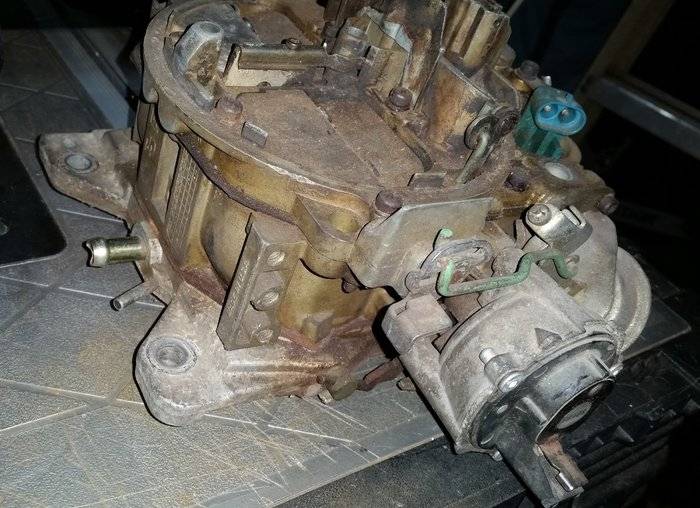

I do have a good, computer controlled Chrysler QuadraJet that I have for sale. I don’t have the numbers in front of me at this moment (at work) but (if I recall correctly), it is off of an M-body 318.

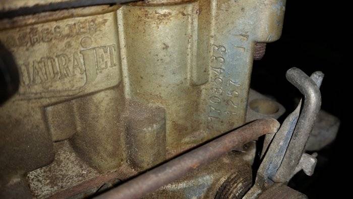

My Quadrajet is from an '88 M-body (there was only one 4-bbl used in M-bodies that year, but several versions in pickups/vans).
Dodge part number is 4306433
Rochester part number is 17085433
Date code is 125 7 (125th day of 1987 – which seams early for an '88).
