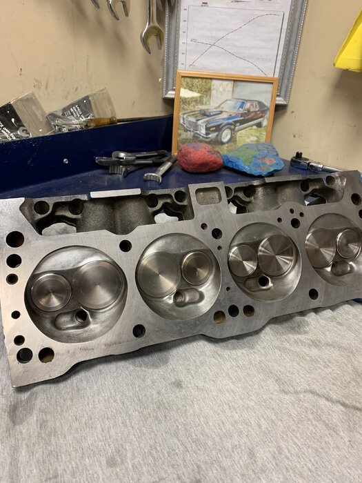

So an interesting tid-bit, the combustion chamber (open) on my W2 head is missing that spark plug 'pad' as I call it, the flat casting spot by the plug as it protrudes into the chamber.
All the factory heads I have seen have it. I always thought it was meant to allow the flame to start up and then propagate evenly around. I am curious though if there is any sort of 'physics of flame' travel reason to the shape?
This is what my chamber looks like (see attached image).

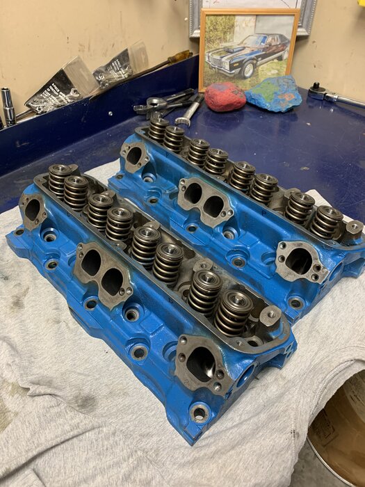

What a depressing day. Head gaskets are 6-8 weeks away. So, I figured I should throw some paint on and let it cure.

Ahhh Mopar Blue, gotta love that thing!
Holy smokes on the gasket lead though...what kind? Anything special or just regulast stuff that's just gotten harder to source given the current situation?

Compression will be figured out today. I’m going to measure .500 down in the bore. Find out what CC it has .500 down. Once I have this #, then I can do some math and figure out what my compression will be.
I already cc’ed my heads.
