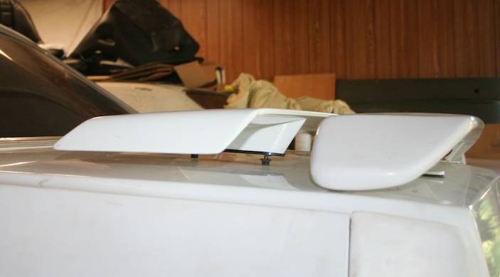

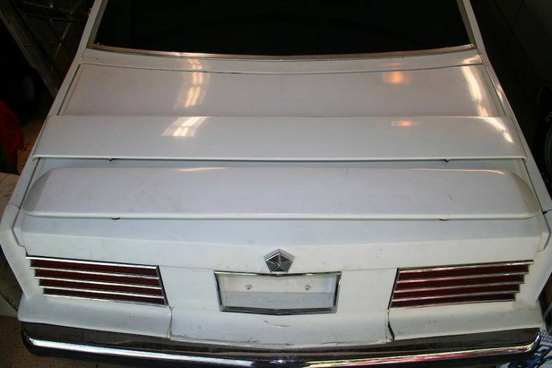

Still working on some other things, trying to get them done before it gets too cold out, but I picked up a gift for the 'Rada this morning. A wing from an '82-'85 Firebird. As suspected (okay, as measured), it will fit like it grew there. I don't have the Go Wing off yet, because it seems a couple threads are stripped, so it's going to put up a fight, but I think this body style looks WAY better with a more angular wing. I believe a couple other members have this exact wing on their J-bodies also. All the angles are pretty much perfect. Most people will assume the car came with it once it's in place. Score!

Thanks guys. Exactly. Something about that swoopy curvy Go Wing just didn't look right on a car with all straight lines. It's hard to tell in the pic, but the new F-Bird wing isn't quite straight, it's slightly V-shaped, which goes nicely with the shape of the rear window and trunk lid. To me, this is what a Mirada spoiler should have looked like.
Yep....I agree again.
Because the Mirada has such straight lines the Go Wing almost looks a bit goofy.
The F bird one should look sweet on there and I sort of see the V.

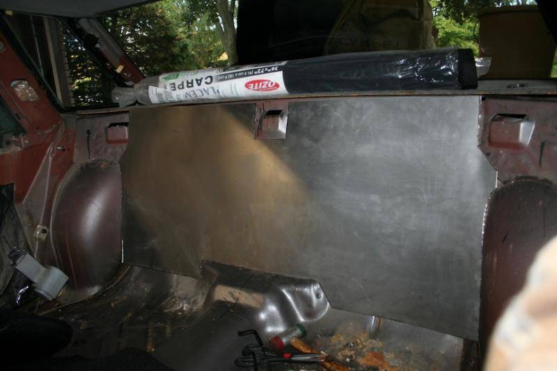

Finally got the firewall almost done, I had set it aside for awhile. Still needs some finishing touches, smaller holes covered, etc.
My wife wants her car back in the garage now, so I'll work on the door panel fitment one night this week, then the Mirada has to go on ice for the winter. It should go together fairly quickly in the spring once the new front suspension is ready to put in.
