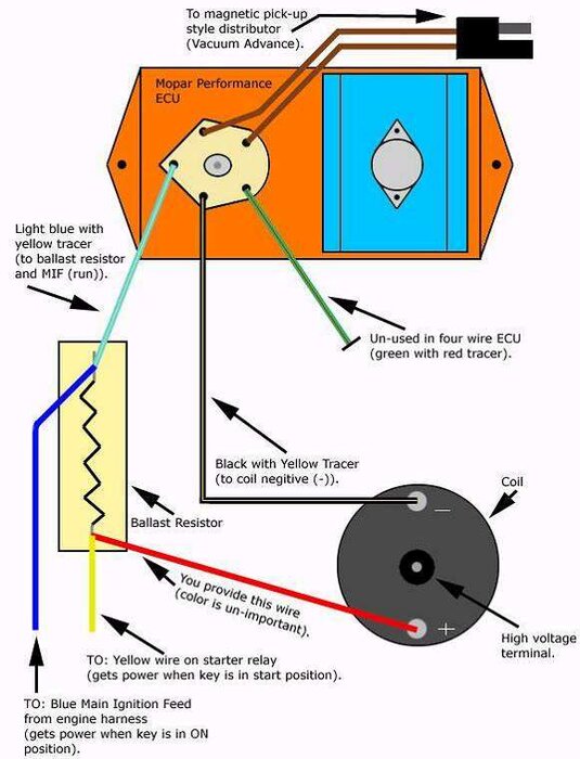

87 5th ave, i know the info is here but cant find it. i know the parts i need , i need the wire diagram for a color blind guy tks gjg

Colour blind...that is tough when you talk wiring since it's all coloured.
Here's the best pic I could find with added text:

tks I can use ohm meter to find wires this is a great help. I am getting a kit from ehrenberg , can i use my coil or does it need to be changed? tks for the help g j glover

Your existing coil will be fine. Regular electronic ignition and Lean Burn/Electronic Spark Control use the same coil. Doesn't apply but, a points system uses a different coil than electronic.
