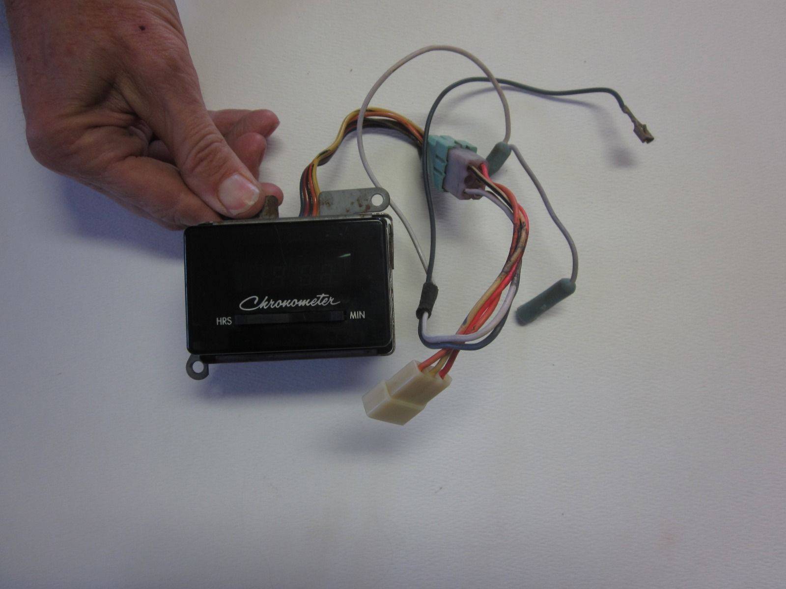

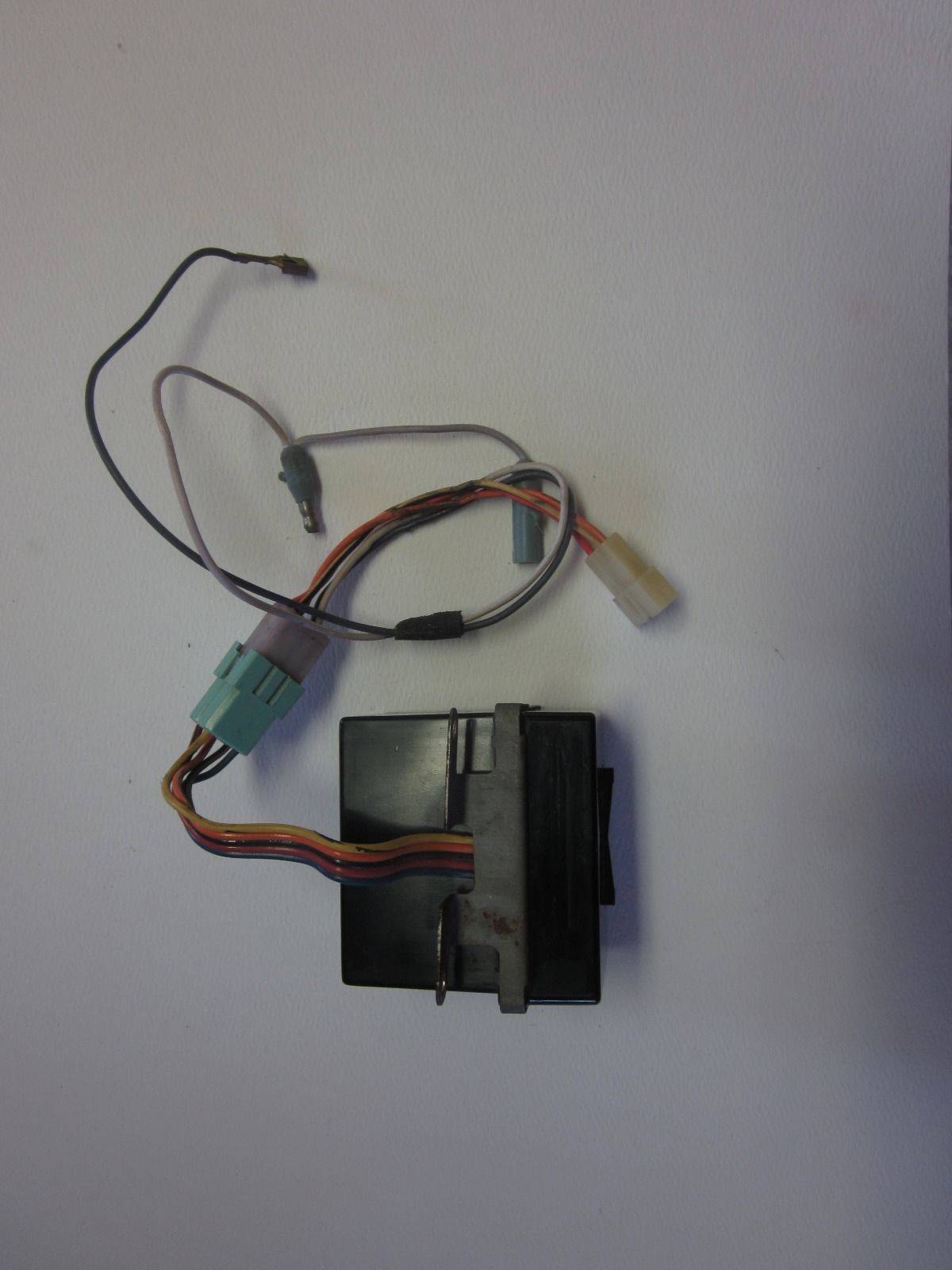

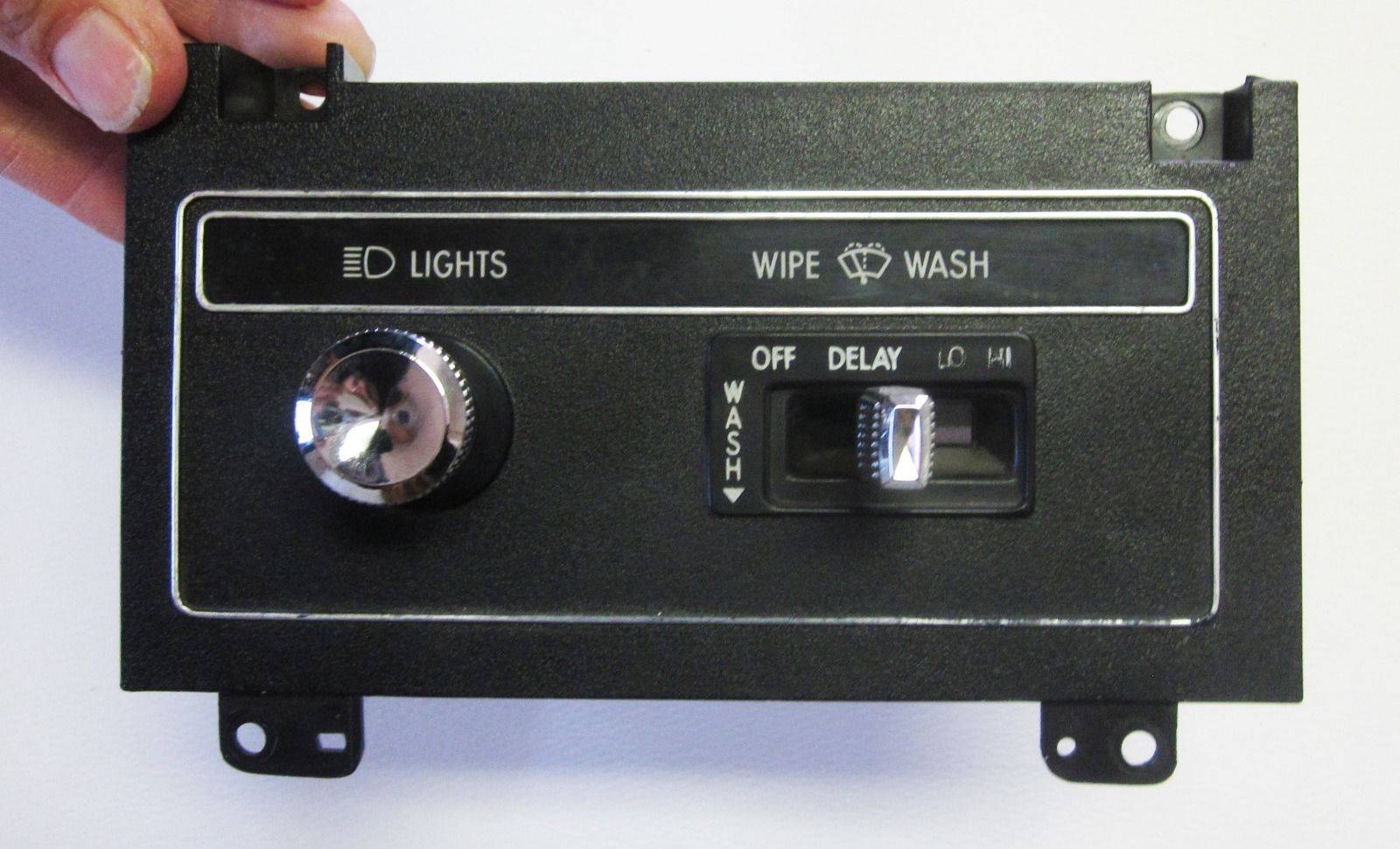

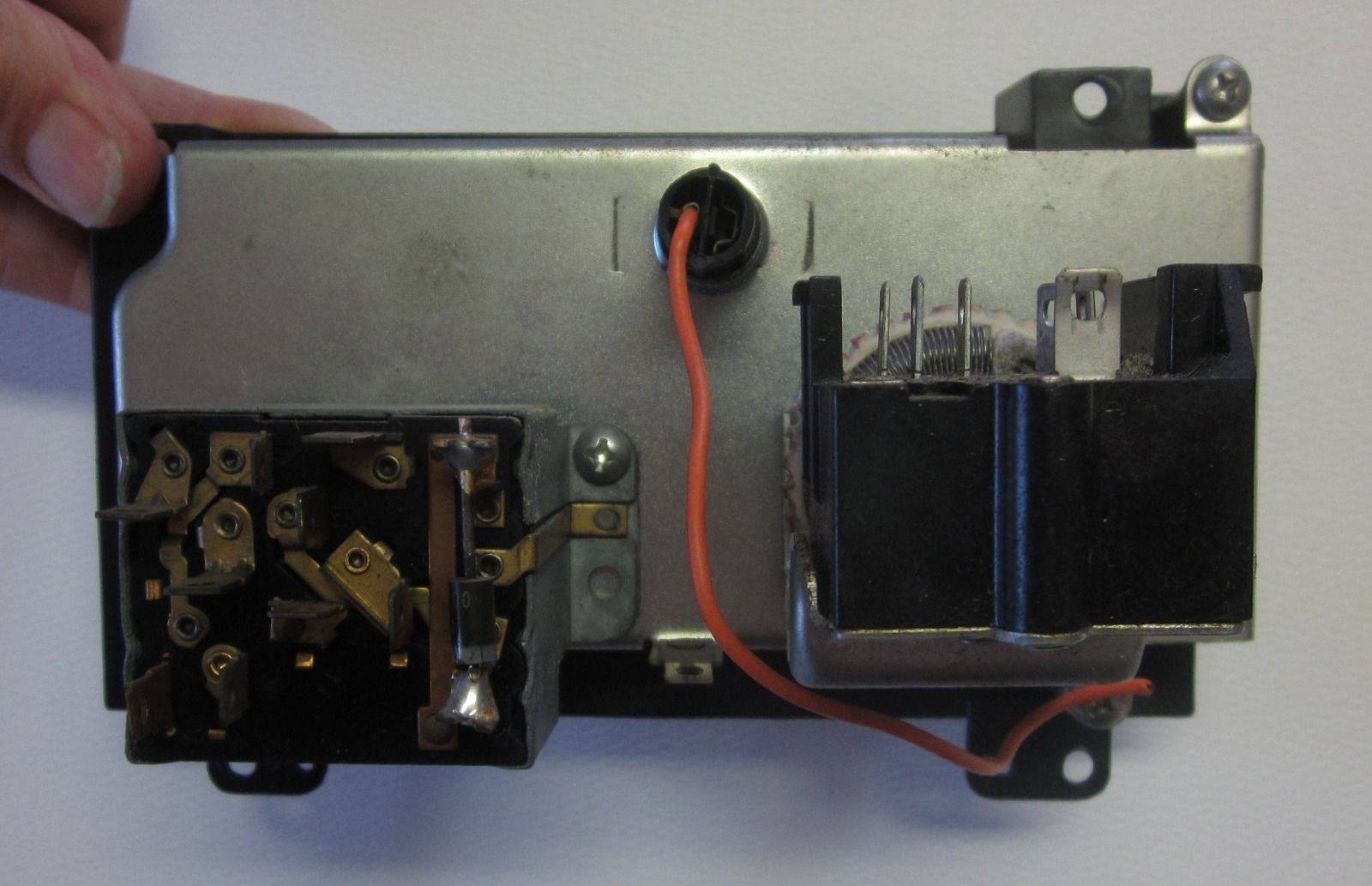

I bought a few things the other day off of EB that I had been wanting for awhile to upgrade OY. I found a very nice Chronometer WITH all the wiring still intact, and from the same seller, a DELAY wiper/headlight switch, also in very nice shape except for slight wear on the LOW/HIGH wiper indicator. Not really sure that OY even has the wiring harness for the Chronometer hiding somewhere in the back of the dash, but I'm sure I can make it work. As for the hookups for the delay wiper, I'm also not sure that it is simply a "plug in" but even if it isn't, it shouldn't be too hard to make it work. I remember buying an aftermarket delay wiper unit many years ago to convert one of my F's to delay, and it was easy. But if it will simply plug in, that will be great. Not that I would ever even drive OY in the rain, but, still nice to have I suppose. Still working on getting a mint unused ashtray from a guy I know, who seems to enjoy torturing me with it. Now if I could only find that three spoke Special Edition steering wheel that is sitting out there waiting for me somewhere!

Anybody know how to repair those clocks, or anybody who does it? I have one working one (81 Mirada CMX), and two non-working ones ('80 Cordoba, 82 Mirada ase). I like how the one in the CMX looks, so I would like to get the other two going.

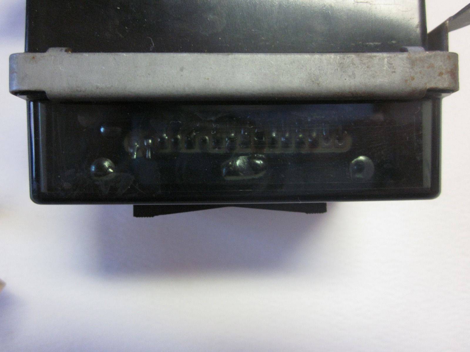

It looks like the unit can open up by bending the taps up on the surrounding metal bracket that attaches it to the dash, but from what I can see inside through the plastic, there is just a small circuit board and the LED unit. Not likely to be much repairable in there. Best bet might be to find another working unit, but check to see if it might be as simple as a loose or grounded wire first. There is an NOS unit on EB right now, but it is $99.00.

Does anybody happen to know if all the F's had the wiring capability for the Chronometer? OY never had a clock at all, but I wonder if the wiring is back in the dash somewhere. Also, has anybody replaced the two speed wiper unit with a delay wiper unit? Is it Plug and Play, or does it have to be rigged? I can't get to OY to find out right now due to a high tide of garage crap.

Voice Of Experience Here! That delay wiper switch will not work in your car. The wiring will not match your current wiring connector. You can rewire your system to work high speed only with this switch, but you will never have delay. To have the delay function you need the delay wire harness, and the external intermittent wiper delay module.

One thing on the older analog digital clocks. 95% of the time when they quit working all you need to do is pull it apart and clean the contacts on the auto-rewind mechanism and they'll start ticking away,,,,,,,,,,,,,,until the contacts go bad again.
