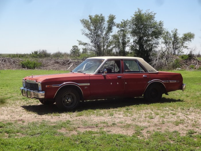

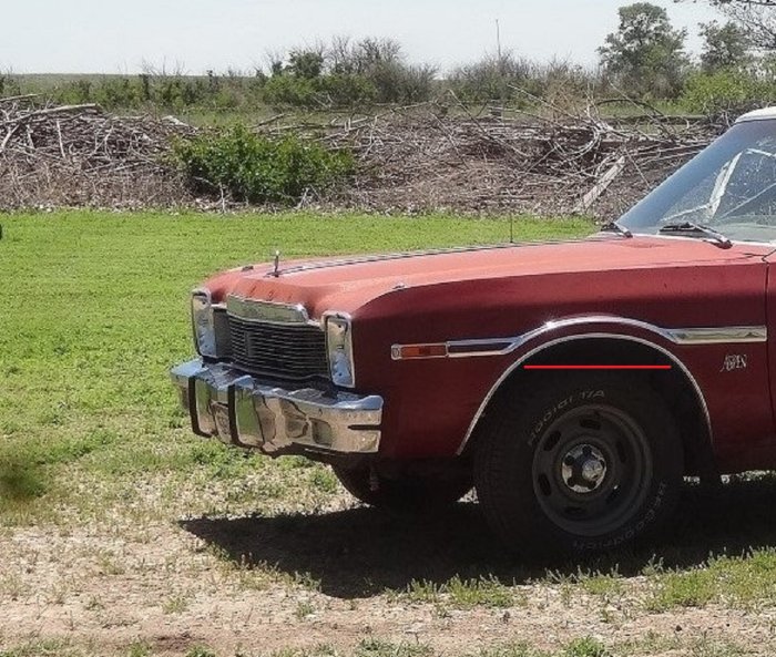

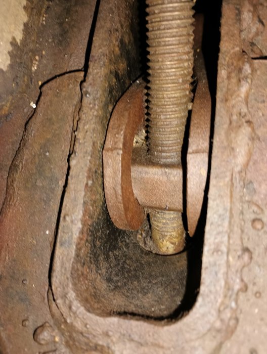

Here is for reference. Maybe it will help.
318 ac car with a 235/60/15 and just at like 5/8 thread showing and its got over 4 inches from top of tire level to top of wheel opening arch. Might be a bit high for proper spec, I didnt set these this high.

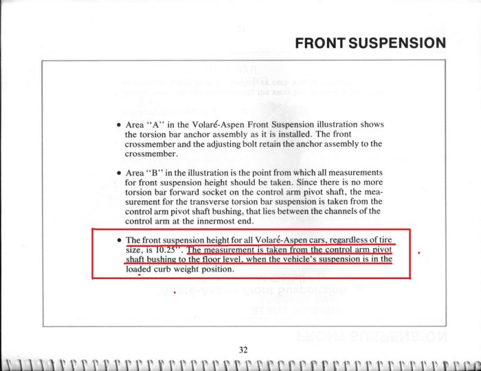

The info manual says where it should be and this was done along with the 5 mph bumpers to have STD. for bumper heights across all lines in hopes of having more bumper on bumper slow speed bumps vs grilles and tail lights getting broke out at even the slowest of speeds.
Clocking one notch is possible. OR they could just be worn out.
