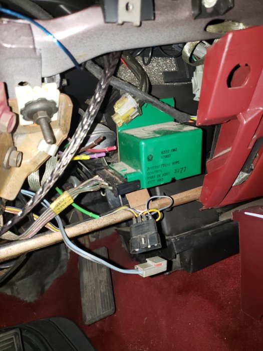

Also any idea what those two connectors flapping in the wind are for as well?? Stock stereo that is long gone maybe??

The 2 loose connectors are most likely for something the car never had. Just glancing at the black one and it's wire colors, I'd guess it has something to do with the dome lights, or maybe a map light, etc...

My ’86 Fifth Ave has a radio amplifier button on the trim under the steering wheel (the one that is removed for your picture). I think it is a 4-wire connector (would need to look) like your black connector. The amplifier itself is located under the dash pad in middle of dash (where the single speaker (low end radio) goes). I don’t think the radio amplifier was an option for ‘88’s
The two-wire gray connector – I’m not sure. I would need to find and look in an ’88 FSM (Factory Service Manual) to find out – which I don’t have. It looks like the wire that goes to the lamp by the ignition key on my ’97 Dodge pickup (which uses a different style column).
