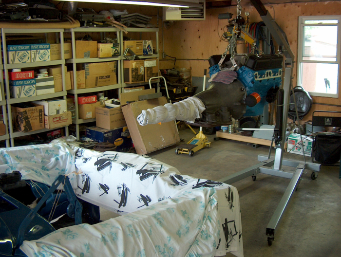

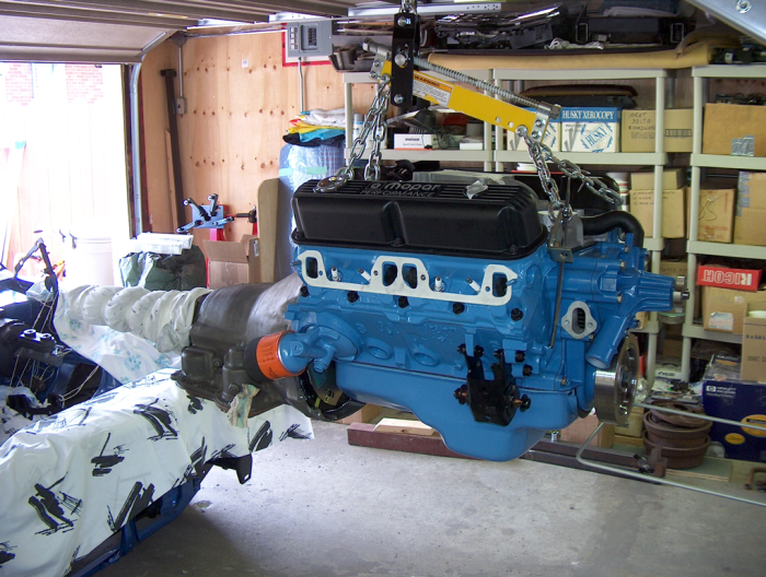

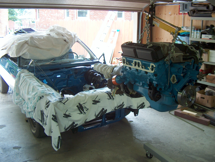

You can do it, I did that with my M-body install...the key here was:
1) crank down the T-bars as low as they'll go w/o compromising the ability of the suspension to hold the weight...this may be a step-at-a-time kind of a thing, meaning: crank 'em very low at first, then as you prepare to actually bolt things up you bring up the T-bar tension so that the added weight of the assembly does not bottom out the suspension
2) use the engine crane adjuster/bar with a tilt, that way you can 'navigate' the engine_trans combo through the front header and floor tunnlet gauntlet
Without that tilter I do not think it would be possible.
These are the pics I took...hard to believe it's been nearly 20 yrs now...holy crapola!!! lol

...I always found those plates that bolt to the carb flange somewhat questionable...
I actually have one of these as well and contrary to the look it is pretty rigid. The W2 408 stroker install was done with that plate...no complaints!
...I noticed you didn't install the headers / exhaust manifolds. I assume you were able to squeeze them in with the engine in place?
Actually, take a look at the 2nd pic and you'll spot low on the driver side the carefully wrapped header flange...lol, yup, I tossed the pipes in there, got them nicely covered to avoid scratches, or at least lower the total count (b/c no matter what I tried I always get a few). This worked surprising well...yeah, still took a little persuasion and a step-at-a-time approach, but overall I would much rather do that then try to toss these in place afterwards. What helped the most here was carefully hanging these in place...so various lengths of strings holding these up into an 'almost installed' position.

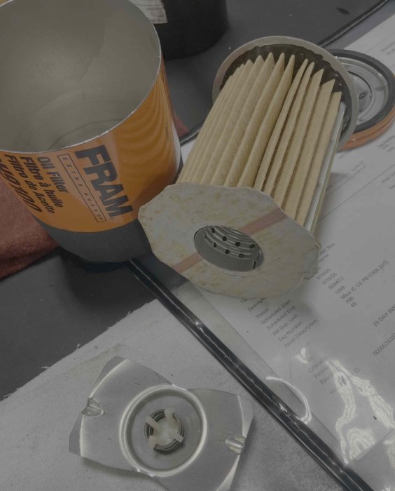

A long time ago I was bored and cut them all open. It looked to me like the Wix and Napa gold were identical. The Fram was pretty bad. Paper that just falls apart. Mobil 1 was good. Most were. Baldwins are good. Actually, I would use most of them but the Fram. Never did cut a Purolator open.
