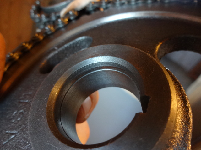

Alot of the newer gearsets, like this SA gear street double roller deal has a bevel then a wider step before the correct ID the cam nose seats on.
If yours dont and it just a 90 degree you could take a small round file like a chain saw file and just put a tiny bevel on it to give it a glide path to start on correctly.

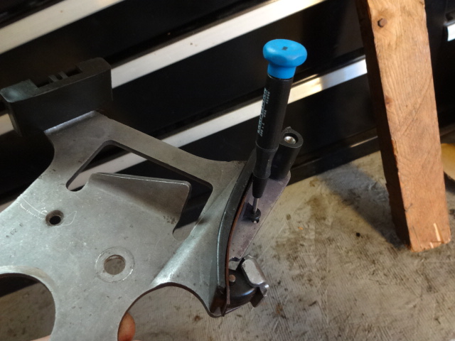

Remember if you us something other then the oem pin on the nylon part you can get it over just a hair furtherand it makes it easier, a small punch or a small diameter screwdriver (like a jewelers or a carb related one) wont bend and is long enough to leverage it over for just a hair more room. You cant use a nail or such it will bend, there is good tension on that nylon part.
1,633
425
Here is getting rid of the oem pin, with the punch or screw driver you can get more wiggle room, esp if you have a helper who can pull on the screw driver, in a pinch ive tied a string to it and tied off some tension.

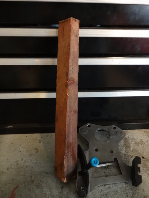

And my ref, to a wood block, this is my wood :0) not super big but works. Its not like im using a 4 ft 2x4.

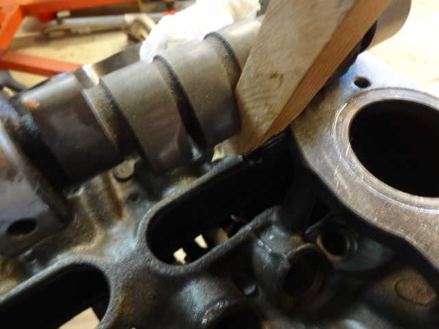

1st pic, wedge cam so it wont spin or move back. You wedging the wood in simply by hand, no harm will come.

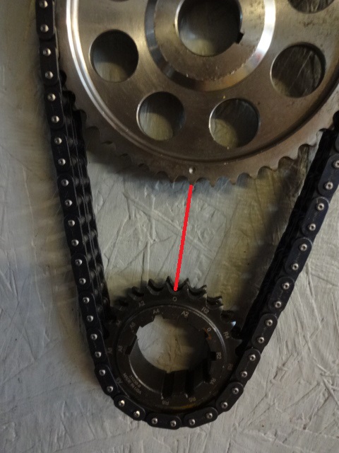

2nd pic make sure your crank and cam is in the proper orientation.

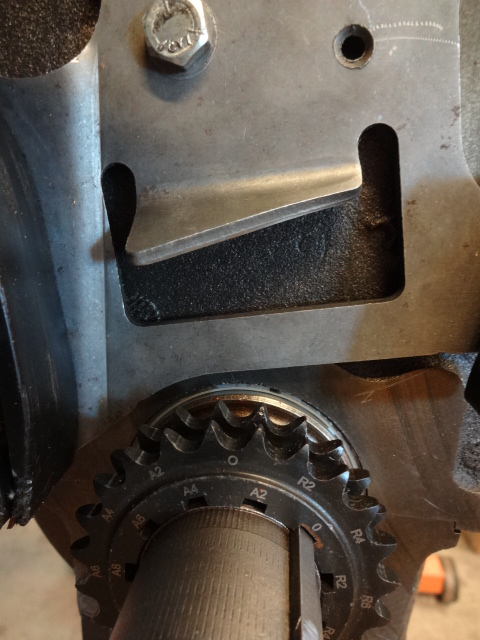

3rd pic take gear set and set dot to dot or how you plan to install. (I soak chain overnight) then wipe as clean as I can get it.

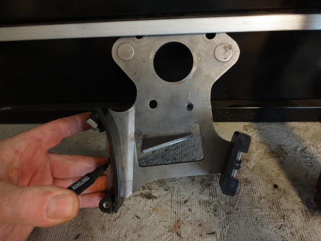

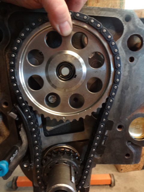

4th pic If you have a friend to pull the lil screwdriver over great, I used some wadded up old door rubber. And you can see it all slides on and if the cam was there its dead on.
Also put a touch of lube or grease behind the tension plate where the cam rubs before install.
