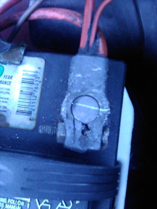

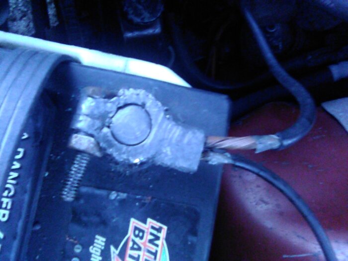

I'd also like to replace the terminals, what's the best way to do that?

Although they do not look too nice, I wouldn't be too concerned about them, as long as they tightly grab on the battery.
You would need to identify where (how long) the wires go to and how they are connected and get appropriate replacement.
Especially the thicker wires should not have additonal and mostly too small connectors inbetween.
There are generic terminal connectors. You'd just fasten the blank ends of those existing wires in them. Have no pic ready, but someone might chime in. Positive and negative at the battery have different sizes.

AS long as they're not cracked, they tighten to the posts good, and the wires aren't corroded or loose in the terminal, good to go. The clamp on terminal ends are OK as a last resort or for temporary use. They do not hold up well. Some are better than others but none of them are all that trustworthy (JMO).
