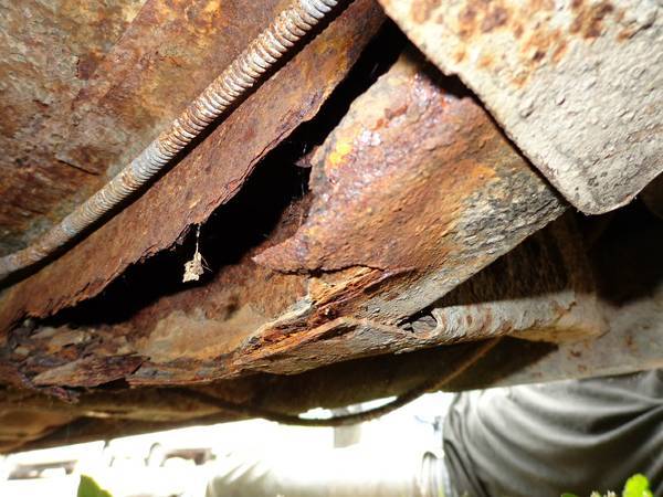

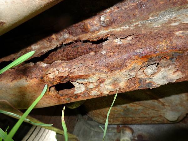

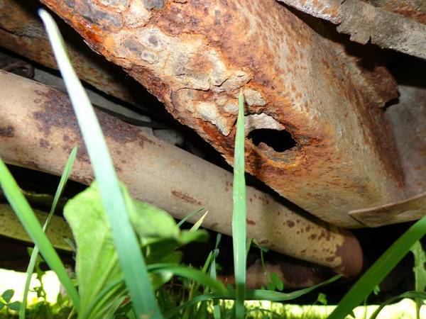

Alas, it was not meant to be this time. I looked at the areas mentioned above and first noticed the front frame rails. They looked very similar to the picture old yellow posted. Maybe not as big of holes but spongy. There were also a lot of rust holes behind each tire on the body. I just don't have the skills to repair that kind of thing.
The interior looked very good, though, and the grille looked ok. No idea on the motor other than it's a slant 6. The car was covered in snow and I didn't brush off the hood and open it. The tags were from 1999 so I'd guess it's been sitting at least that long. I wanted to say thank you again for the helpful information, and I'll continue my search. Who knows, maybe an F body is still in my future!
