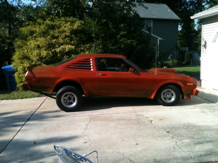

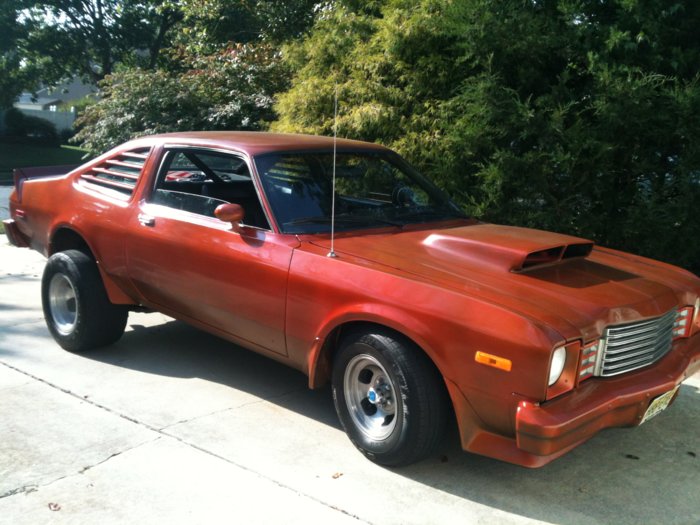

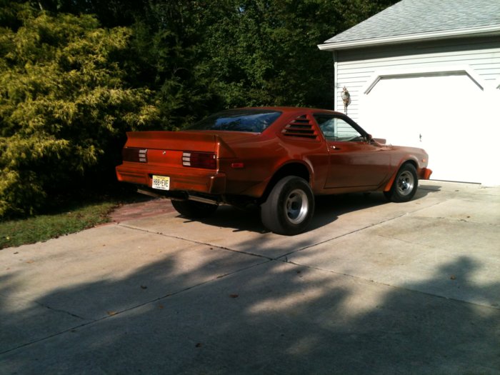

Does this rear look too big?
Finally got the big 8 3/4 rear in with the 6 leaf springs. The 742 case had the small 7260 universal and the driveshaft had the 7290

I'm thinking it would be very easy for someone to get a chain wrapped around that axle when you are sitting still...
Growing up in the 70s, I remember cars just like the Mattel Hotwheels rolling down the road. Side pipes, Slotts, and Jacked to the sky in the back. Just like Deep Purple's Speed King and Highway Star. The 8 track is in my 79's dash and my 77 has a NOS 8 track too. The 77 is going for a more low key look. The 79 is all "Full Tilt"

Slant - What ever spins your wheels man! If havin the arse jacked up to the heavens does it for you then run with it! Just play Low Rider by War on your 8 track! :D
I like the 100 spoke Chrome wheels on my doba but other people don't, its what rocks your boat fella! If you want to look like a Mattel Hotwheels toy them knock your soxs off! Its what ever wets ya noodle!
Now, you need a sunroof, with your shifter handle sticking out of it . . .
My though, it is a couple inches higher than I would like for it to be – but it’s not my car to say much about. If you like it, then who are we to say otherwise.
If you plan on keeping it that way, I would recommend getting some rear shackles for cars with rear sway bar (ie: police) which will make rear of car more stable.
If you can’t find any, then send me a PM.
BTW, if a lady asks you that question: “Does this ___ look too big?” (too fat, is another key word), you need to quickly change the subject or quickly depart the room.
THERE IS NO “known” answer that will keep you out of hot water!
1,965
420
i think it is too big. Maybe not the shared opinion, but there it is.
The rear jacked up that high does some undesirable things to the front geometry (caster gets thrown out the window, to start with). My early days, riding around on cars that were substantially jacked up, brings to mind a lot of rear end skipping around, or not feeling very solid, as well.

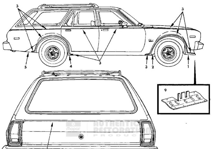

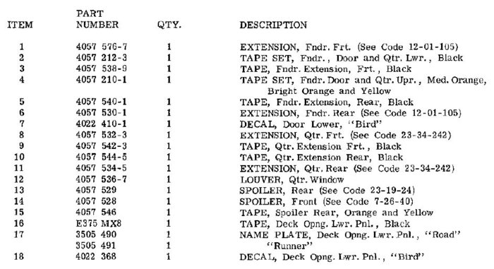

I attached photos of a ’77 Road Runner:
Item numbers 6, 8 and 10.

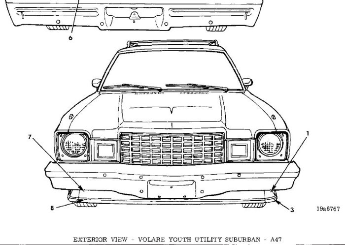

And a ’79 Volare Youth Utility Suburban (almost the same as Aspen Youth Utility Suburban) AKA: the “Load Runner”.
Note Chrysler called most of their wagons “Suburban” – but you won’t see that word on any of the vehicles themselves. I’m not sure if a copyright issue, or why.
All of the part numbers are different between ’76-77 and ’78-79 (not sure about ’80) – but the fender flares will interchange between the different year 2-doors and 4-doors just fine (except not sure about '80).
Note: there is no front spoiler or flare information listed in 2-door section for Volare or Aspen. Only the rear spoiler information is listed. The front spoiler and all fender flares are only listed on the Suburban section – which makes me wonder a few things.
