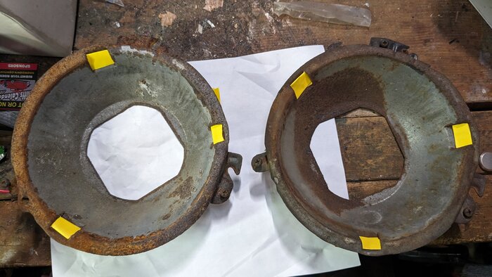

Helps to use the correct bucket left and right to get the lamp clocked

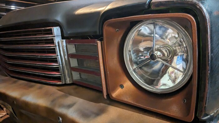

Slick. Where did you get them?
Local seller had them with a hotrod that was never installed. He went OEM on the Hotrod. 20 bucks new in the box but warning these draw way too much through 40 plus year old circuits, so a 40 Amp rated relay is a must. with lamp pigtails and a direct power feed from the battery to the relay switch contacts. The relay coil is switched by the factory 40 yearold circuit with very minimal current draw.
