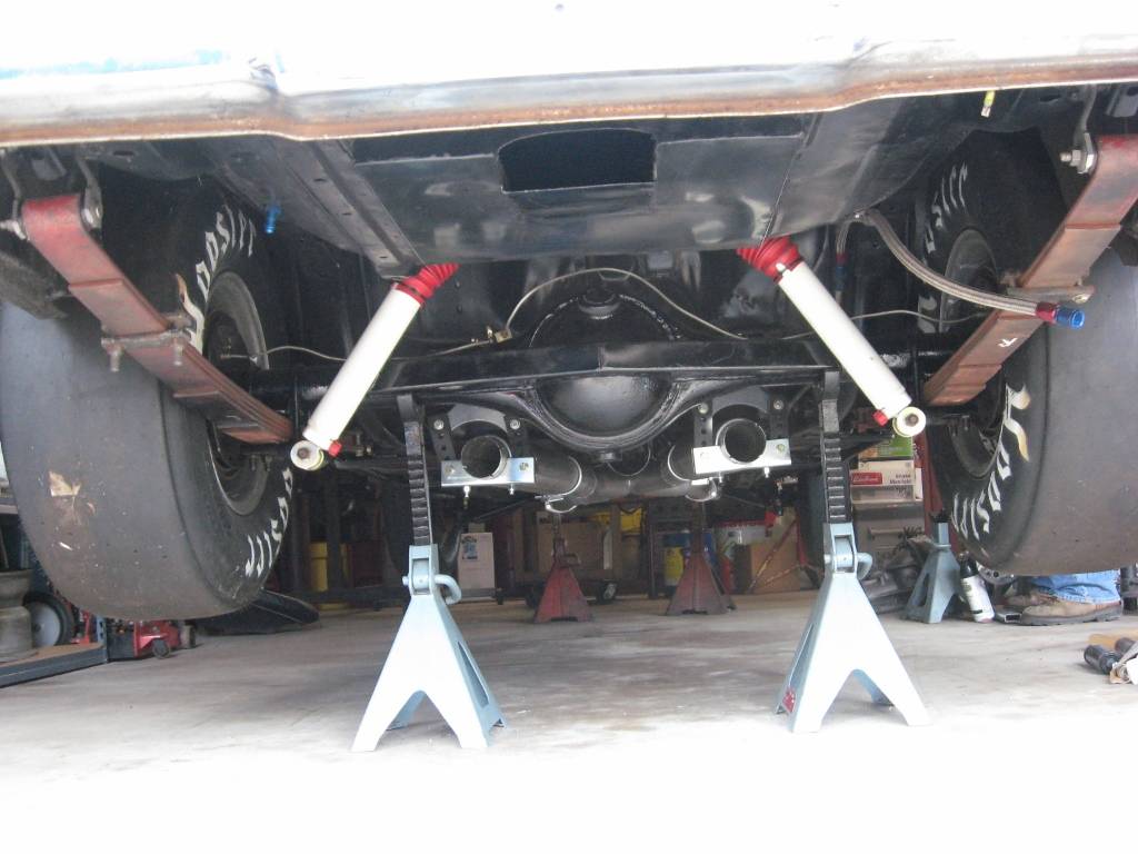

I think I got it!

I think I got it!View attachment 12345
The spring pad holes are .44" wider on the F body than the B body.If your still running NHRA, that offset shackle is illegal. I also got bounced for using a Firm Feel front hanger and an E body HD leaf spring. I remember at the beginning of IHRA CM class, they allowed the spring relocation kit but frowned on it a few years later on any new cars that were built for the class. I opted for the CalTrac system since it is designed for the F and M body. I also thought that sometime in the future I would change class from N/SA to H when I got tired of running the 318/4. I missed the '15 season with some head/rocker arm issues.

Thanks. I'll have to do some more research because I've heard both sides. I was interpreting the rear OEM mounting point as being on the frame because the shackles themselves are not the "bracket" or in a "fixed" position. The aftermarket bolt-on adjustable stuff today is more sophisticated than what SS use to have not that long ago.
I was an early IHRA crate motor competitor and have the full 3/4" offset kit on my Dart. But I'm investing in the Aspen for NHRA hoping for more "opportunities".
