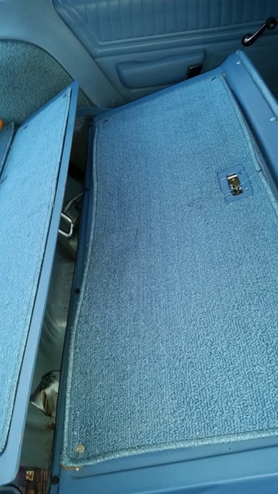

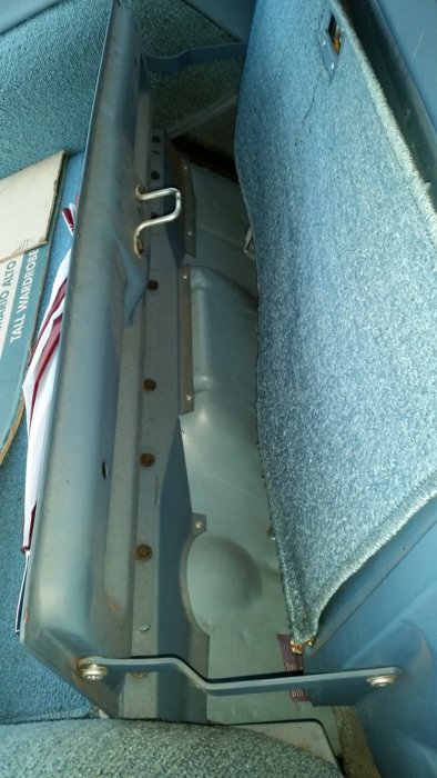

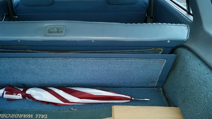

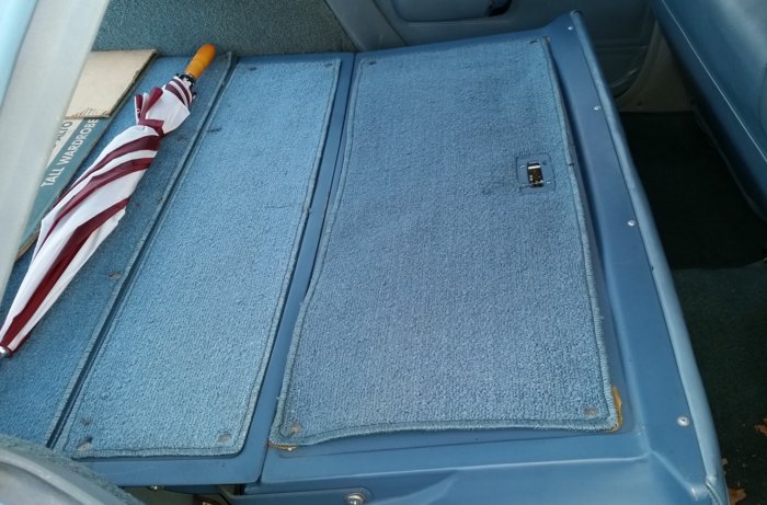

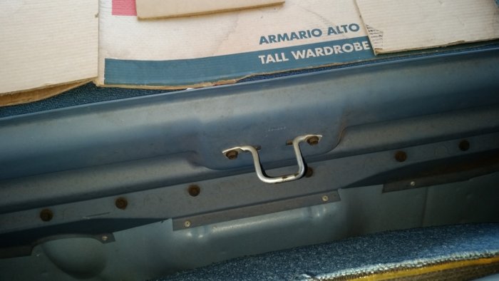

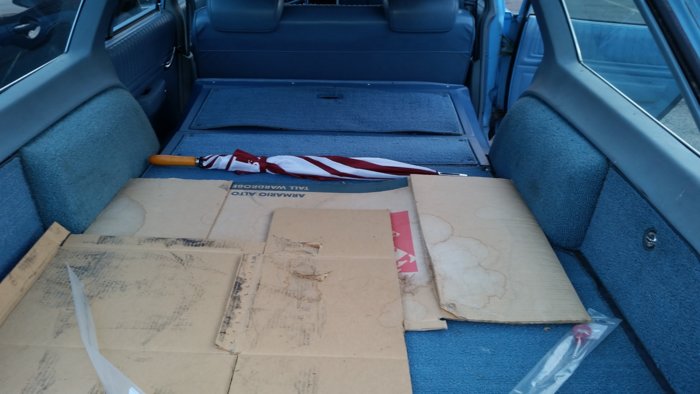

I just so happen to drive my wagon, today – so I went out a too few pictures.
Unlatched and seat forward about 20 degrees. The floor pan/trunk pan is the same as sedans.
Open a bit more.
Just before seat latches.
Latched.
rear view (ignore the poor mans carpet protector I'm using).
I’m 90% sure the seat bottom is the same (wagon, sedan or coupe). The seat back is not.
I’ve not compared them, but was told the wagon seat back is the same as what is used on 2-doors that also use fold down seats (but that is not confirmed).
There is one seat button (top and center) that controls two different latches.
The seat folded down does not sit flat – because of the seat bottom (foam/spring) compression. You put a little weight on it and the floor will be almost level.
In this state (as pictured), it is a bit higher in front than the rear half.
The complaint I do have about the F & M-body wagons is carpet (not staying on/attached) as well as a huge place to lose things in the cavity behind rear seat bottom.
Then again, that spot might be a great place to hide things (maybe).
In my case, it appears to be hiding trash from my kids.
