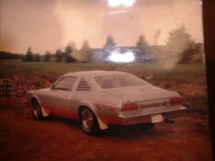

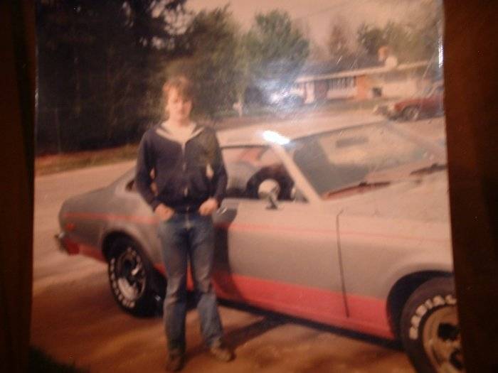

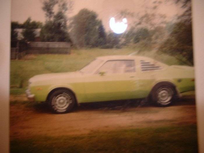

For reference, this is my car in it's previous lives (silver is late'80's, faded out puke green is early '90's) with the 205/70R14's. (Same tires, just different wheels) They filled out the wheel openings fairly decent. Just for the heck of it (first pic) same tires with Keystone's around 1987. (Who's that long haired YOUNG guy? LOL)
Bad pics being digital photo's of print photo's but you get the idea.

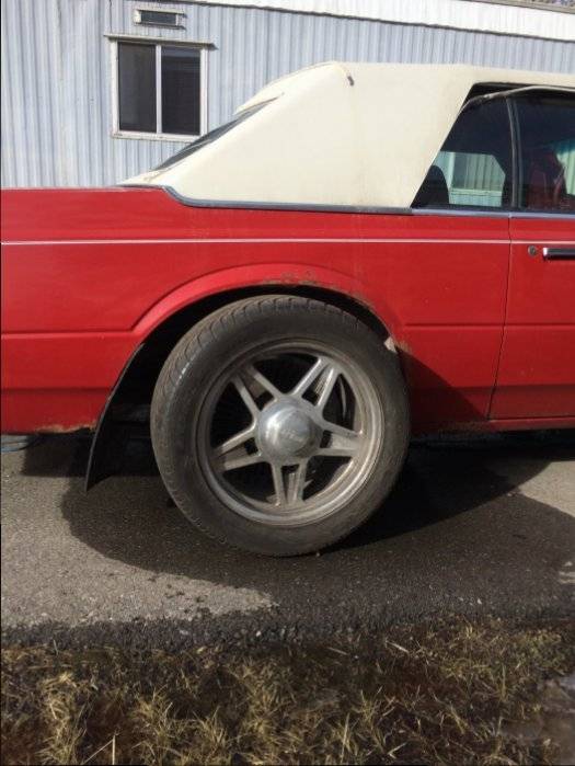

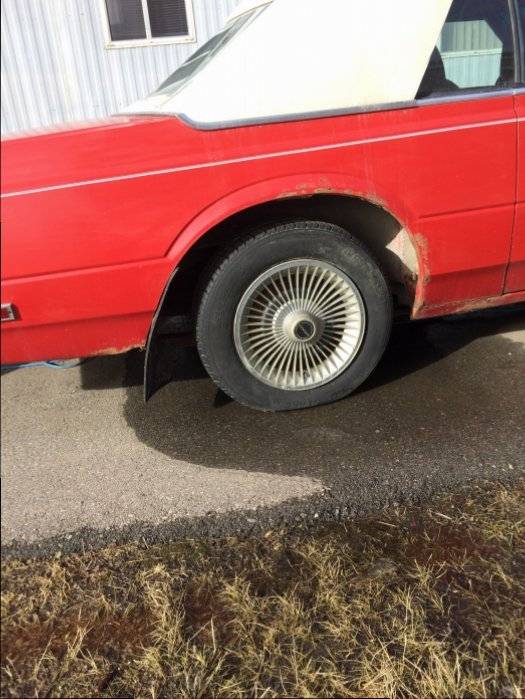

I have a 1981 Mirada CMX. It has (for now) the factory steel wheels with the turbine vane hubcaps. Tires are 20570 R15s (factory size, I think). They look like this:
I also have a set of Weld Forged billet wheels left over from my 1993 Lincoln Mark VIII. They are more of a front drive pattern (5.5" backspace). Very nice wheels. i Just put them in front of the factory wheels to see what they would look like. They look like the picture at the bottom of the page.
I am thinking of getting the proper spacer/adapters to correct the backspacing and also the bolt circle issue (Weld wheels have a 5 X 108 mm bolt circle, so have to correct it to 4 X 3 1/2"). I don't know if the back spacing should be corrected to 4", 4.25", or 4.5".
Anyway, the point of this is that the older cars can look fine with larger wheels/tires, as long as they are not excessive. I know a guy who has a 55 Chevy with 20" wheels and rubber band tires. That doesn't look rignt; a less extreme wheel (say 17" or even 18") would look better.
