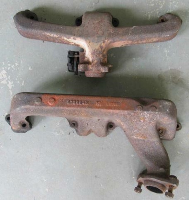

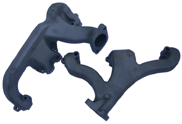

Most of the A-body's had a flat flange at the exhaust manifold (which required gaskets). I “think” in '72 (or so) Chrysler got rid of the flat flanges and went to a ball design (gasket less) that FMJ V-8's use.
If you could find some late A-body (340/360) – then I would think they would fit and work well.
I take that back, the drivers side A-body exhaust manifold went up and over the steering gear – so scratch that last sentence.
340 Flat
A-body ball design

Most 318's used a ball design. All but the late 340's used a flat design. 360's were ball design – but difference was with the A-body Left exhaust manifold exit.
