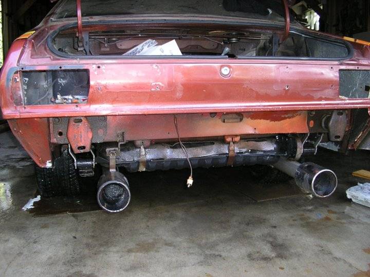

Still going to hate cutting off that 3" dual exhaust the previous owner put on. It does have magnaflows, maybe I can salvage them. But, it got to go.

When I got the car from the guy, the exhaust was hooked to stock manifolds too.

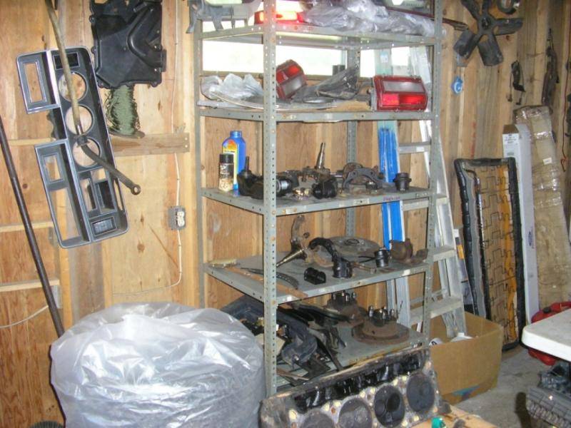

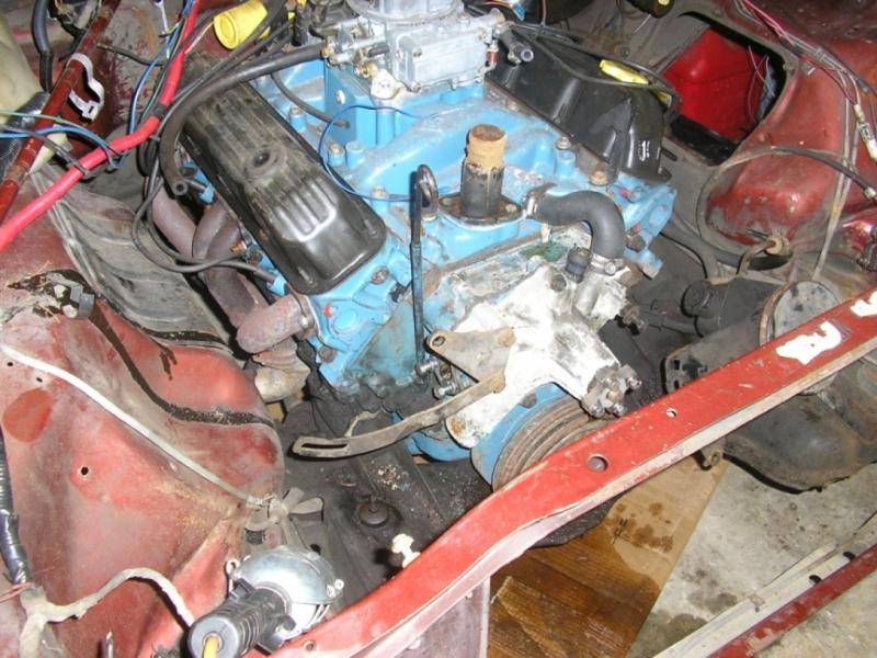

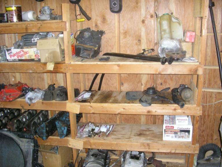

Slowly chipping away at getting the engine out. Going with the first week of October for the engine/trans pull.
Aspen body and suspension parts waiting.
Filling up the other shelves.

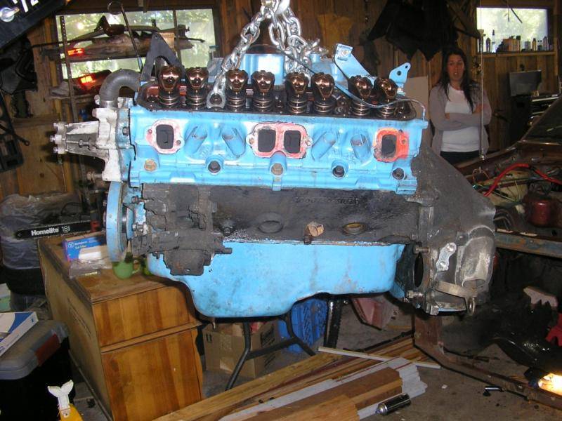

That's one of the "high" performance water necks.haha. Glad to see you're on your way. Aint it fun?!

It was off one of the magnum engines I have sitting in the garage. Had to use it in a pinch a few years back. An LA one will go on the rebuild.:icon_biggrin:

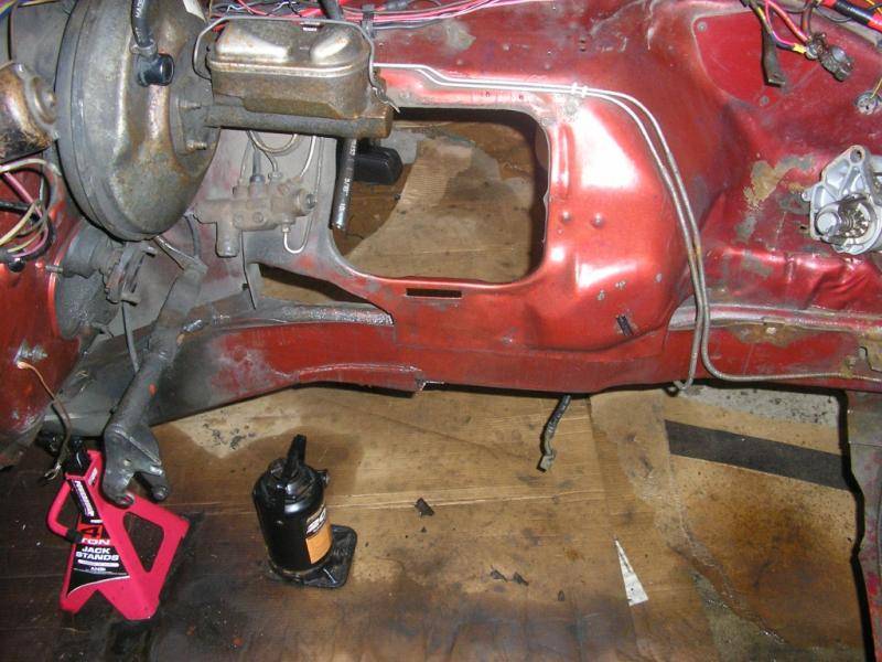

Got the shifter, linkage, z-bar unhooked and driveshaft out. Going to fart around tomorrow taking the centerlink off and undercoat scraping. Engine and trans will come out next week.

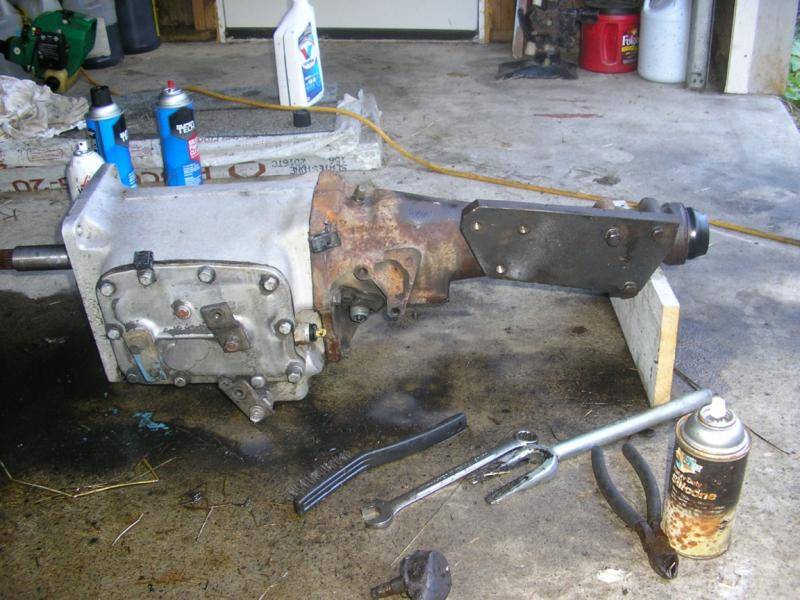

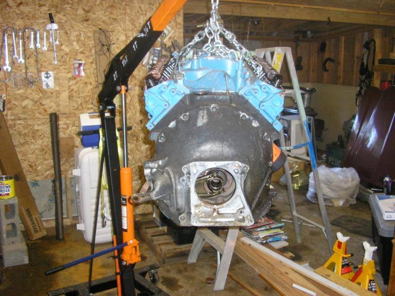

Cleaned up the trans a little. Aluminum case w/cast tail shaft. *Shrugs*.... it works.

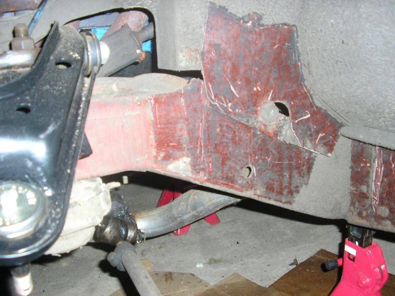

K-frame is out. Looks good, just some areas around wear the bicuits were. I am thinking about rust bullet on this thing. I dont think the VHT all weather will hold up. Any sugestions other than powder coat?
Same for the framerails they look fantastic. I ll post some pics when there cleaned. I just dont know if I want to rust bullet the outside frame rails. Def the eastwood frame stuff for inside of the rails.

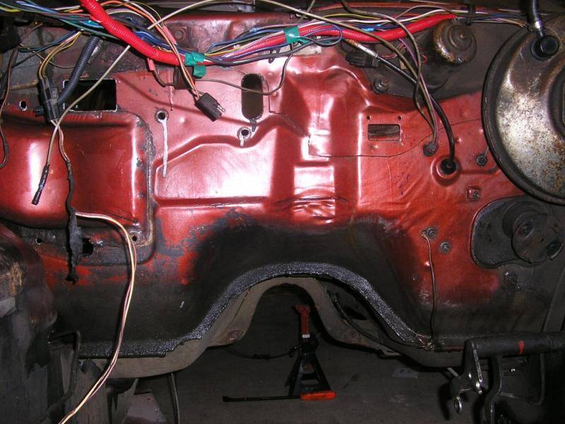

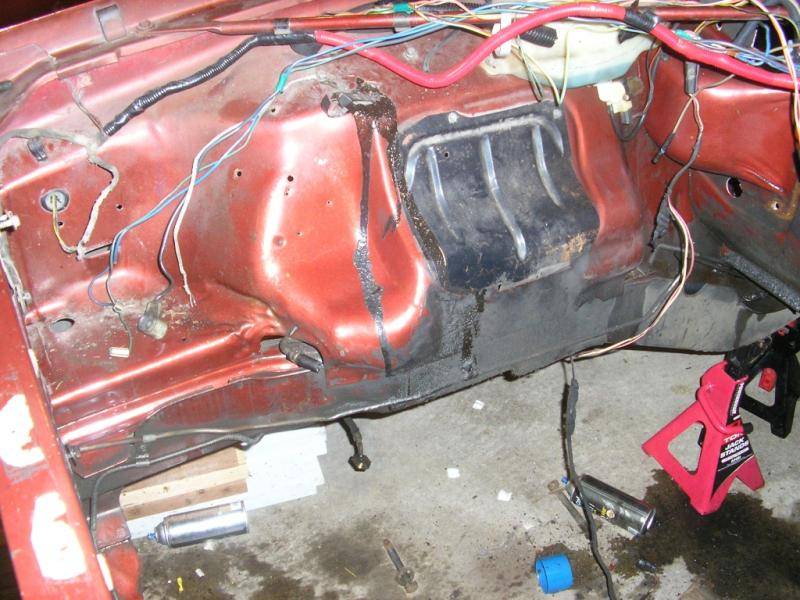

Took a break on cleaning the K-frame. Started to fart around cleaning some gunk out of the engine compartment.
246
If you can stand the fumes get you some MEK at the Depot and it really helps removing the grease. Watch out cause it will remove the paint also.
