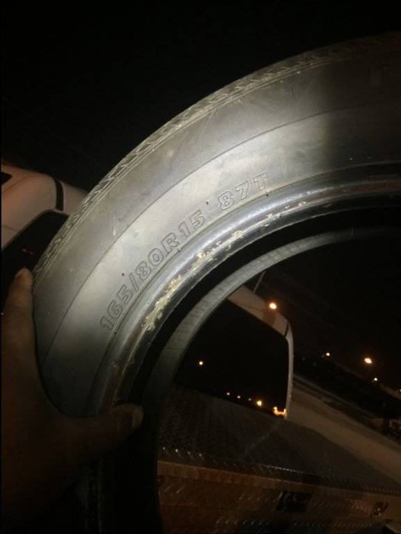

can anyone tell me how tall of a from tire I need for clearance of the heads on a 1979aspen.
Will this work

That 165/80R15 is going to be short and skinny.

25.39" diameter, for use on a 3.75" wide rim........
Header clearance??
With a 15" rim, they will clear the calipers.

Actually the '87' is the load rating (1,200 lbs) and the 'T' is speed rating (118mph).
