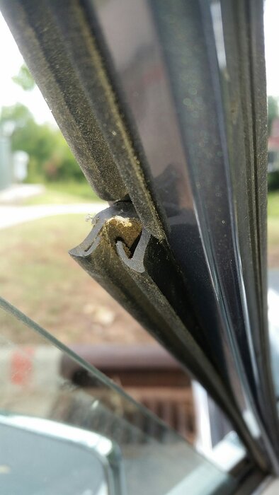

The ones on my '86 Fifth Ave are extremely hard and L/F is broken. Five years ago (August 30, 2016), I pulled this part out and took a picture:
I need to get some myself, so if you find some, please let us know from where and how much did you use (per door), please!

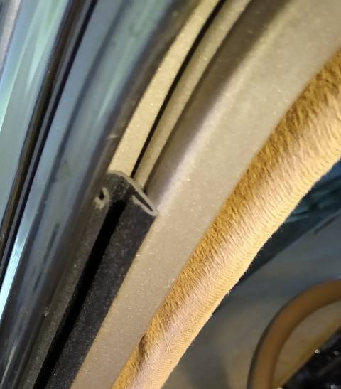

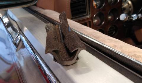

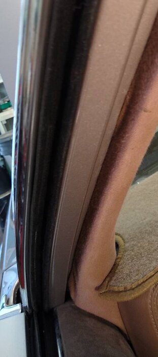

1988 Chrysler 5th Ave glass run channel update: The total run inside the door is 77 inches. The pair I bought measure 97 1/2" long each. Carparts.com Part no. PRP750566PR , total delivered cost for the pair $25.44. I installed them today but have not done a test drive to see if there is any wind noise. It took a couple hours as the old rubber was brittle and had to be carefully removed.
Photo 1 old piece broken out. 2. dry fit of new piece 3. new channel installed.

I did a road test when I finished the drivers side and no noticeable wind noise like I had before. Passenger side completed today. It took less time doing the passenger side, but working inside of the door was no better than the drivers side. Last test will be wind noise check on the passenger side.
