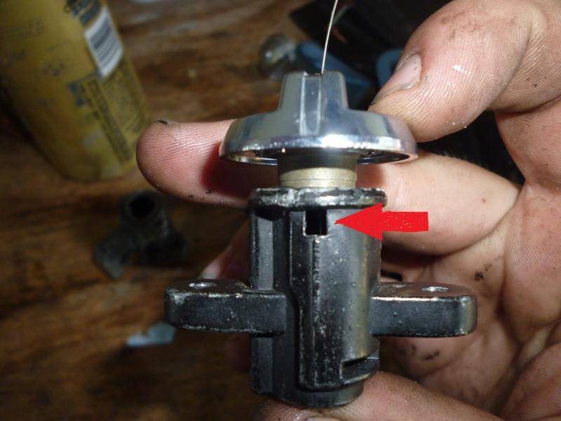

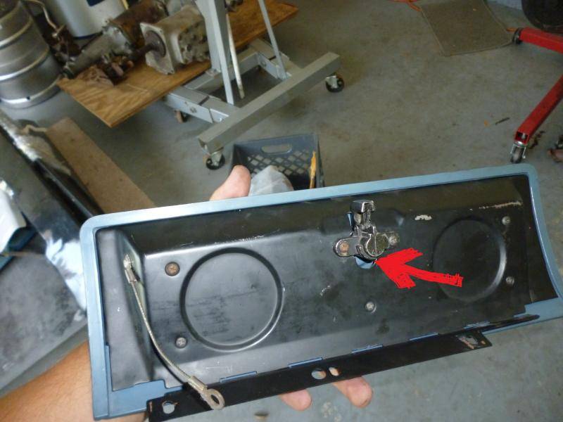

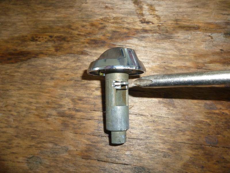

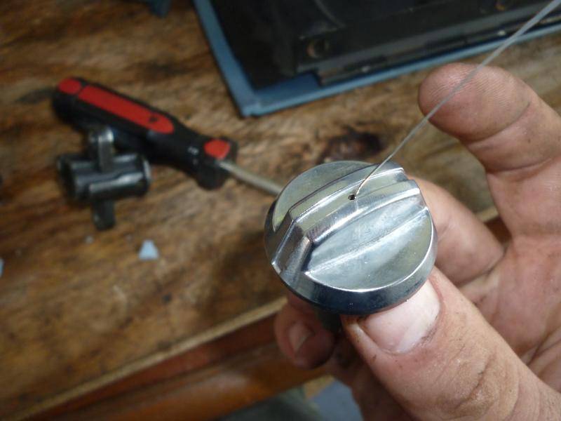

If anyone wants to know how to disassemble the glove box door to replace the front cover or latch here is how...
In the case of a locking latch, I believe the key takes the place of the wire.
