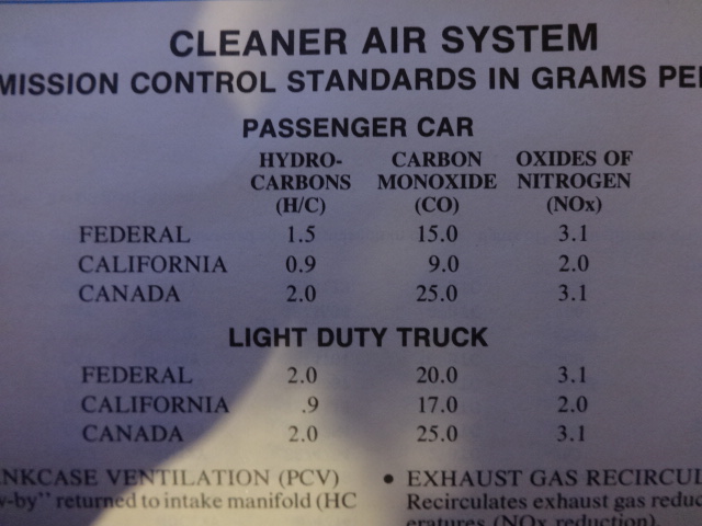

And to make things ever odder, the US had a set. std on emissions as well as goofy California and even Canada had std. of its own.

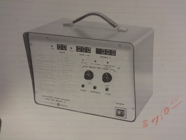

But the main hurdle for the common guy would be you would need the test equipment that the dealers had, and for example this very first version made fuss just at the price alone to the end user, $750 in 1976 money, like $3500 today.

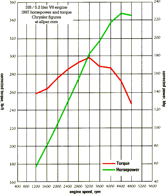

Below is a 5.2M curve. This is not what's in your FA. But it's all I got. If you multiply any/all the numbers below about 3600rpm, by .60, you'll be close enough.
So compare the POWER difference from 1200 to 2800. I read 100 versus 155, and times .60 =60/93hp, which is Plus 55%
In torque that is 260 vs 292;
times .60 = 156/175 or plus 12%..
So out the back door, in torque, that is 1.12x1.47= plus 65% ftlbs into the rear axles.
