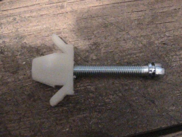

So I ordered 8 of these from Rock Auto, Dorman Parts that supposedly replace the Ones in there currently that are shot to hell. Replacing them in the Diplomat and I have pushed 3 of them in so far and each one of the wings have broken off on each of them before they get fully seated. As soon as I press down on them (with my thumb, not a tool) the wings snap off and then it slides through the hole.
Am I doing something wrong???
7,085
I doubt you are doing anything wrong. If they're Dorman, it probably says "Made in China" on the package. Chances are, the plastic is just too brittle. Have run into that at work with China plastic parts that are supposed to snap in. Soon as you put any pressure on it, they break into 100 pieces.
You're best bet is to try and find some good used ones or NOS. Either NOS Mopar or NOS aftermarket that weren't made in China.
Agreed.
Made in China almost always means Made to break.

We did that with all our small plastic parts ... they came boxed in plastic bags and we always sprinkled them with water then re wrapped them especially for the week-ends in winter ........ our summers were humid enough (like now) I can see how hot water would speed the flexibility up to a couple hours

Well Damn, now I am 3 Short on the 8 that I need to replace from the breaking LOL. Will Try the Hot water thing and pick up a couple more from Orielly's next time I am there, They have the Dorman ones too but at a much Higher price than Rock Auto's price which is why I ordered the 8 from them instead. Plus Front door delivery still cheaper than what Oreilly's wanted for 4 of them LOL.

Rock Auto has good prices but sometimes they have really old stock. So that could be a reason the plastic is so brittle.
