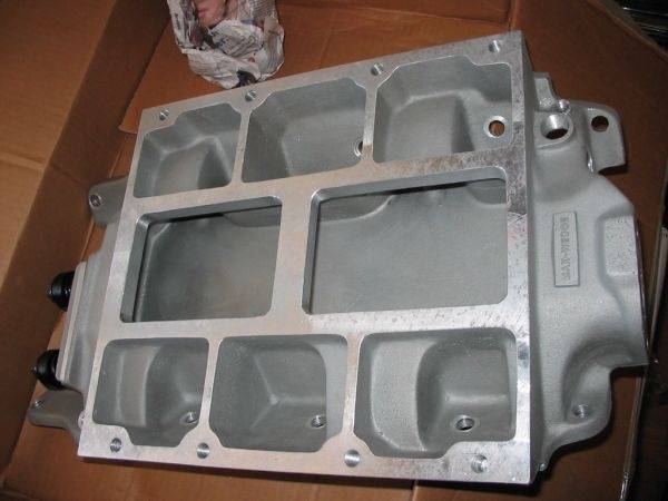

Aussie Max Wedge intake manifold and a 8-71 blower....
