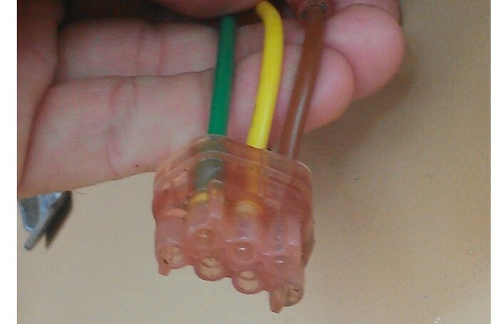

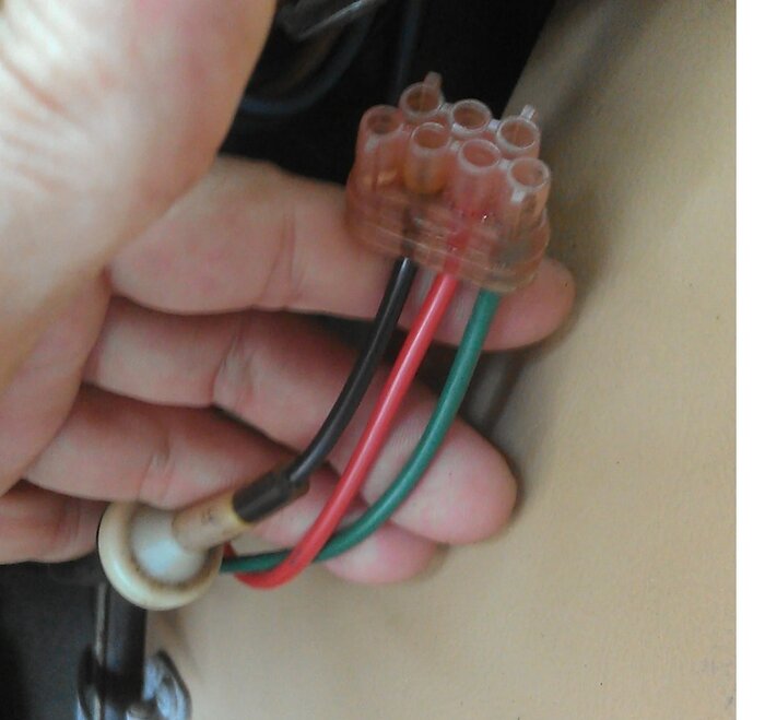

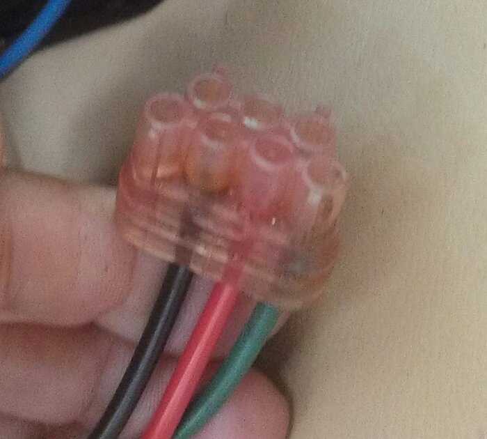

Hi everyone. I finally found a few pictures of the part I need to get my air to come out of where I want it to instead of just the defroster and bottom of my dash. Can anyone give me a part number or does anyone have one of these they would be willing to part with?

Basically unobtainable, have a bad tendency to disintegrate over time. The popular and quick repair is using pieces of tubing with the same ID as the factory tubings OD to reconnect them.

Just use vacume tubing from any auto parts store, I fixed mine that way back in 2014 and its still working fine
