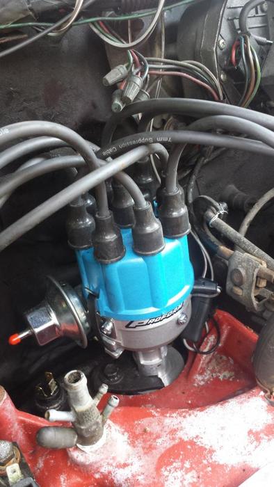

8v-of-fury
May 7, 2014
433
39
Orillia, Ontario
MY wires do seem to be crossed a bit though! I don't know if they still look like this however as this was DURING the ELB/ESA delete/swap.
