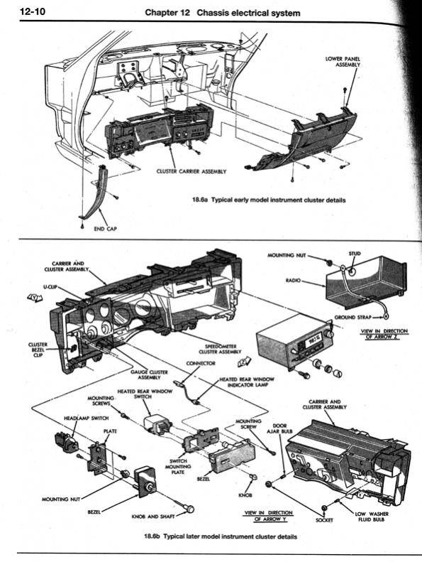

A couple of suggestions.
Make sure the dash pad is off.
You may have to loosen the lock screw on the gearshift pointer.
Also.. There are u clips on the top and sides.
And you may have to lower the steering column.
If I can figure out how to scan and post my diagram I will.
Hope that helps.

This is the best I have
