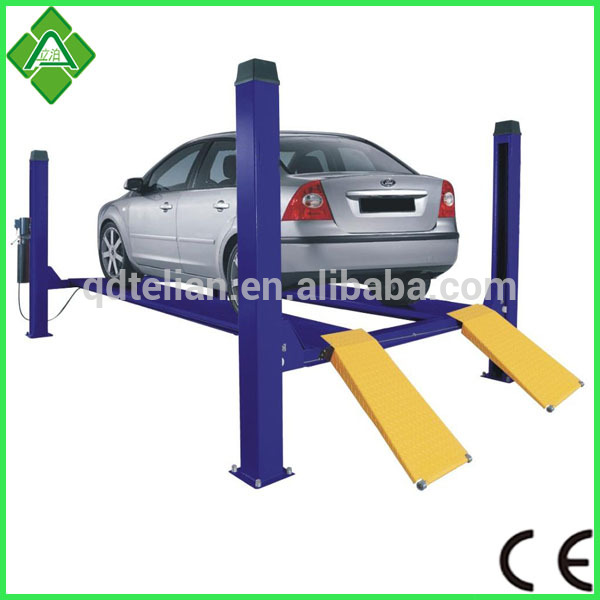

One thing to think about, is there are lifts that allows wheels to be free (great for suspension and brake work), and those that lift by the wheels (great for vehicle maintaince and other work on the car).
Most repair shops I see nowadays, have both kinds of lifts. Those that lift by wheels and those that lift by frame.
My brother likes the kind that you can put a car on and lift up (ie: an electric drive-on lift). Then you can drive another car underneath it, for storage. These work great for a lot of repairs – but not sure it is best for a repair shop who uses them all of the time.
I think this kind might be good for you:
Or something like this.

Depending on the situation, either lift is necessary. If you are working on suspension, the 4 post drive on lift is not going to be useful, so you need a lift that uses the frame. If you want to work on transmission, exhaust system, then the frame lift gets in the way, and the 4 post drive on is needed.

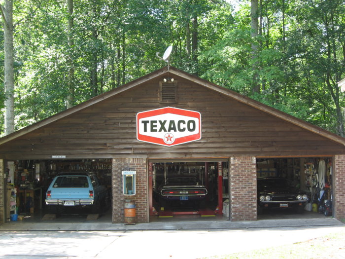

My friend just put one of those in his 3 bay garage,To park more cars in his place,He already had a 2 post lift for 20 years.

I chose a 4 post because it is essentially free standing, and I honestly like the stability of the vehicle on it, a 2 post requires the proper mounting base design in the concrete, I have actually rolled my 4 post out when I had to get a trailer in my shop. But again, what do you have for ceiling height in the garage, if you raise a 5-6 foot tall vehicle 6 feet off the floor you need head room.
