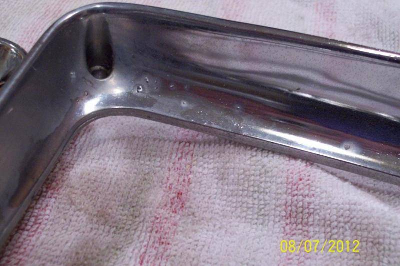

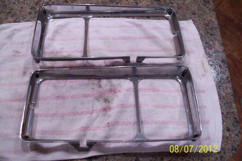

I don't know if the answer about the 80 not having the bar is correct. Mine was an 80 and it had the bar. from this pic, it looks like it fits the curved marker.
