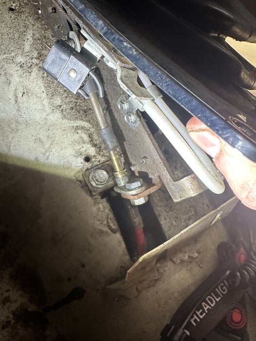

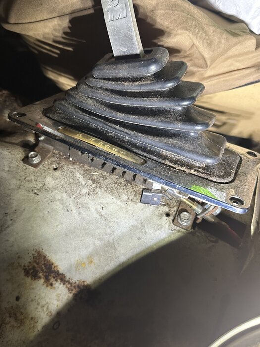

Hello y’all, was having shifting issues after I had connected my B&M shifter, found the issue and had fixed it before anyone had responded and will be sharing the info in case some one has the same problems.
The problem I was having was when putting my shifter into park, and manually putting the transmission into park after connecting the cable I would go through the gears and back into park, it would keep getting stuck in 1st and wouldn’t go back into park.
Now I have never done anything like this before so I was getting really stumped, I was watching the wire when shifting and noticed a bolt under my shifter loose and catching the underbody causing the wire inside to slip, attached the bolt and nut into the bracket on the shifter and it had fixed the shifting issues.
