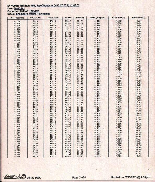

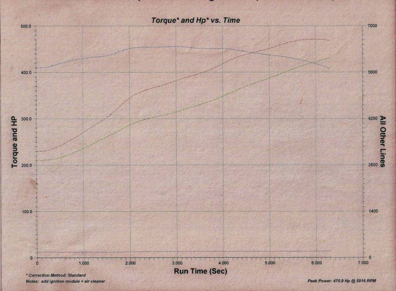

So how much torque can a 340 make with pump gas 9.7 to 1 and a nice engineered package??
455TQ at 4300rpm. It made 450+TQ from 4000-5000rpm and 410+TQ from 3-6000rpm! Now for the Top End Power
470HP at 5800rpm and it carried 470HP from 5800-6000rpm, thats where we stopped the pulls.
Now this is not a stroker, its a .040" over 340.
And its a total street sleeper. Idle smooth at 850 rpm with 15 inches of vacuum
