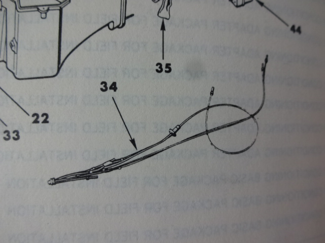

MORE help needed.
I ordered the 3503434 and since it seems I could only deal with a email or voice mail, im not sure if the order will get filled or what but a friend has a good one. ( I just looked at my bank info and it looks like I got billed from DP) so that half is done.

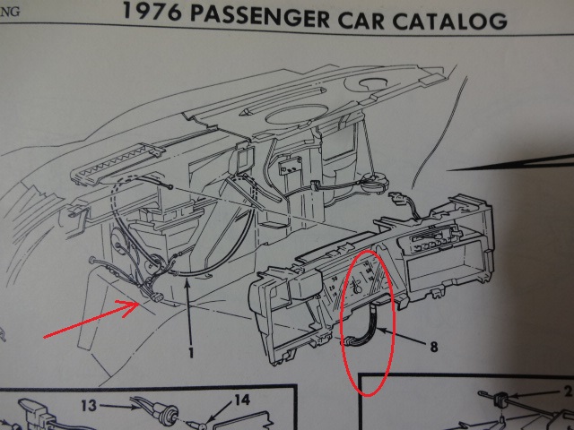

So in the pic I have the 434 in the red circle. But I also need the harness the arrow goes to and I cant find the PN.
The ac section shows the pn 3503938 and I think arizona parts has a few but the pic dont show the plug. (second pic).
The pic looks like a round plug, so again im confused.
This car was bought new and gutted for racing and im playing hell getting it back to how it should be. So its not had these parts or heater/ac box in it in maybe 42 or so yyears.
XfbodyX
Sep 9, 2015
1,713
489
Central US
what is the part # for item 34????????????????????????
34 is 3503938
If it looks like the harness I have the red arrow to in the first pick that the vac, extension connects to, thats it.
My car is a later 76, you list the 3503938 (34) on you parts list as 77 up.

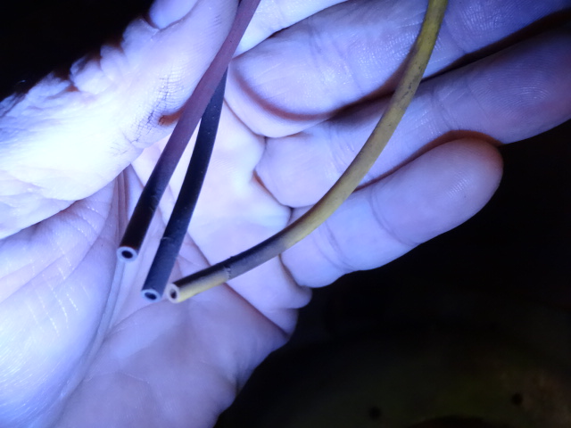

Maybe this? The remnants of whats left of my lines going to the vac cans are multi colored,(blue to one, yellow to another) not saying a replacement would.
3503938 A/C VACUUM HOSE & CONNECTOR 1977-79 H,N,F,G 5 26.40
Thanks.

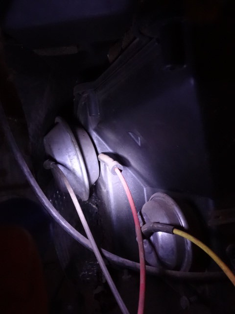

Here is some of the vac harness I need, where they go into the vac cans and the blank ends that would go into the plug fixture, that im missing.
volare 1977
Jun 12, 2014
1,933
310
maryland
I don`t have a 76 book to verify. I`m sure marty can look. That`s looks like the only other under dash hose harness part number listed that I seen in the 77 book.

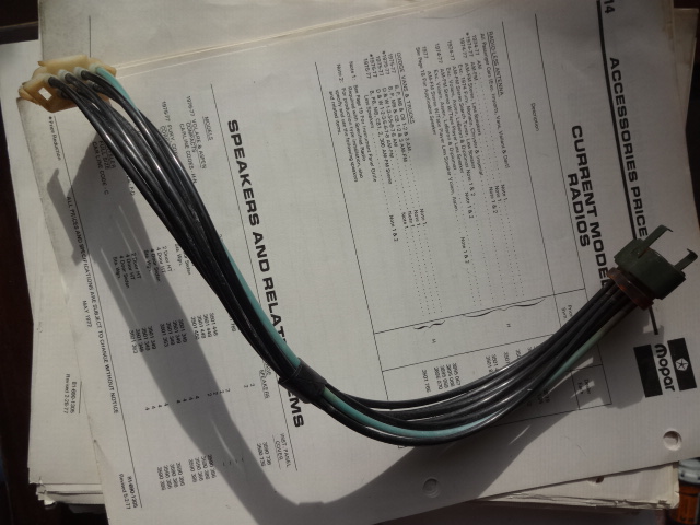

1,494
I have found it so much faster just to get a foot (or less) of the same ID rubber hose (as OD of plastic vacuum lines) and just make your own “connector” (if you want to call it that). The short vacuum hose extension (mentioned above) isn’t really needed per se. When cars came down the assembly line, the harness is already attached to the evaporator (or heater) case, which is installed in car first. The dash is assembled and placed in car as an assembly and the vacuum extension is attached to the evaporator case harness when dash is installed (so the extension is a time saving device on assembly line, only).
The ‘84 to ’90 S-body (minivan) uses a similar vacuum hose extension (used for the same purpose). The green connector material used on them is different and not subject to crumbling like FMJ bodies do. Note: the '91-95 S-body might be the same, but part number is different.
If you insist on having a “disconnectable” connector, what I do is find and take an S-body extension (part # 3847622) and plug-in both ends together. I then take that loop and cut it in half. Then I splice both ends using correct size vacuum hose as mentioned above.
The above mentioned hose part number (3847622) has been discontinued – but if you can find a new one, the retail price is $30.10 (US).

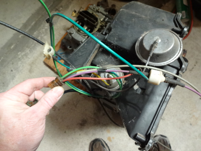

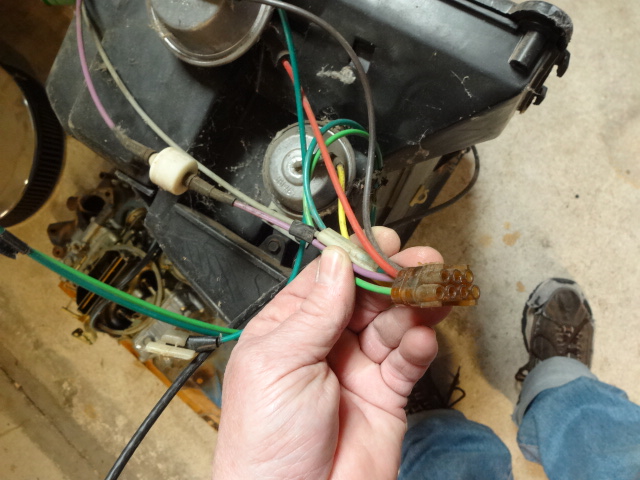

The biggest problem in my life is myself, I need to take a notebook and sort and organize parts. I spied a ac heater box behind a work bench I built five years ago and had to use the front end loader to get to it. Here is the second section im needing, I could use this but id prefer a nos part.
Does it look like this part in this illustration? PN 3503938
