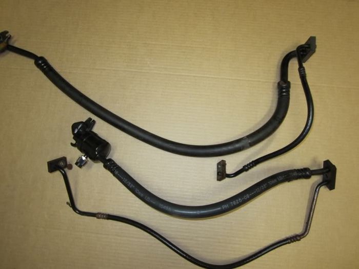

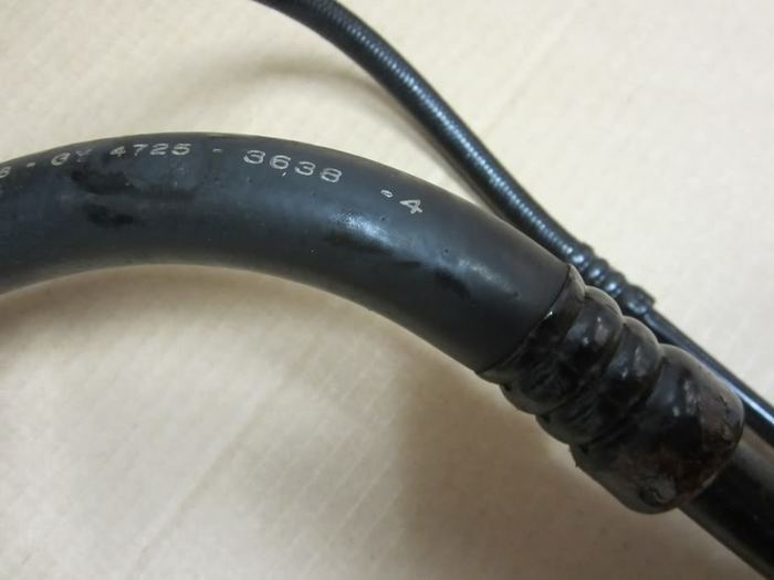

Well I had a good experience with Kelly at Estes Automotive in Birmingham Alabama. Two Saturdays ago I was cruising around in my Dakota with cold A/C blowing. I had a very enjoyable time. Sunday I pulled her out for another drive and the compressor would not turn on. I found a big mess where one of the hoses blew out.
http://autoachoserepair.com/
kelly@estesauto.com
Now my options were to find an NOS hose or after market replacement. No NOS ones were to be found. I could only get one replacement hose and it was not the one I needed. So I started the google search. A/C hose repair brought up two websites. That night I took pictures of the hoses and sent them off to both companies. Kelly with Estes Automotive was the first to reply with a price and the correct answer that my hoses could be repaired.
I sent them out Wednesday and they got them on Friday.
246

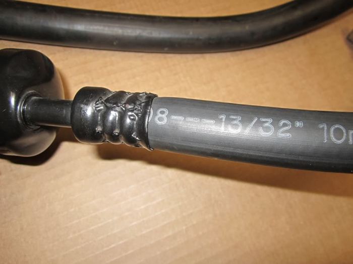

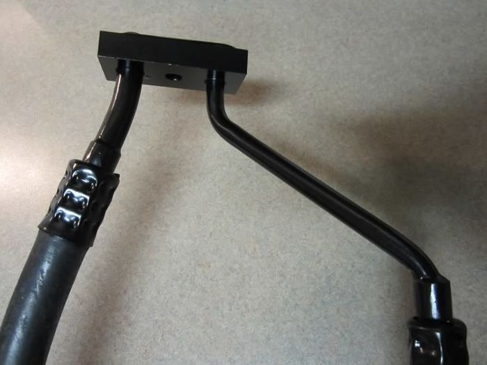

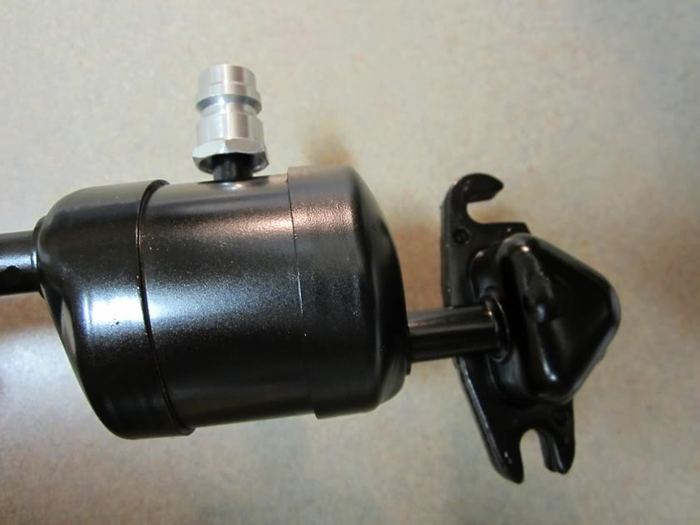

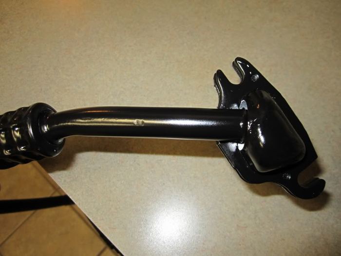

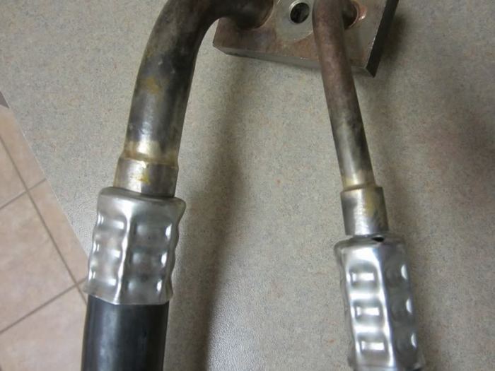

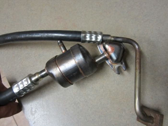

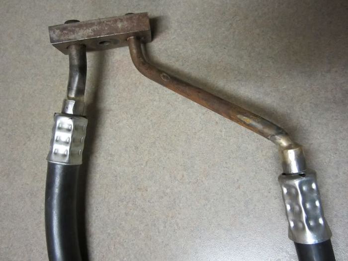

Well after stripping the paint off of them this morning this is how they look. I cleaned the rust off of them tonight and they are ready for paint tomorrow morning.

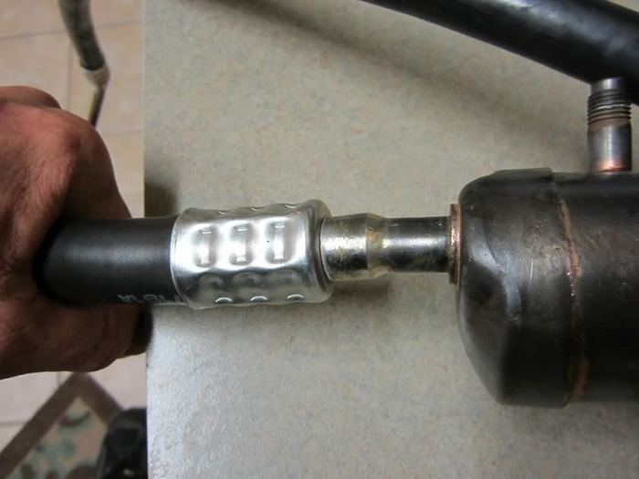

This is how they make the repairs.
BRAZE-ON FITTING REPAIR PROCEDURE
Verify Fitting Orientation (Fitting Clock Position) Before Starting.
Cut Tube
Clean & Braze
Use Gentle Heat For Aluminum Brazing. Bring Temperature Up Slowly and Evenly. Base Alloys Have a Melting Temperture of About 1250°F. The AFC-1000 Melts At About 1000 °F. It’s All About Controlling Your Heat.​
Cut Hose Clean and Square.
Install Ferrule & Hose.

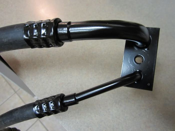

I got mine all cleaned up and painted today. Glad I stayed with the stock looking ends and just had the hoses replaced.
