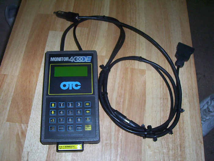

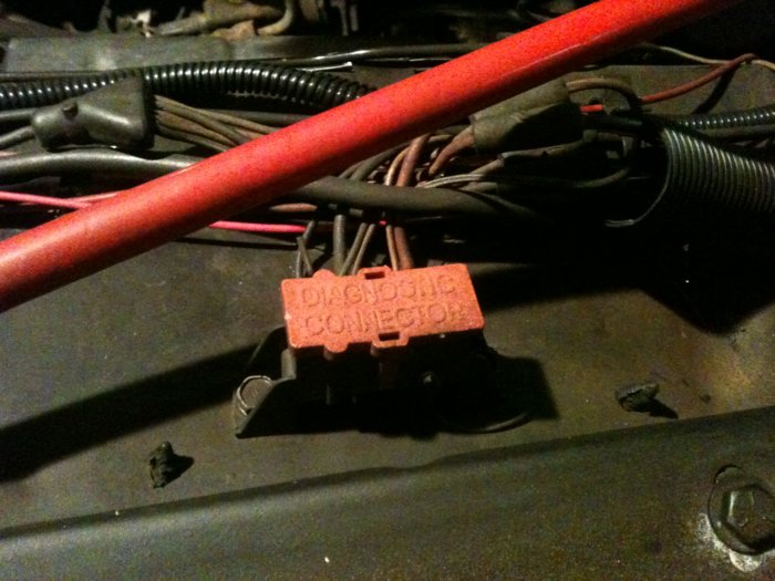

I think 87 Ks had the logic module in the passenger kick panel like my turbo Omni. Not sure where they hid the OBD connector in 87 but 91 it was a square looking covered thing laying on an inner fender looking like this...
If you know someone with an old OTC scanner and the correct cartridge you can get some real data out of it (beyond trouble codes) unlike our old FMJ cars.
