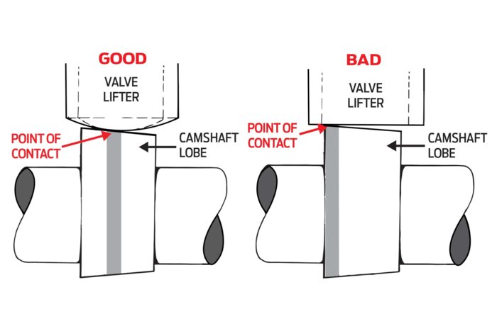

New lifters (non-roller) have a convex surface on them. A person can take a new (or good) lifter end and it will rock against long flat side. If top is flat or concave, then both camshaft and lifter is bad.
The camshaft lobes have a slight tilt to them, as shown above. That tilt along with the convex lifter end will make the lifters (and push rod) rotate when engine is rotating for minimum wear.
Roller lifters/camshafts do not have this lobe tilt to them. Using a roller lifter on a tilted cam or non-roller lifters on a roller cam will damage
both in no time.
