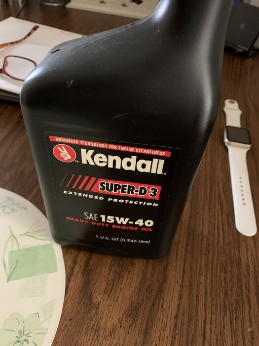

If it makes a difference I have a mild racing cam. I also have a lot of this truck oil don’t know if that would be good with it

When asking this question you will never get a consensus. The Factory Service Manual most likely recommends 10W-30. I don't have one for any years Cordobas were built. Doesn't sound like your engine has been heavily altered, so that's MY opinion. You are in New Jersey so you do get some cold Winters so I wouldn't go heavier. I'd go with 10W-30 and a zinc additive or high zinc oil for insurance. I wouldn't overthink it anymore than that.
