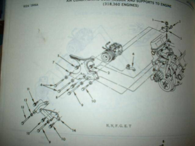

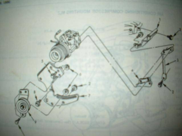

I recently obtained pretty a bunch of brackets for fitting a factory rotary compressor to a late F or M/J Body with a slant six. The main bracket that fits around the water pump is a no brainer, but all the rest of the stuff I got I could use some help on where everything goes. If anyone has a rotary compressor on a slant and would be willing to take some clear close-ups I could sure use some help. PM me and I'll pass along my email address.
7,086
I don't know if this will help any but, here it is anyways. Out of a '79 parts catalog.

That helps quite a bit - I have something similar but yet a little different. I was wondering how the back of the compressor was supported and see that U-Shapped bracket with a bunch of support braces - interesting. My main bracket seems to have an extra bracket on it at the bottom - maybe for a smog pump? I have to look and see if I have an idler pulley as I'm sure I'll need one. Thanks for the picture!
