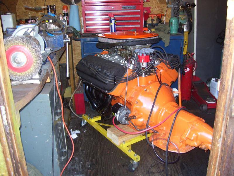

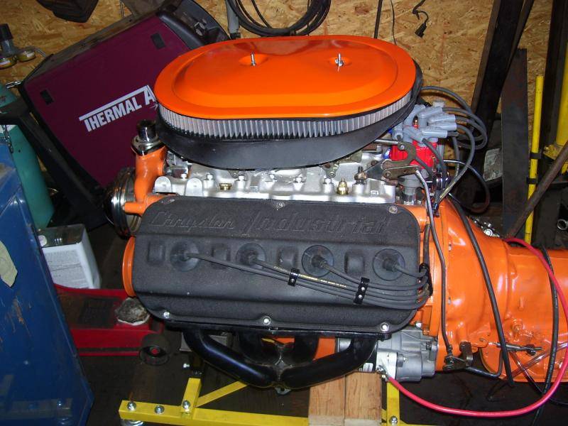

Just a cheap piece, and maybe I stepped on it a little harder than I thought. Replaced cable and out for round 2. Running pretty strong and after warming up idling nice. Just cruising around maybe 10 - 15 miles than headed home to check things out. About half a mile from home I was feeling good than it happened, A lot or rattling and lost a lot of oil pressure. Thank God I was close to home. Tore the engine down and it appears that one of the exhaust seats fell out. Have not yet taken the head off (too damn hot) but the valve is not coming up as far as it should. Did I mention that cars suck!? Think I'm going to take a break for awhile and go shoot stuff.
