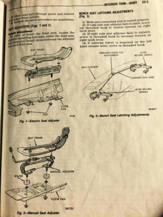

This is the info I found in my service manual for the 87 fifth avenue.
