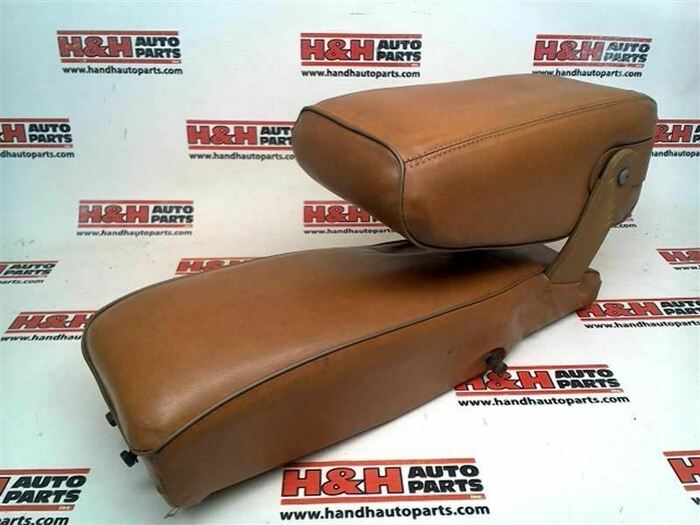

Is this it?
VOLARE 1978 Console, Front 351860 | eBay
Never seen one of these.
Greg
2,991
That's what they called a "buddy seat" (not a console though). They were available on quite a few Chrysler Corp models. My '78 Cordoba had one.
I don't think it would be the most comfortable place to sit! I always left the backrest down in the armrest position.

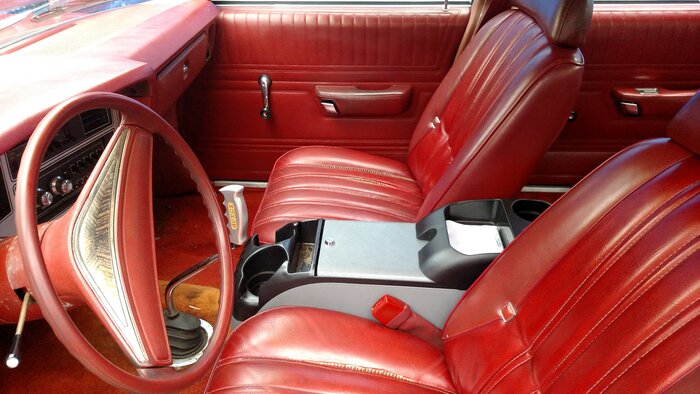

You might try contacting Gunslinger. I know they make a pistol grip shifter for an a body with a console. Would take some fabrication, but it might just work. Says in the comments that it will also work on f bodies. And a pistol grip shifter always looks bad ass.
Abody Manual Shifters Gunslinger
DCAspen
Sep 27, 2011
1,456
362
ct.
Nice find,A factory A-body console shifter goes for big bucks,That looks like it will work.I had a pistol grip in my 70 340 Dart and used a 71-74 B-Body bench seat shifter

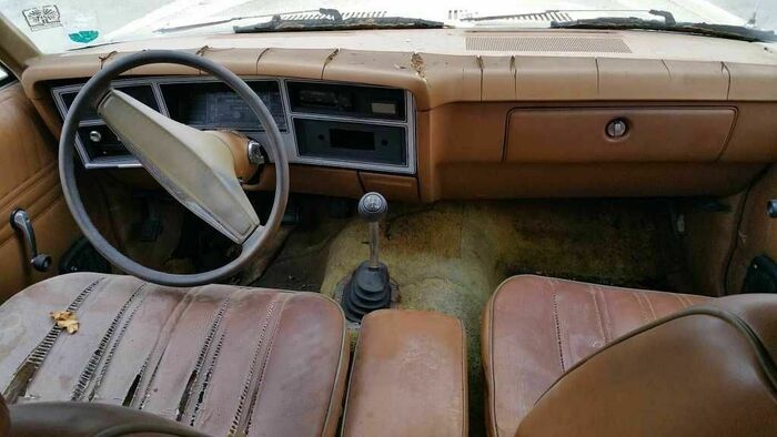

2,991
Now I see how a console can be used with a 4-speed. Was wondering since an auto shifter is centered, while a manual is offset to the left.
The console would need to be different to fit over the 4-speed floor hump, also.
