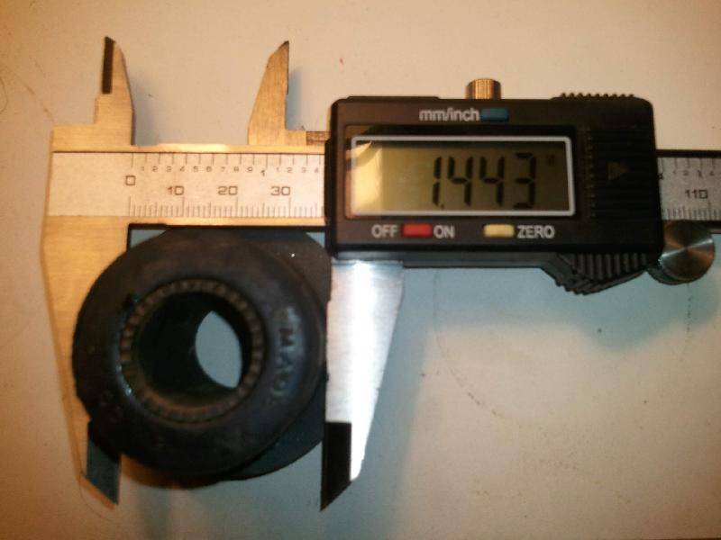

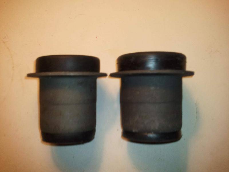

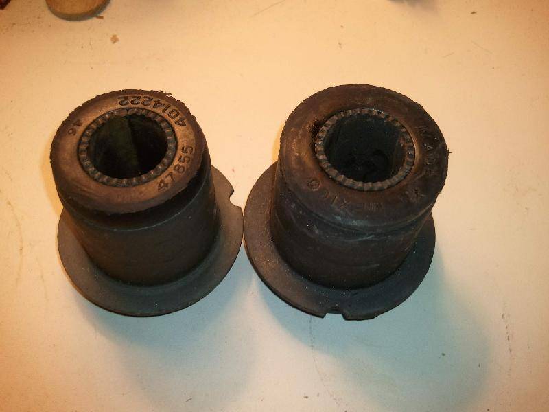

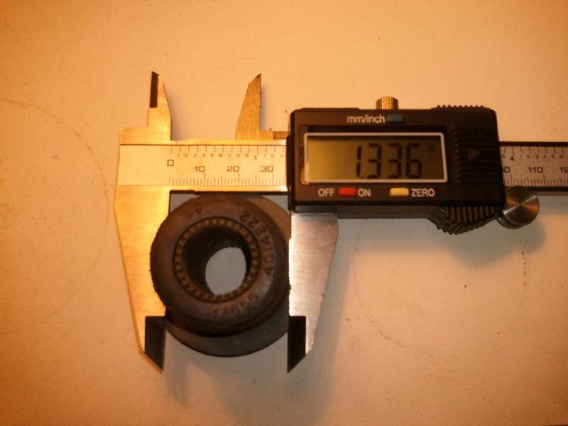

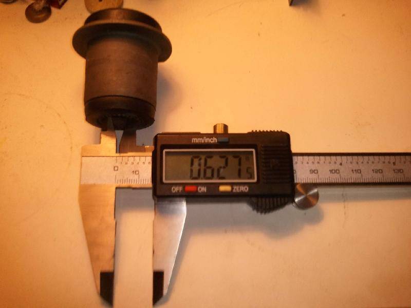

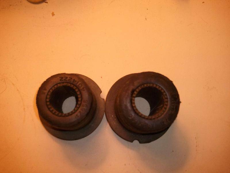

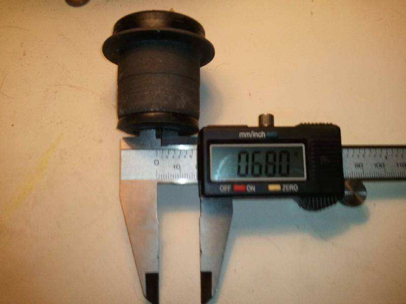

Does anyone know the dimensional differences (I know the numbers are different! LOL) between the following two upper control arm bushings?
MOOG p/n K7058
MOOG p/n K7084
APPLICATION DATA;
73-79 B body K7058
79-81 R body "
76-80 F body K7084
77-89 M body "
80-83 J body "

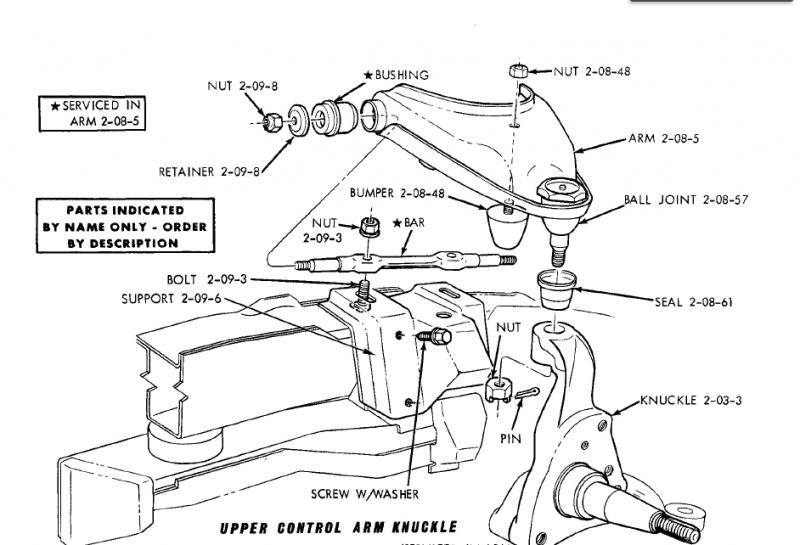

Now the reason why I ask is I am needing to be replacing the upper control arm bushings on my Bbody however I do have the whole upper control arm and bracket assemblies from/for an 82 MBody, which apparently as an assembly is a direct replacement. I would like to recondition the later assemblies now, for when I remove the old ones so I can just bolt on the already reconditioned set.
I'm just confused as to what the difference in the bushings are and MOOG does not have that info published.
Thank you!
Troy
