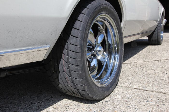

My car has a 285-40-18 on a 18x9 rim with slight rubbing on the inside towards the front when it bites.

what offset/backspacing is that wheel? Is it one of the Mustang rims?
AR Torque Thrust VN515. 18x9 with a 5" BS.

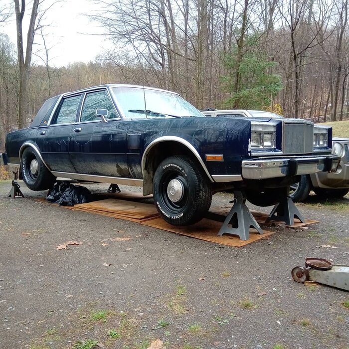

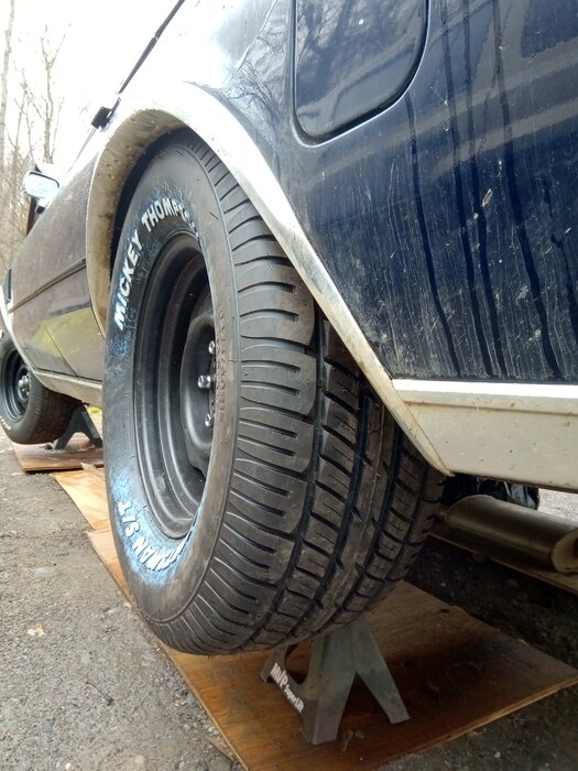

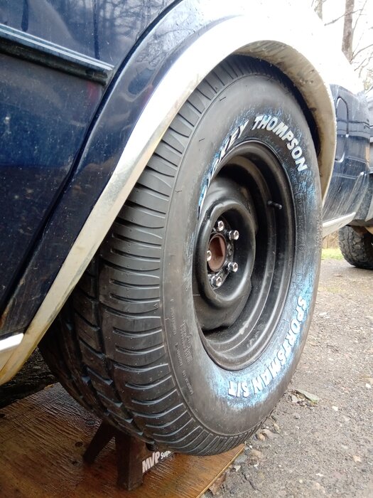

My M-body is sitting on 275/60r15 rears on the stock 15x7 wheels. can fit my hand between tire and leaf springs, tire is about 3/8" from the chrome wheel well trim at full stuffed.
