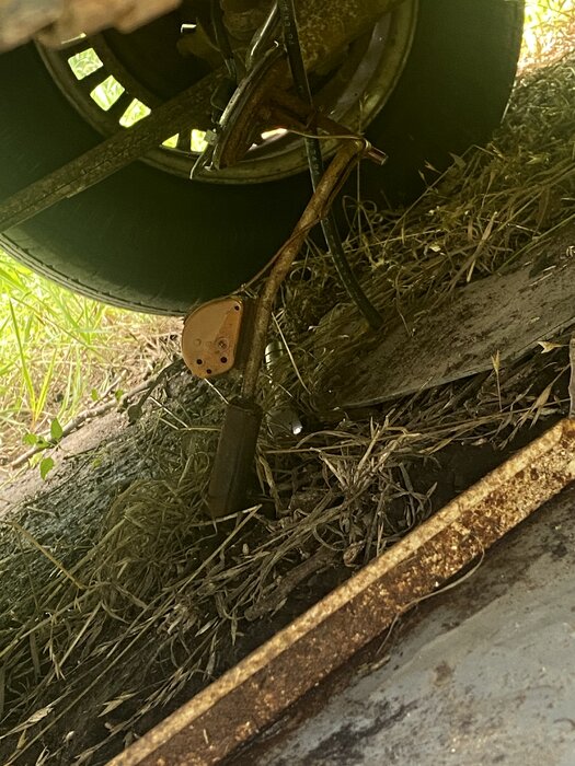

So I have rusted out fuel sending unit I don’t have the money right now to replace it, at the moment it’s gonna be Atleast a month before I get the money can it still be used (with a bit of cleaning as best I can) because this car has a mechanic fuel pump rather than the electric with the fuel sending unit ? I know the picture it’s kinda hard to see the grounds wet so it’s a bit much to get closer rn

Long as it isn't rusted through, it'll be fine. No way of telling about the sending unit. You can check it with an ohmmeter or plug it in (and ground it) and see if the gauge moves.

I tried checking the gauge I had it propped up and the gauge jump to a quarter tank then dropped again and I checked the sending unit and it’s still propped up so idk might be bad or just a poor electrical connection I have to look a little more into when the ground dries it’s been raining a lot
